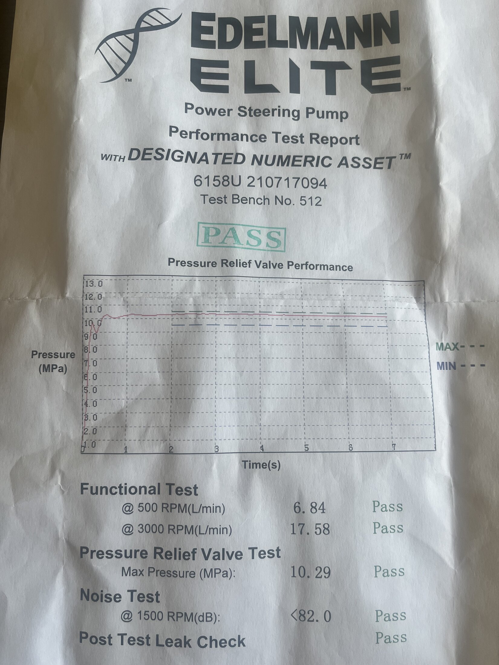

The new pump claims to have fixed many of the problems these pumps have… time will tell. It came with this test report:
Pressure relief works out to a hair under 1500 psi. 1500 seems about dead on where I’m wanting.
I know it means little to no road feel… but that’s what I need. The quick version is that my nervous system is a mess. To protect it, my muscles go into spasm when they fatigue to limit excessive motion. The problem is then compounded because the muscles in spasm put pressure on the nerves. The result is a no win cascading effect. So… easier to steer means less fatigue and less spasms = happier overall.

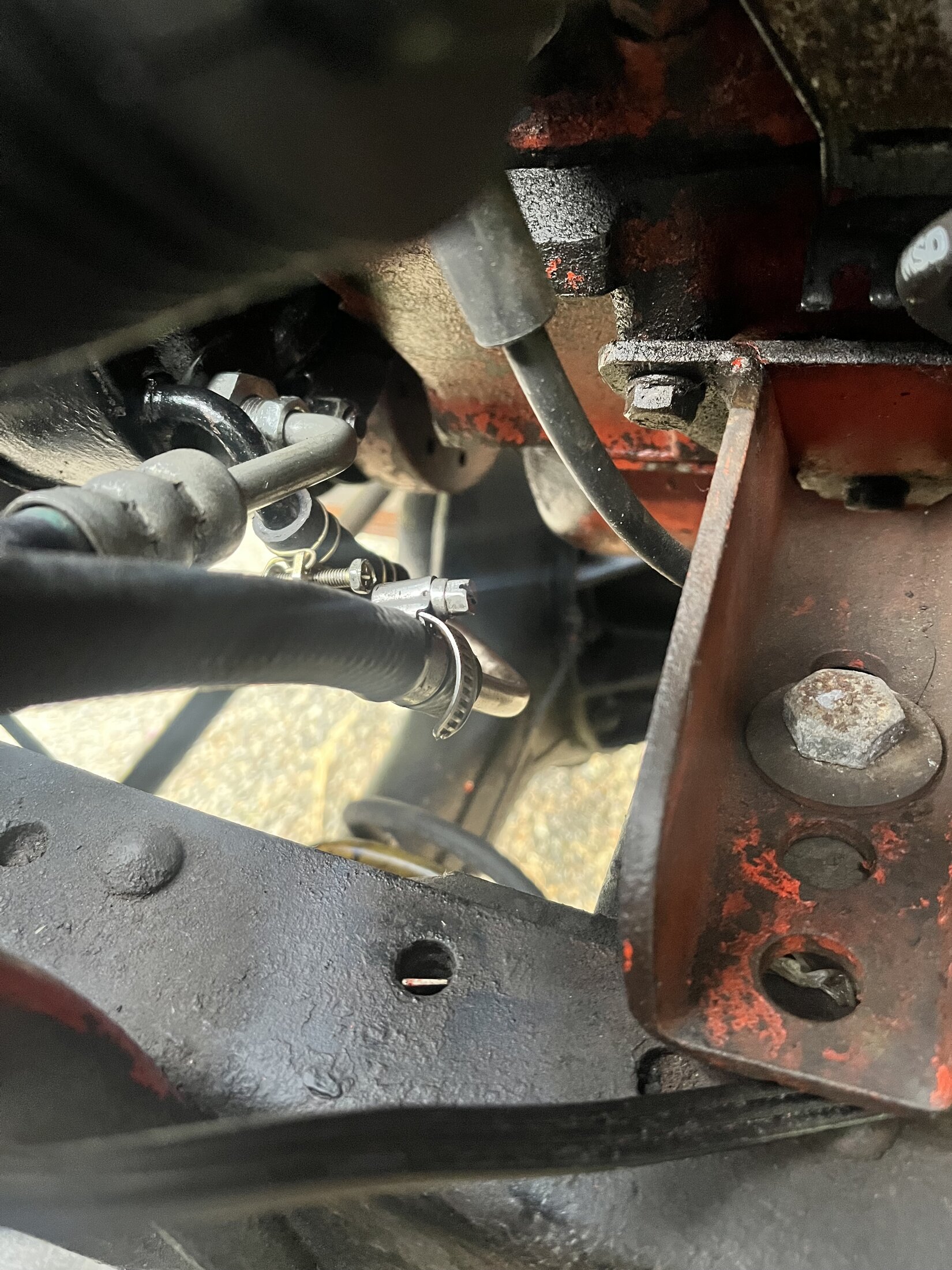

In 2021 I crossed paths with @ToyotaMatt here on Mud. We ended up discussing the steering conversion and he said he would custom fabricate a curved line to fix a leak I had. Because I was using a can for the P/S pump from an old Chevelle, the low pressure return line is pointing the wrong direction. The cans (housings) from the two other pumps wouldn’t clear the engine block.
So, I sent Matt a sketch and shortly afterwards a box showed up with this custom part, OME style hose clamps, and some other swag. I had cut up some steel high pressure line to make it work in the short term. Well replacing the pump and flushing the system made it a good time to put in the custom line Matt fabricated.
It’s a perfect fit. :D

The line is a perfect fit. I don't think I could have made a better fit if I had all the tools and equipment to build it myself. Thanks @ToyotaMatt. Excellent work, you clearly are a skilled craftsman and I'm happy to see some of your workmanship in person.
