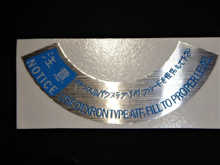

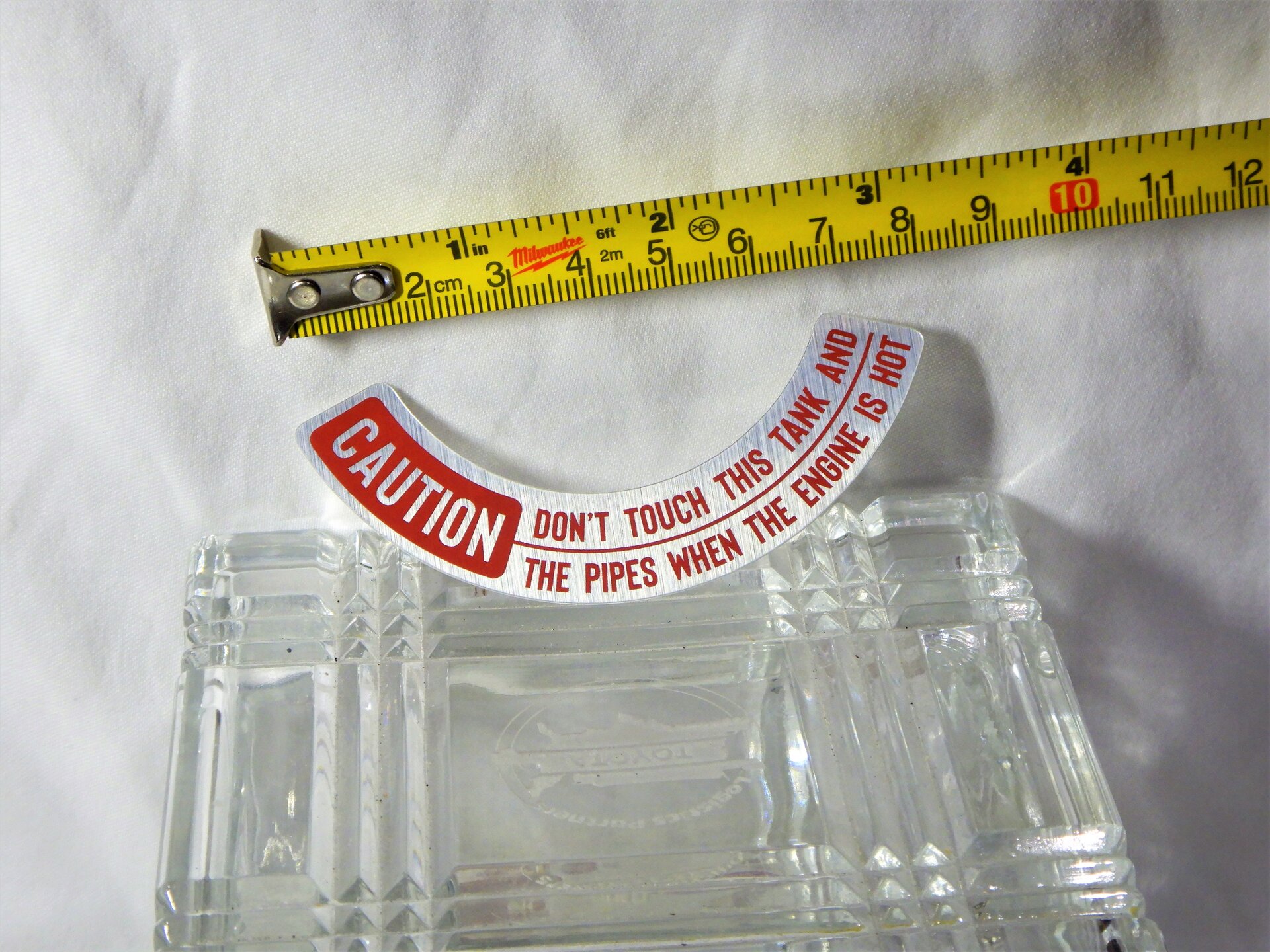

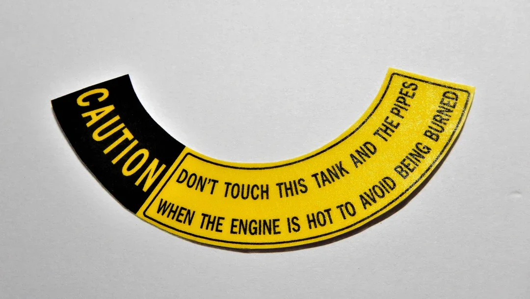

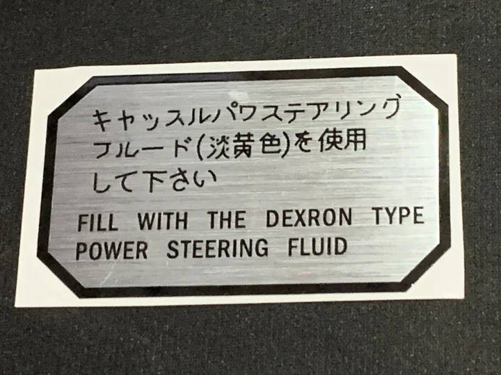

i have the MOST important 2 you will need :
LOL. Thanks. Really looking for the part numbers for the reservoir, pulley, gearbox, and any other parts required.
Great looking stickers.
