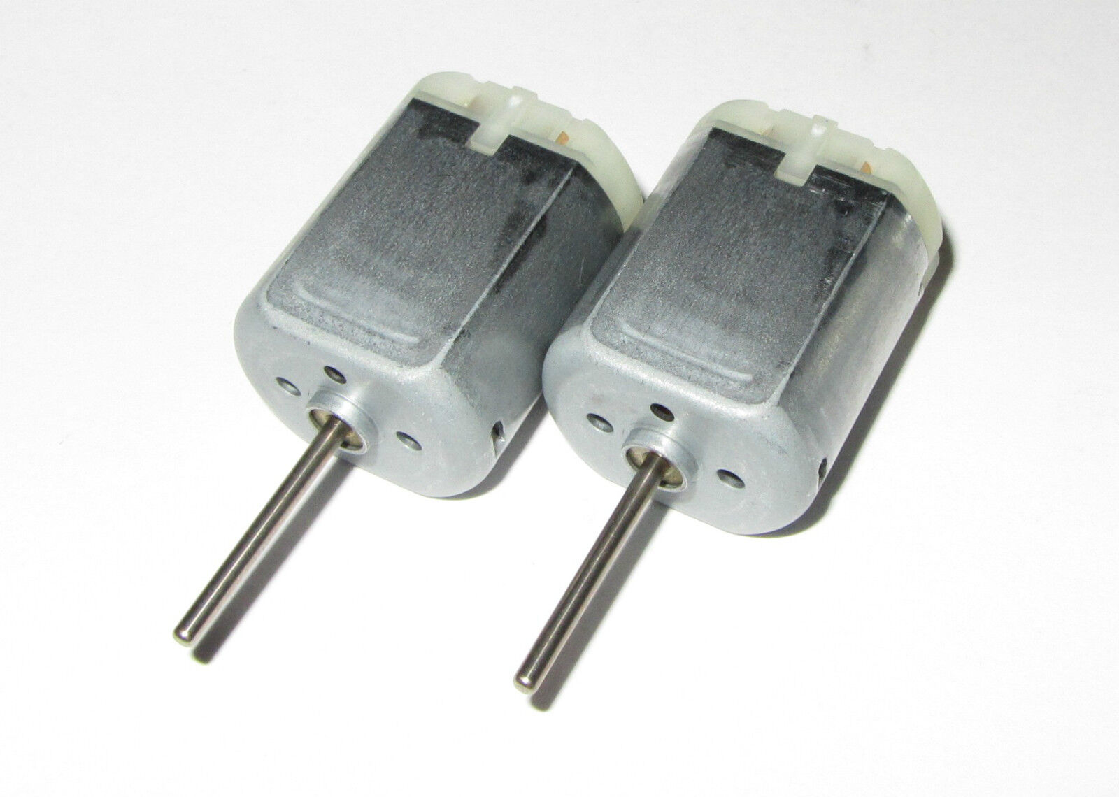

You probably need to replace the motor. This is what I used.
2 pack 20mm LONG SHAFT Mabuchi Car Door Lock Actuator Motor, Repair Lexus Toyota
Thanks and ordered.
