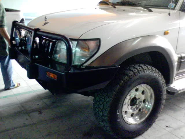

here is a pic of a LC90 with 3.4 V6 with 305/70R16 dick cepek f/c tires on american racing 16x8 rims. so far the owner did not have any problems with the set-up. suspension is OME shocks and springs with additional 10mm spacers in the front. sorry for the picture quality used a phone cam.
Nice setup. Looks great. When you mentioned spacers, do you mean wheel spacers or Coil spacers?
I think he meant coil spacers, I don't know about the problems of having 285x75R16 but I've seen and know people that run that tire size in many 90s here in Venezuela and I never heard of it.
