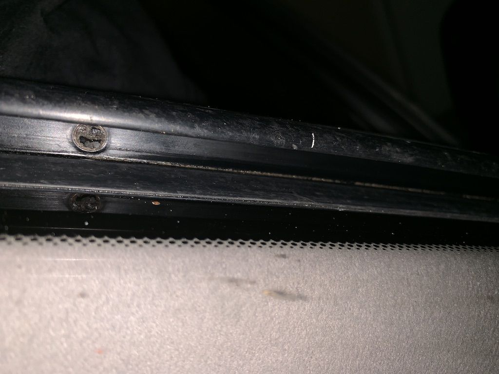

Super easy. Just did it. Took me all of 30 minutes, including cleaning and replacing the side pieces. Mine did not have any silicon used to seal the upper piece, so I reinstalled without it. Will test tomorrow, but I'm thinking of just removing and adding the silicon layer. I also unfortunately learned that my windshield has screws instead of rivets, thanks PO.

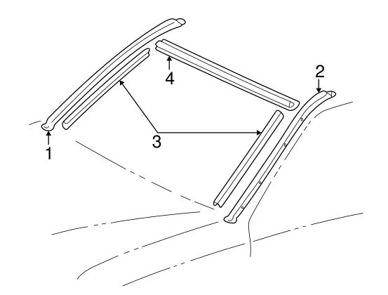

Question for those of you with more windshield experience than me....How in the hell do I install the side trim pieces that cover the rivets? Number 3 below:

Put the L-shaped piece towards the top and slide in the bottom. The L should be facing inwards to the windshield, at least thats how mine came out.

Yeah, I had the same problem. Had some water pooling in my drivers side floor, the PO had a bad window install done and they left the rivets out and only put 2 screws per side back in. My glass guy did an excellent job, but my moldings are just old and slightly deformed so I'm going back with new upper reveal molding and side rivets cover molding. Glad it was an easy job for you. Sucks though that it seems you have to always come behind the "professionals" and fix their screw ups. Can't wait to get this new molding in though, should finish it off nicely. Thanks for posting
