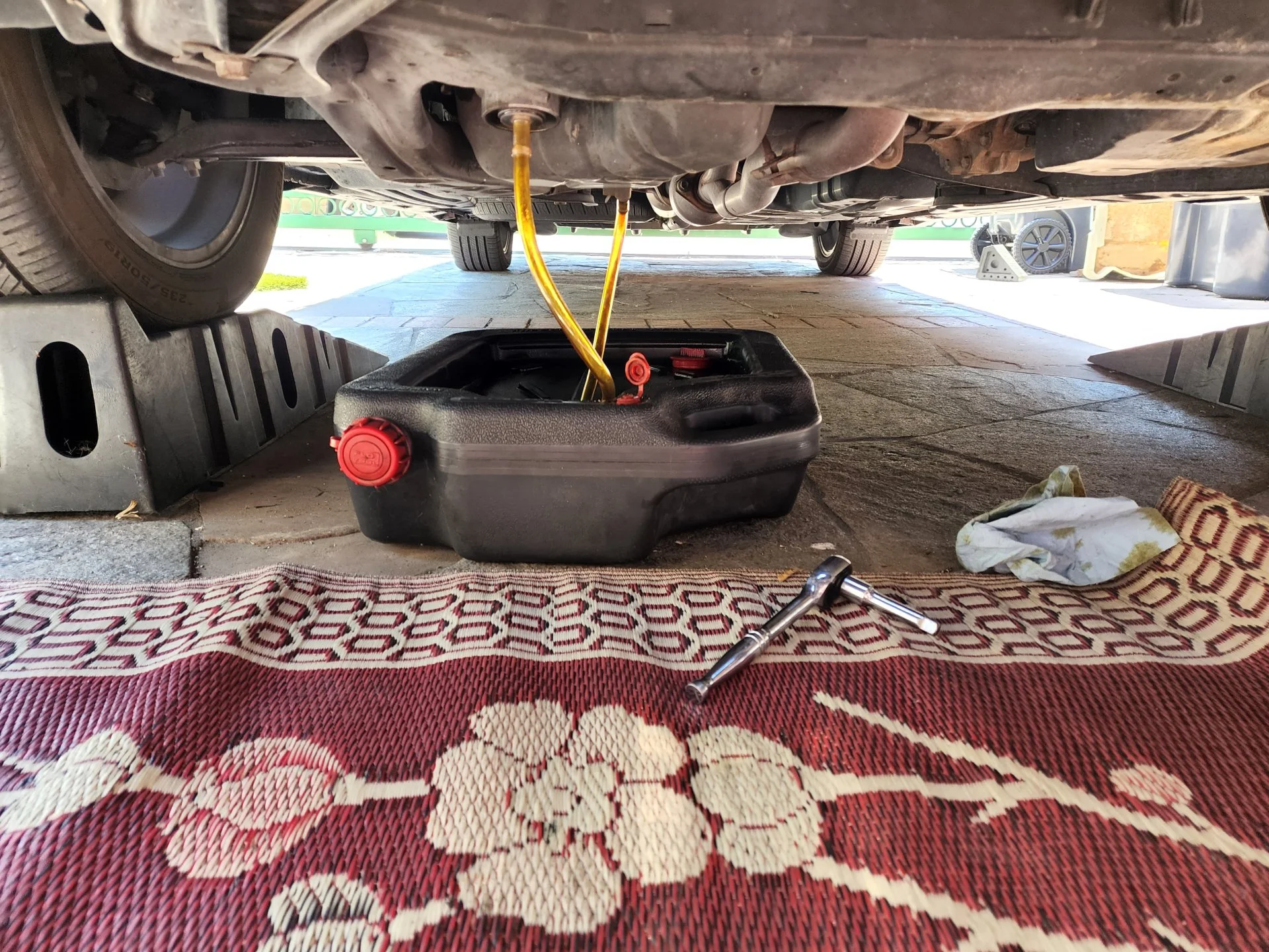

I usually attach a hose into the included tool thingmajig Toyota include with their filter and I have zero mess on the cars when doing oil changes. To remove the plastic tool, just bend 90 degrees and it pops out with the rubber gasket.
^^ That is some kind of CLEAN oil draining out!
Haha, I came back about an hour later and snapped a picture after dropping the kids off.
