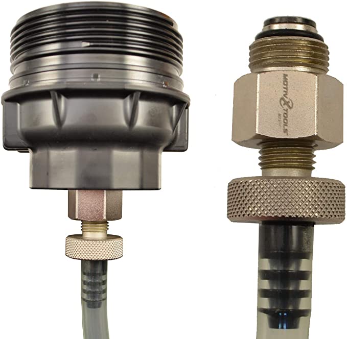

I purchased the tube thing…but I don’t see how it attaches. Is it under the cap within the cap?
Oil Filter Drain Tool for Toyota,... Amazon product ASIN B08QC9SGS5

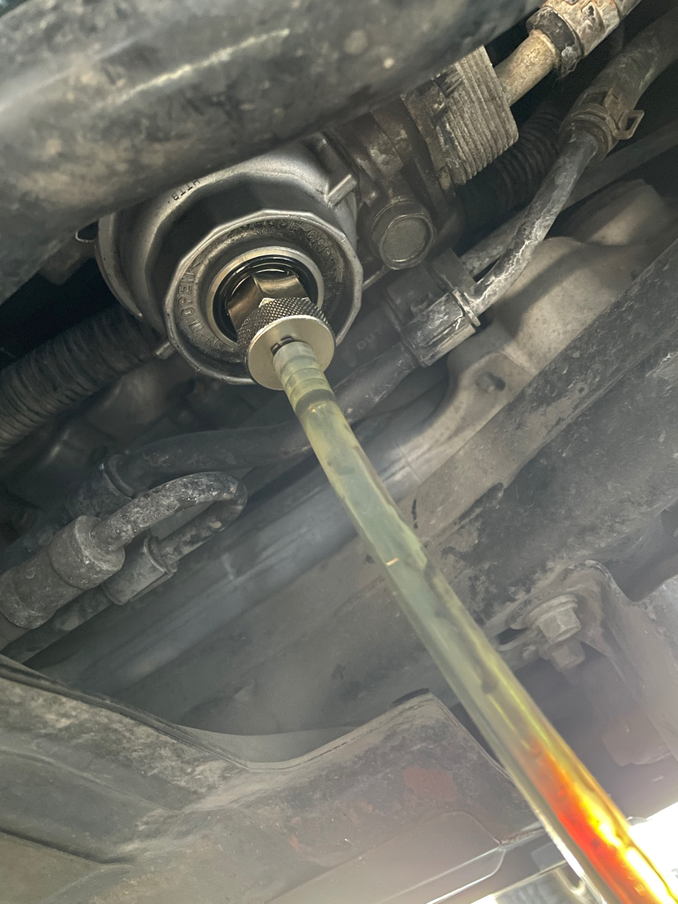

I use the Motiv tool that @turbo8 posted. It works well and is easy to use, screw into the filter housing then turn the thumbscrew in, no tools necessary. I happened to be doing an oil change today and a friend had asked for a pic of it.

A bunch of companies make these screw in drains.
Even though I never had a problem with the original plastic tool that comes with the filter, I got one of these and it's definitely easier and less chance of a mess. @highfructose are you looking for something to leave there permanently? You'd still have to remove it in order to remove the filter housing.
