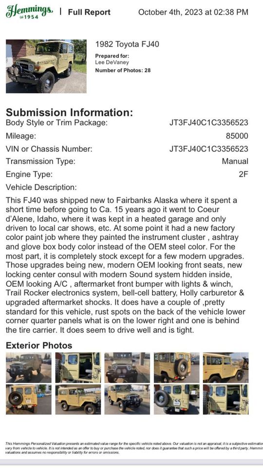

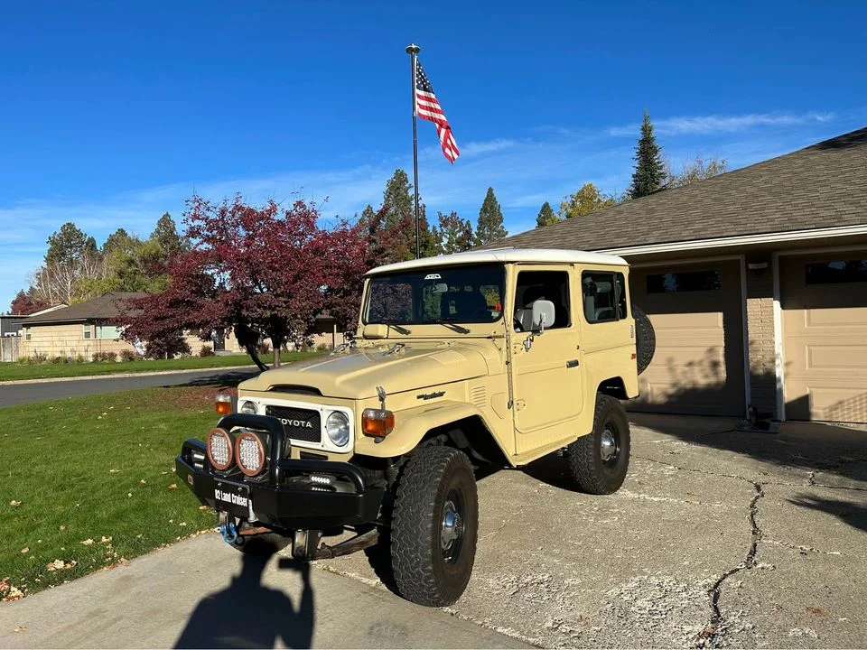

I posted a new member intro about starting to look for an FJ. This 1982 is local to me. It's a FB marketplace ad with little information other than a few pics and this Hemmings thing. Steer clear? Look but don't buy? Maybe a good deal? I need some expert advice. Looking for a driver, not a show car, will see trail use and occasional daily driver status in town.
I am not an expert.
Rust + respray (especially where the description implies a hasty job) would give me caution, because I am not skilled with welding and auto body. Others here would have no problem. You’d have to see it in person because definitions of rust severity are subjective. Nothing glaring in the pics.
I have yet to read a good thing about a non-Toyota/Aisan carb.
The seller has owned it for a year, so they may be limited in ability to give details on the work done previously.
If it’s close, go see it. Seeing cruisers in person, and if possible, driving, will start building some data that you can see and feel to rely upon as you make your decision. I generally don’t ask to test drive a vehicle I’m not ready to buy, but I would let someone drive mine if they were nice but not that serious yet.
don't buy it without looking at it in person, or have a trusted person look at it who knows 40 series.
where is it located now?
check with a local club and see if someone is willing to look at it that is close by
Looks pretty nice.
People won't like you calling it an FJ though - better stop that ;)
Maybe the guy got carried away buying a front bumper online?
The speakers are notable - are these young guy cool speakers, old guy deaf speakers, or 40 series inaudible speakers?
Has aircon and power steering? How's the engine temperature reading?

Definitely looks bubbly in the rear sill. I wouldn’t be a big fan of the aftermarket wiring harness (if that’s what that painless box is on the firewall). Also wouldn’t be thrilled with the bedliner or whatever on the interior floors. It doesn’t look too bad overall in the pics though and things like wrong color paint on gauge cluster, etc are easily changed.
Some big points for it in my mind would be the power steering and AC (especially here in Spokane).
I’d definitely look for signs of bondo over rust and things like overspray on window seals to indicate quality of the respray. If you zoom in on the pic from the rear, you can see the seal between the hardtop cap gutter and hardtop sides is painted body color, which tells me it was painted assembled.
My gut without seeing it in person is upper teens to low $20’s. If it were original seats and wiring and didn’t have the bedliner on the floors (if that’s what it is), I could see mid to upper $20’s or more because the early 80’s cruisers are more rare.

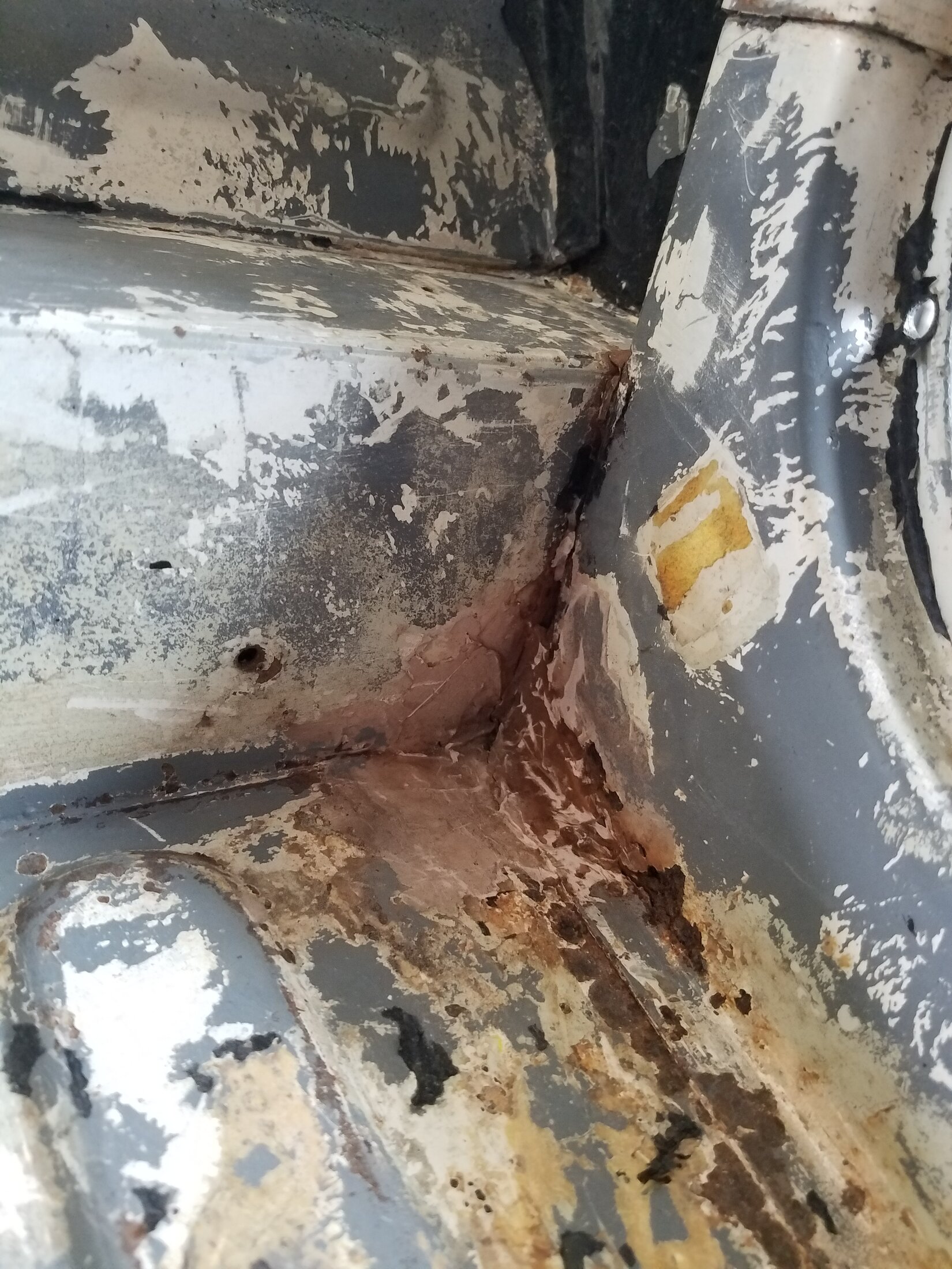

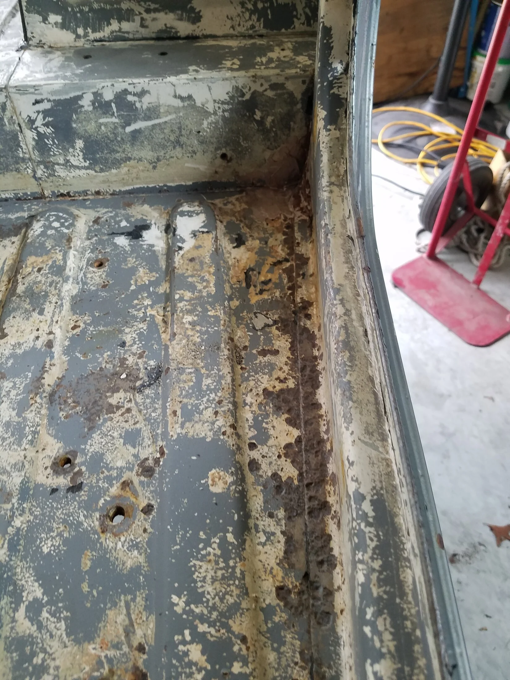

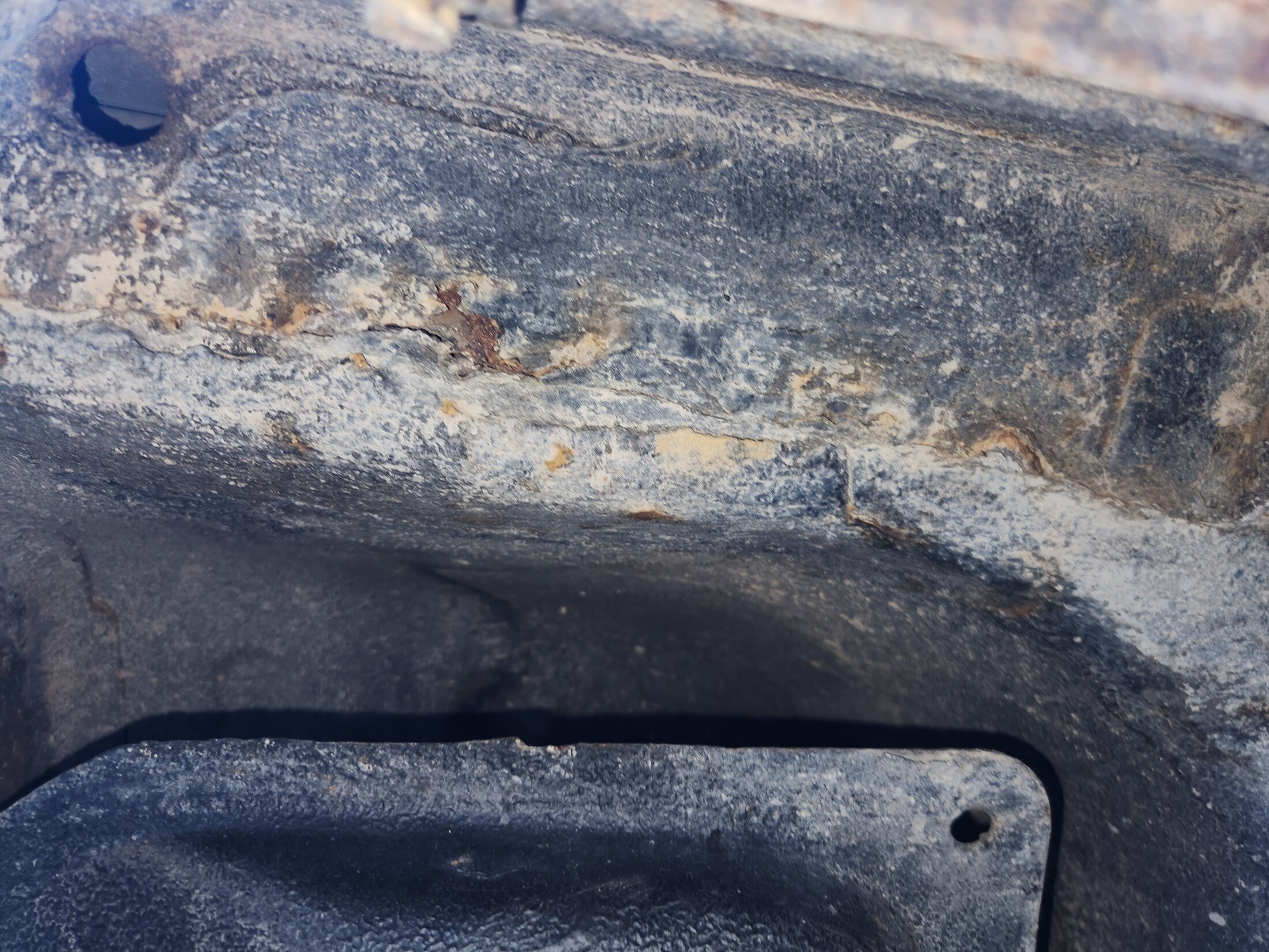

I went and looked at this 82 briefly yesterday. It presents great initially. The owner unfortunately bought it from a dealer almost 2 years back with no records/history and paid a premium. It has rust presenting below the rear doors, rhino lined inside, underneath the floors have rust and cracks. See pic. The lower sections have filler, a lot based on my fridge magnet not sticking to anything in those areas. I asked a few questions and left. He seemed disinterested while I was there but followed up with several texts wanting me to come back for a test drive. I feel like a guy who isn't interested after a first date and is trying to gently avoid a second, ugh.
