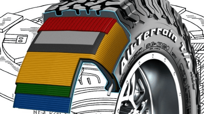

Most sidewalls are 2-3 ply. C and E refer to the colored layers below.

Most sidewalls are 2-3 ply. C and E refer to the colored layers below.View attachment 2136389

I had thought that E load tires only had stronger sidewalls but his graphic, and jLB's commentary, the point is that the entire tire is stronger and could have prevented the puncture. Obviously that's not a sure thing, it would have just been more likely to survive. I agree that krice came off rude though haha
