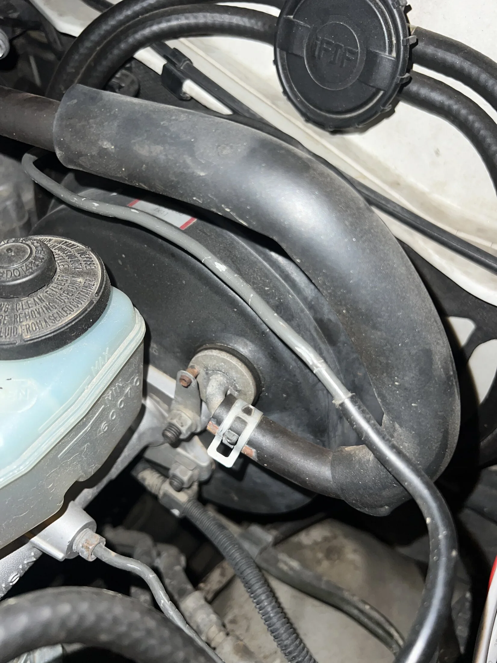

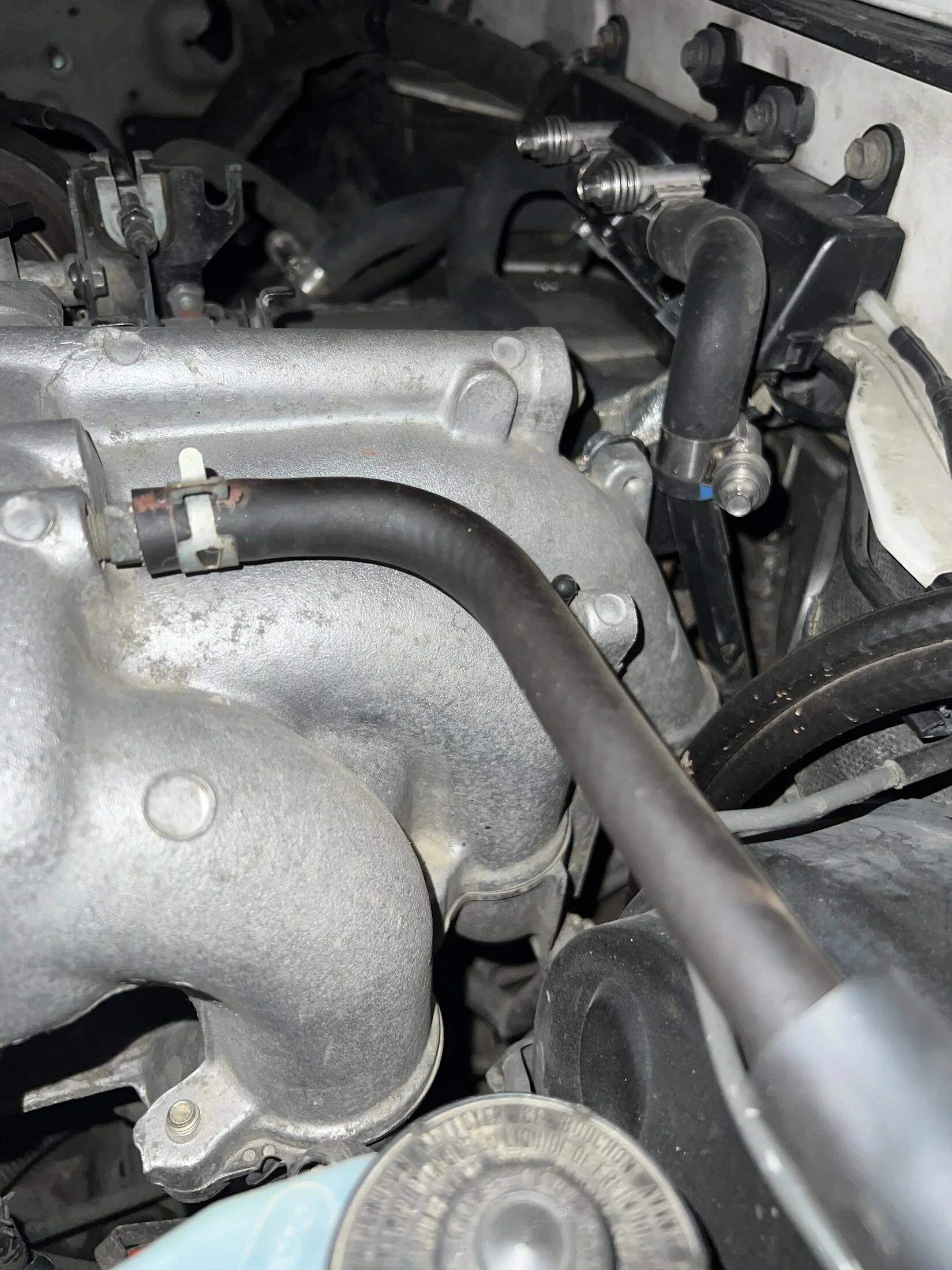

Yep, booster is gone. The pedal is hard because you have no vacuum assist. Before you jump off the ledge, check the vacuum line from the booster to the intake manifold, you may just have a bad hose.
Good call. First thing I checked. Booster line is connected, and relatively new.
I do have the old hose and check valve (that I replaced preventively while chasing idle issues) that I could swap in to eliminate hose and check valve as the problem.
I would swap in old check valve with the newer hose first and go from there. Then old hose with old valve. Worth a shot to potentially save money.

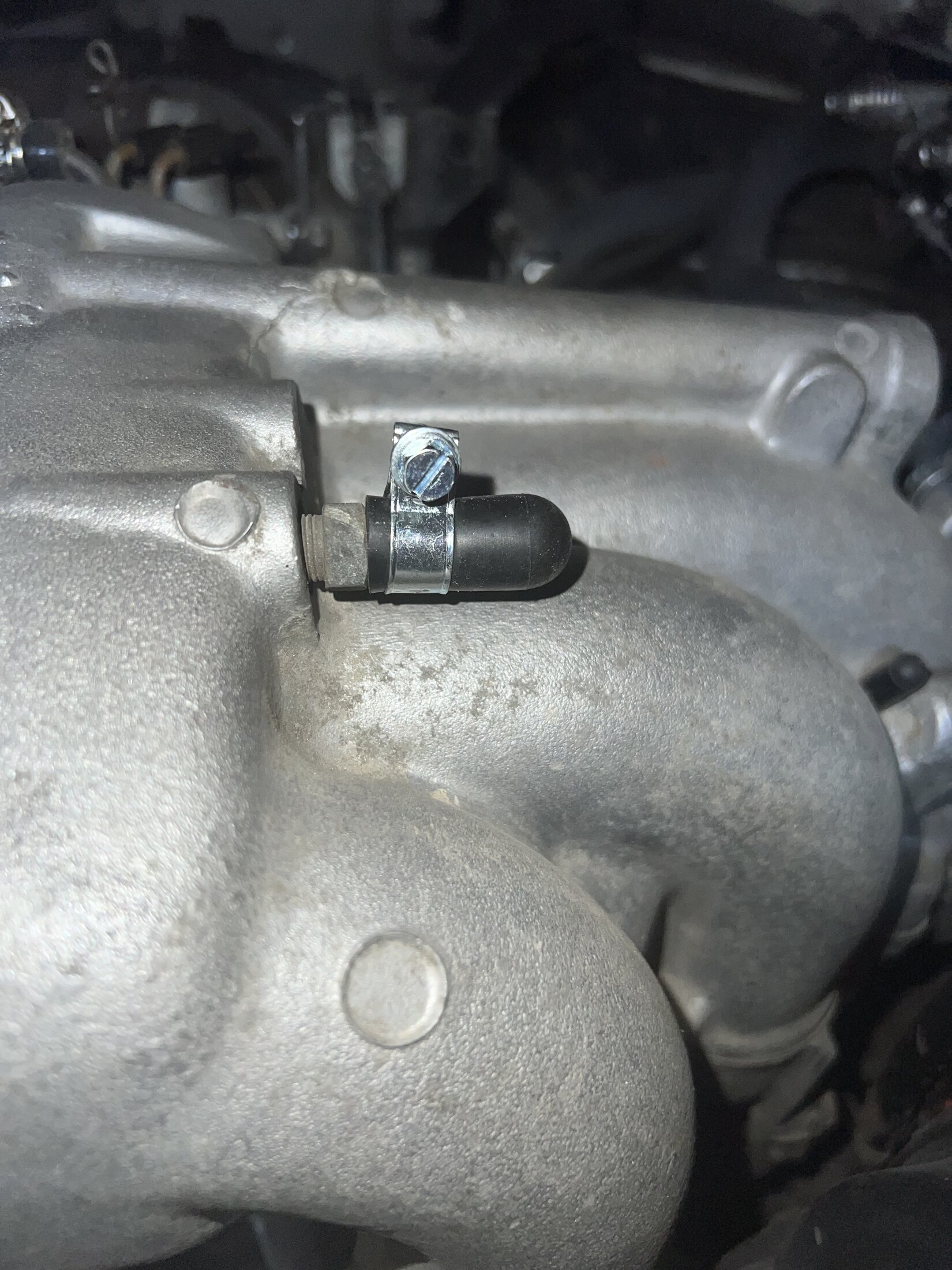

Just plug the manifold hose barb to isolate the whole booster hose assy to see if it fixes your idle issue.
Brilliant! Thank you.
Capping the manifold nipple fixes the idle issues.
Sounds like I have a vacuum leak downstream of the plenum nipple. Since the hose, check valve and grommet test good (see next post) it seems to point to a vacuum leak at the booster.

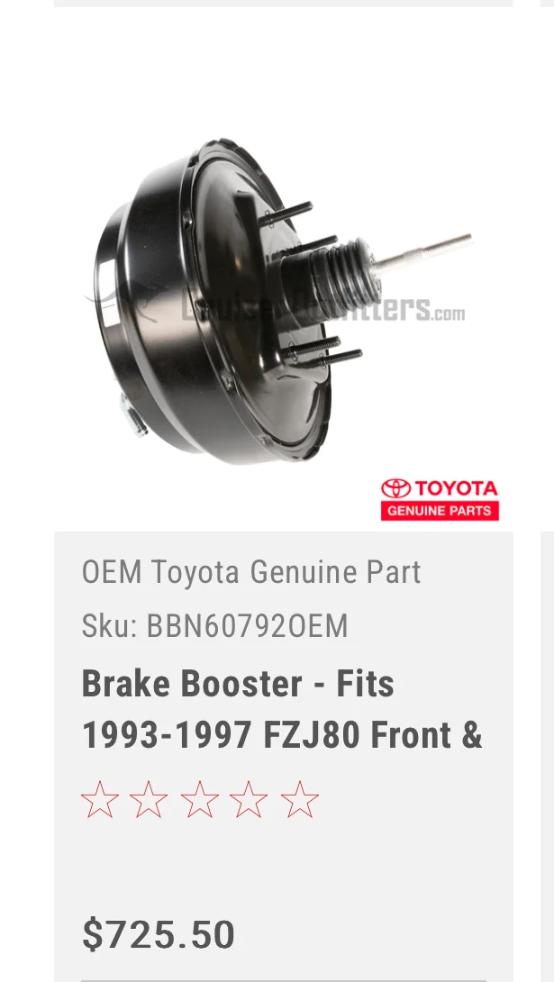

Did you buy from cruiseryard? I thought I remember @cruiseroutfit having them for around the $300 range. If it was cruiseryard list price of $449 why not go OEM for $469? Just curious I will be replacing the entire system soon calipers, lines, master and the only thing left to purchase is the the booster.
I don't have a great answer other than someone here recommended the Seiken at CruiserYard. It does come with both gaskets, which seems good. I don't want to wait around for Amayama or Partssouq, since this is my prime offroading season before snow flies. US Toyota dealers didn't have great deals, and I didn't think to check cruiser outfitters. I should be back on trail within a week if the booster arrives in a reasonable time.
Yes bought at cruiser yard. Needed asap and I think Seiken is essentially OEM.
@cruiseroutfit do you have the Fzj80 boosters in stock seiken? Msrp$? Not trying to hijack the thread just getting another purchase option out there for future readers.
The only one I found on their site that fit my '94 was genuine Toyota. If they do have the Seiken, it isn't easy to find.
I would double check with @OGBeno, but I believe Seiken is the OEM for Toyota.

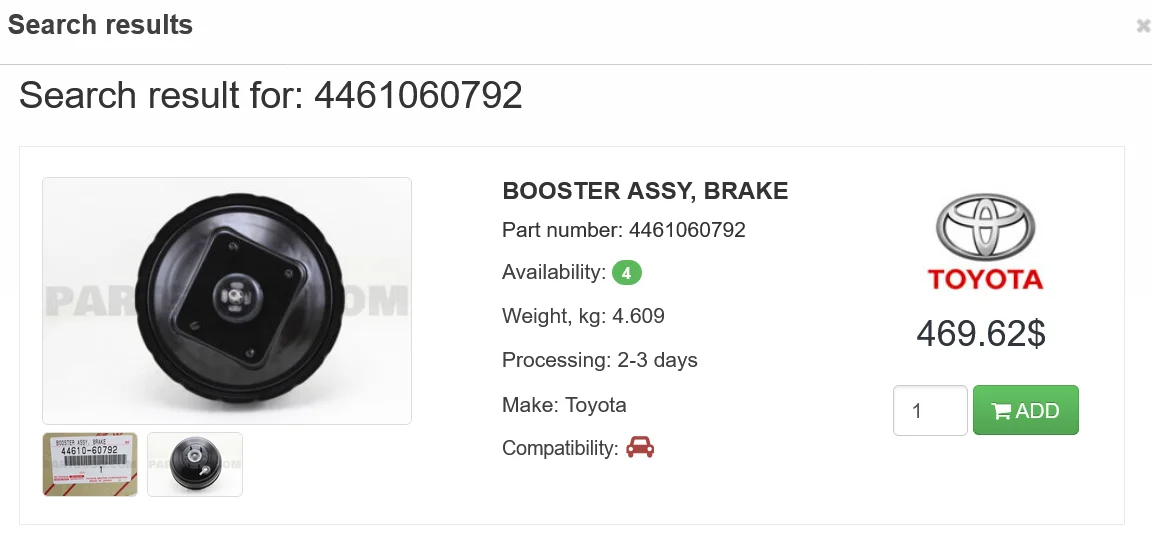

Toyota part number 44610-60792 includes the check valve and grommet. $469.62 from our friends in Dubai if you have to have the red and white box.
