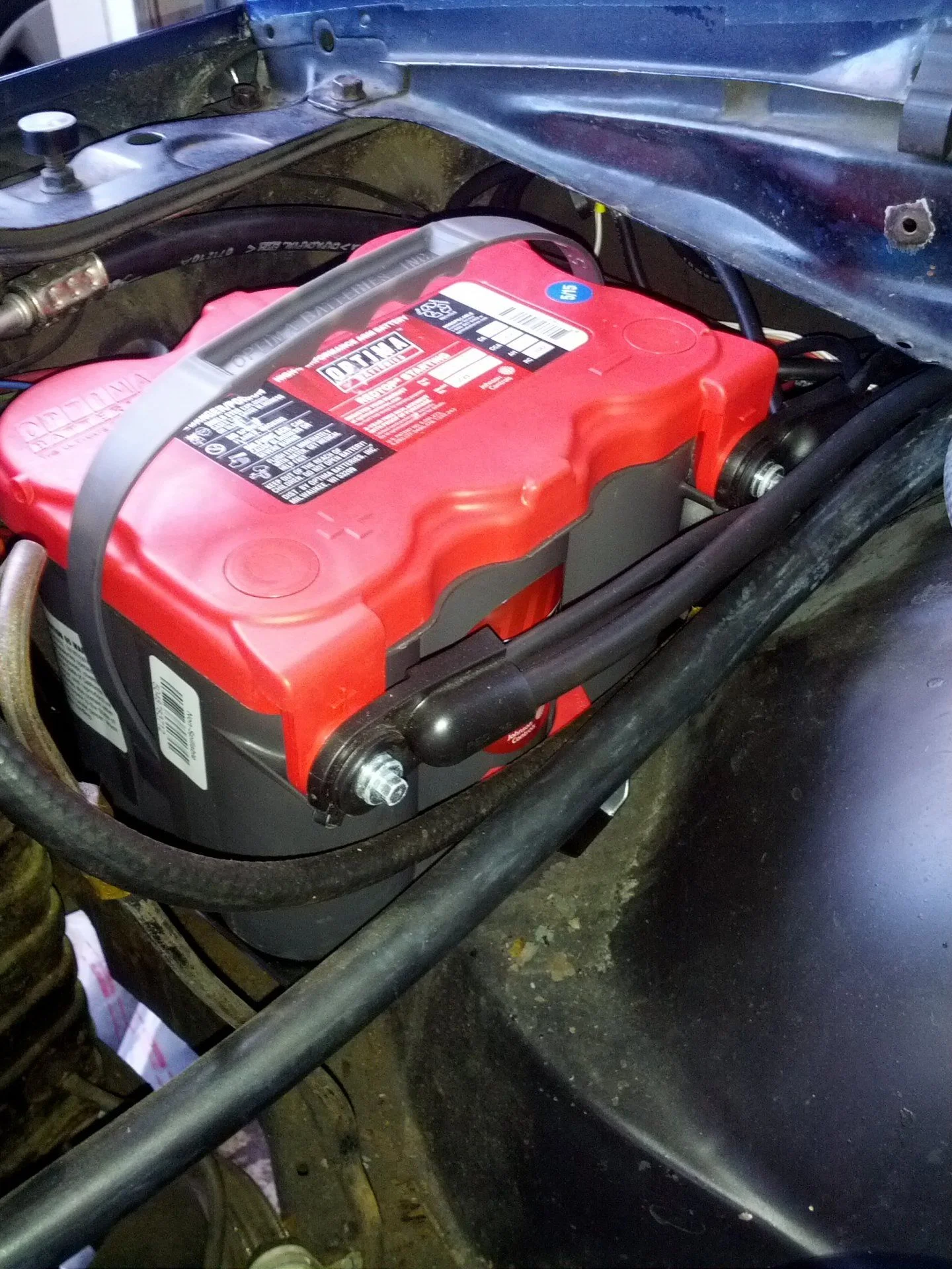

Any benefits to side mount over top mount or vice versa? I just wasn't happy with the top mount on my El Camino. I kept an eye on amazon for side mount cables that fit my needs and picked them up cheap. When my top mount died, I replaced it with a side mount.
