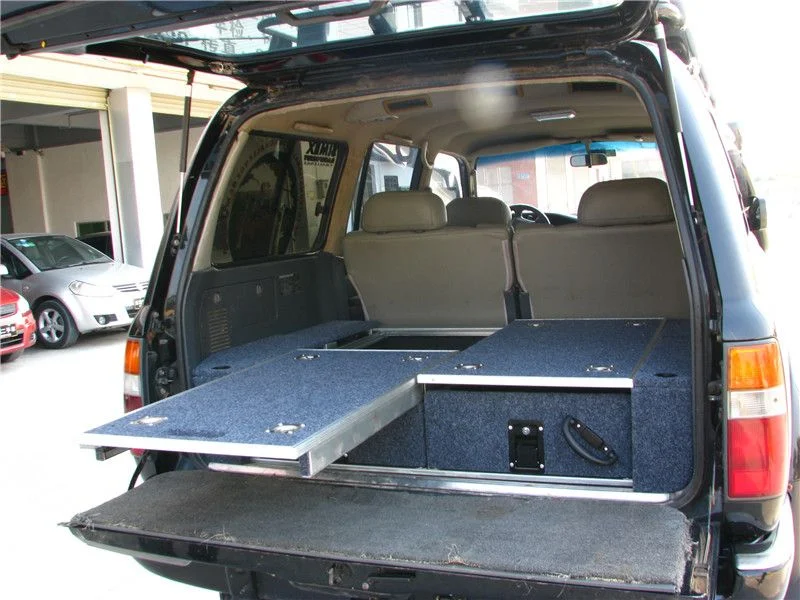

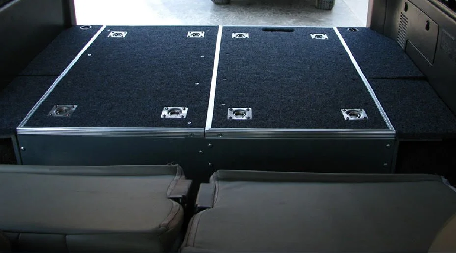

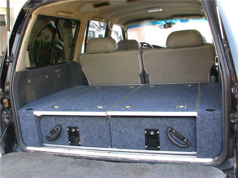

I was offered a couple set of sample rear slide drawers from one of my Aussie vendors yesterday. I'll have to make side wings for the 60 series, but these may be available soon for the 60s...
I will be getting two sets of double rear drawers and wings for the 80, 100 and 200. The 100 set is going in Esme and the I will check fit in the 80 and 200...
Pretty excited to get these and check them out.

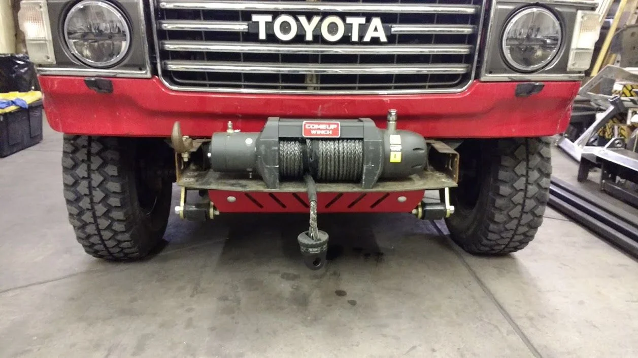

My front winch bumper will be going to @FJ6T more than likely. He's had dibs since I built it, HA!

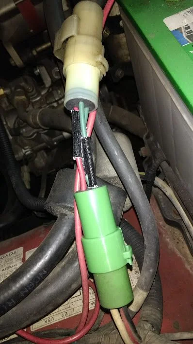

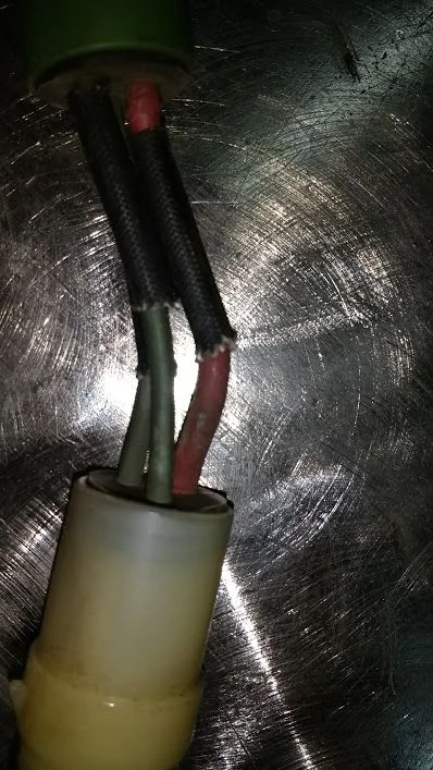

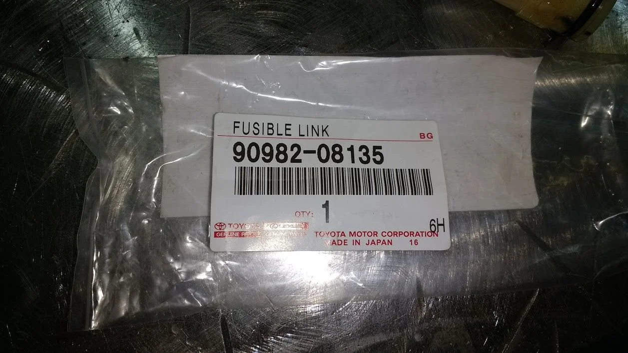

Well after all the cruisers and years of building and working on them... I've never had a fusible link go bad. Andrea went out to the shop this morning to move Poppy out to bring Joe in and no brake lights, running lights, dome light, or heater fan. Started just fine and ran good...
Sure enough the red wire on the fusible link gave up the ghost.. I did quite a bit of welding on a few mock up bumpers, but this has NEVER been an issue in the past and the only thing I can attribute the failure to...
So, jumped in Esme and ran to my warehouse across town and grabbed a new fusible link of the shelves and in less than 60 seconds all was good again.
I guess I'll disconnect the battery from here on out when fabbing off Poppy.
J
Old link- red wire is burned..
New link and installed.

Maybe it was the artic mouse. Rodents love wires. Looking at your weather any animal alive up there must have "artic" in it's name.
I too am gulty of not everdisconnecting a battery in 30 some years of welding on trucks.
Never had a problem yet but I try to keep the ground as close as possible to the weld area
Ground was between the frame rails up front on the bumpers I was building the whole time. Its been nasty this week.. negative temps and 22" of snow. Poppy was in the shop for the past two weeks. Andrea said she didn't want to go out in the cold and said :flipoff2:

I love the aussie drawers. Mine are 19 years old now. Never an issue with function or wear
Well I doubt these are the same Aussie drawers you have, HA!... They are from Optimum and I know they are sourced from China. I'm okay with that as long as I know up front. I've seen very similar that are rebadged, but no doubt from the same origin.

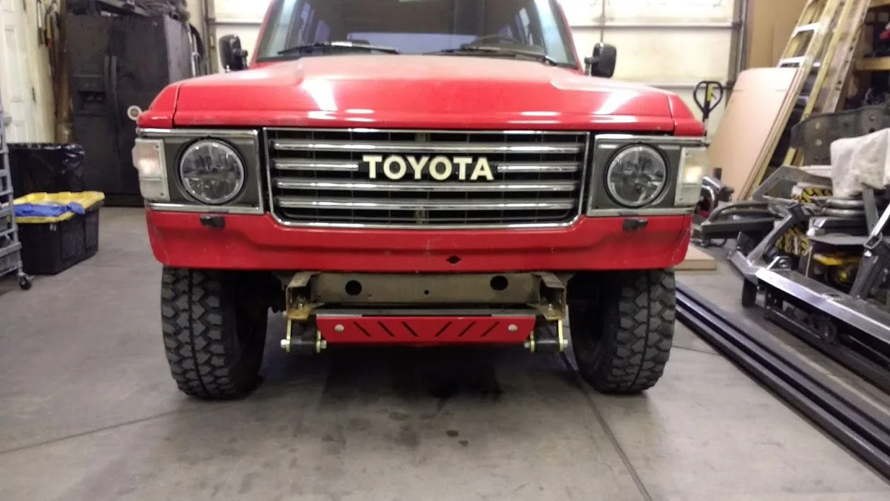

Had some time this afternoon and started on the Poppy's rear bumper to finish out the day.
When I was cleaning I found some of the first high profile shells I had bent. So, one will get put to use. Pretty bad when you "find" 4 bumper shells.... :eek:
