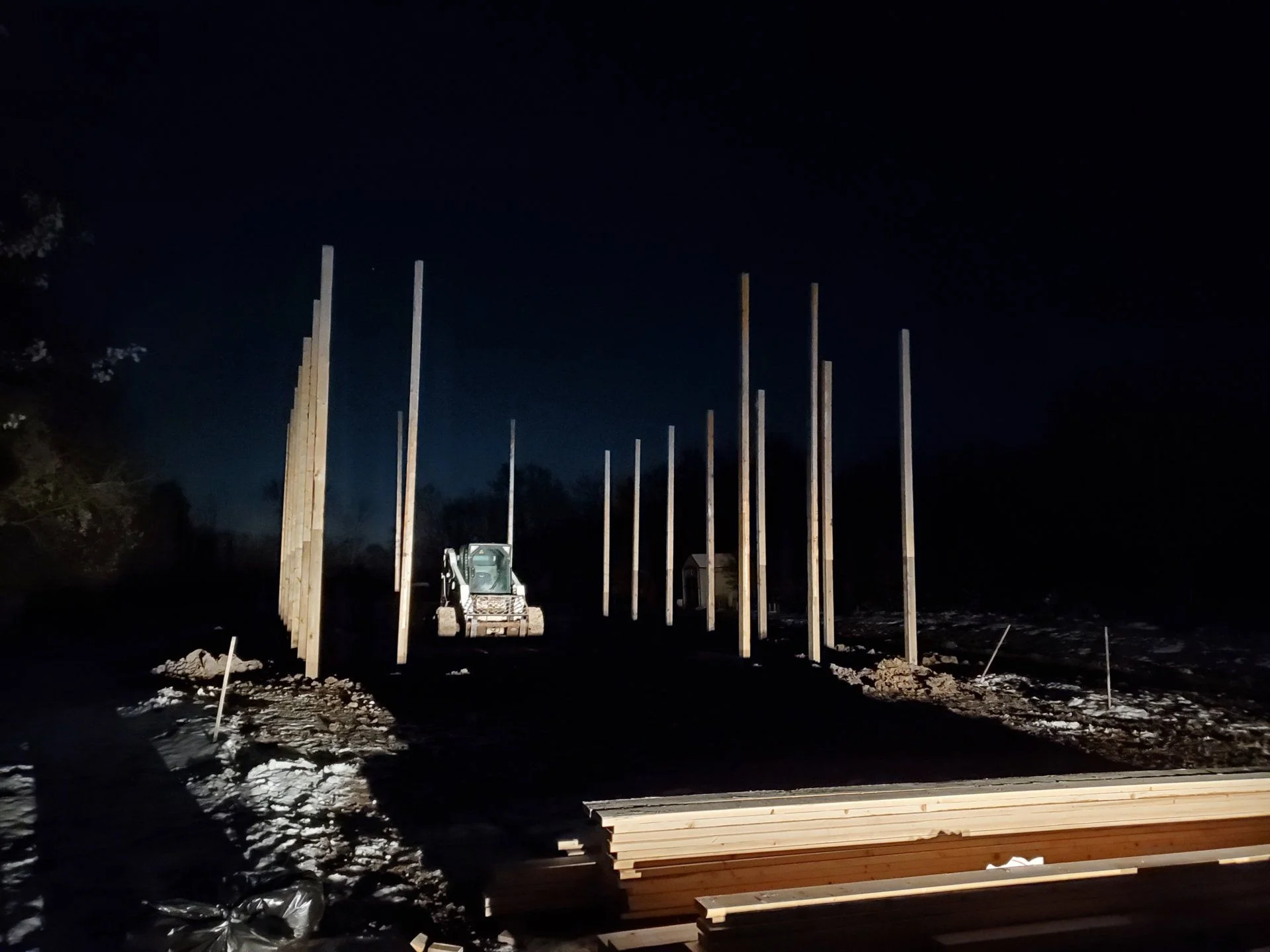

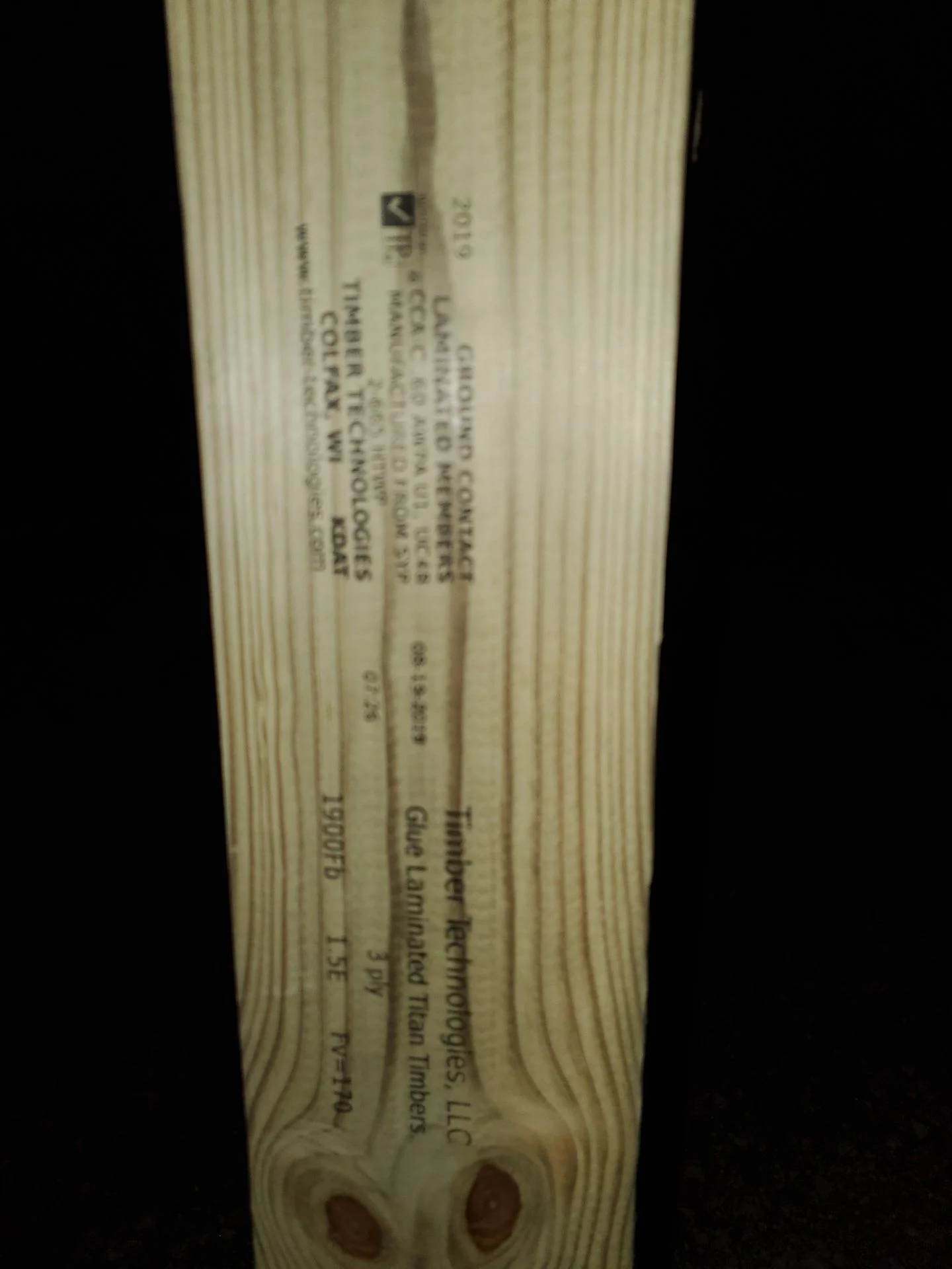

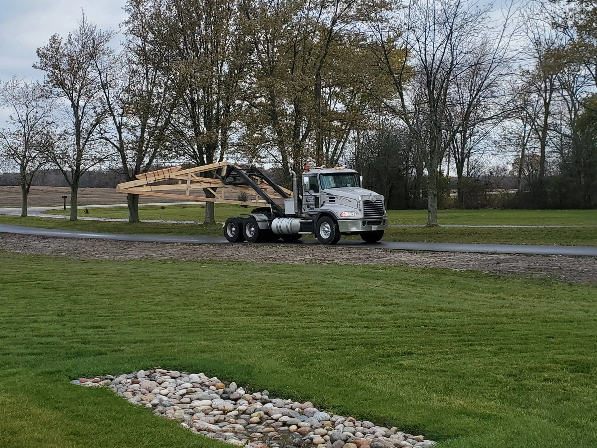

Material delivery :cheers:
1st time for me as well. It actually went very smooth.

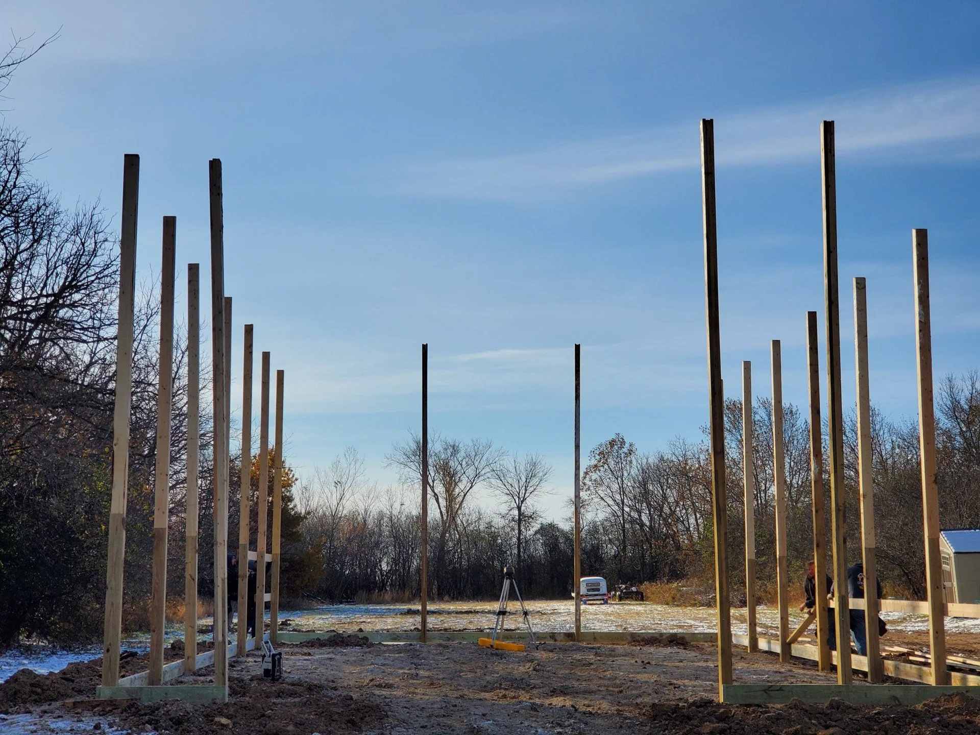

If the weather holds out, posts go in the ground on Thursday. Stay tuned......

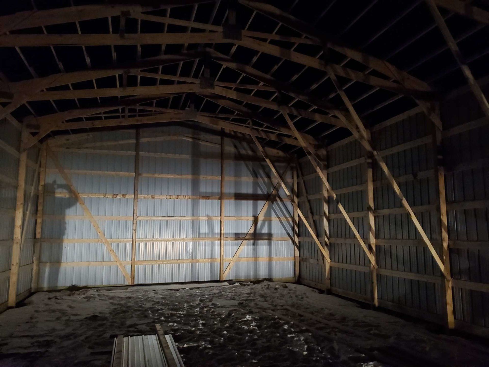

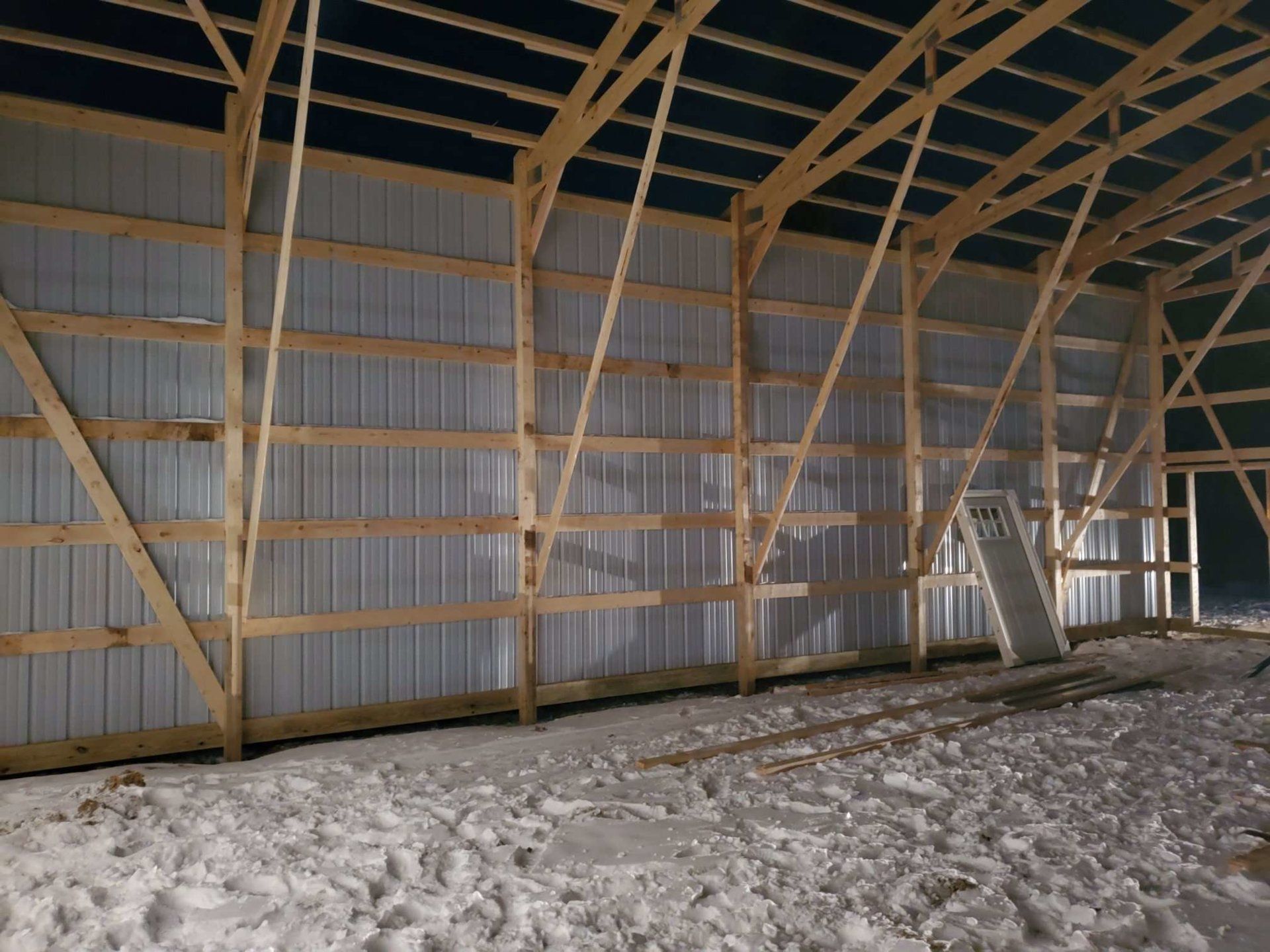

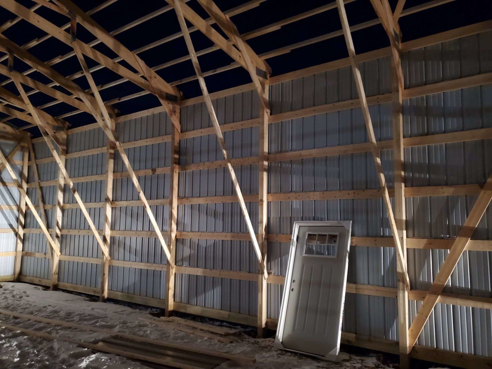

Got home late but here are some spooky pics from last night. Kinda cool actually :cool:

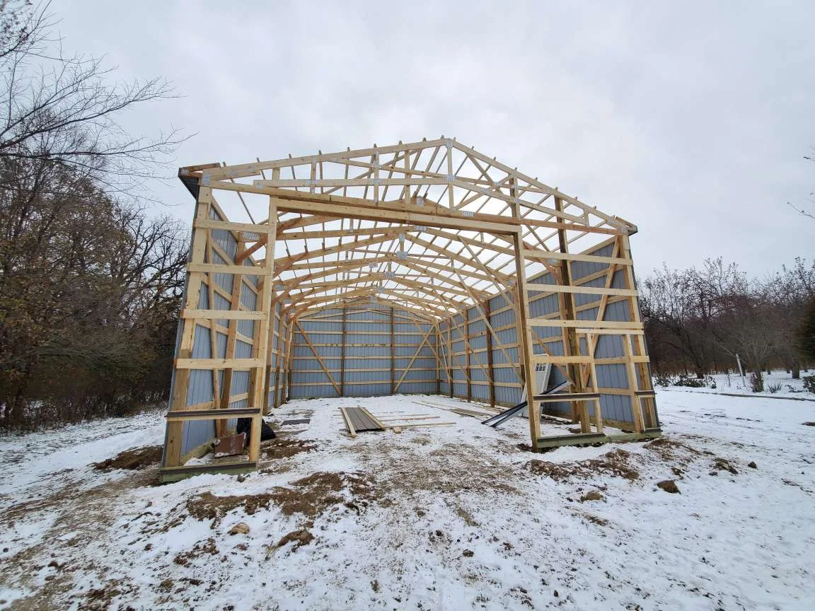

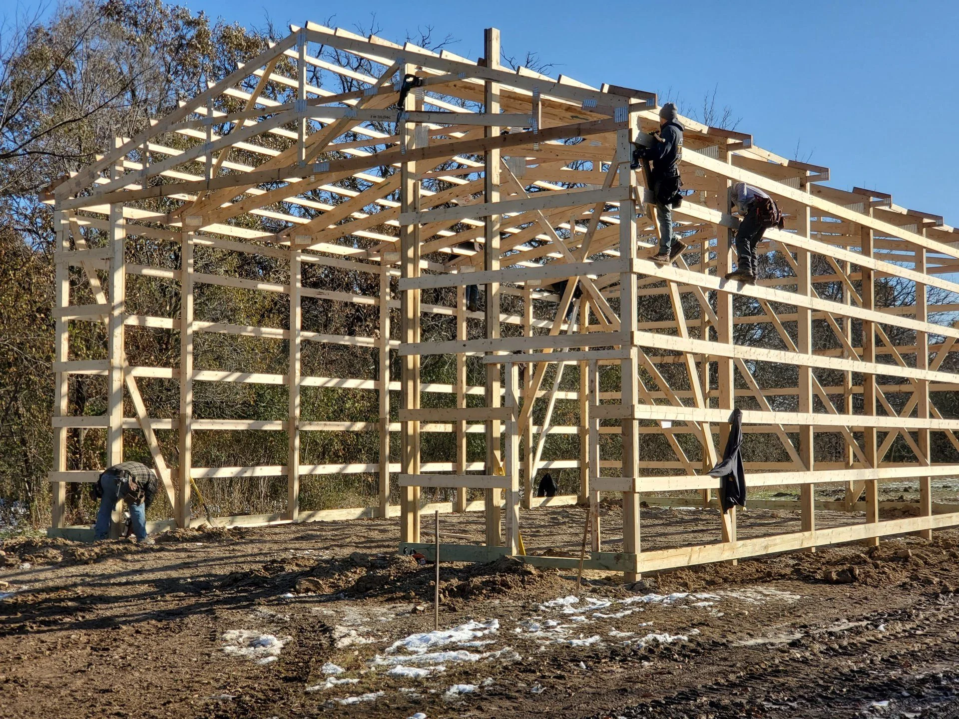

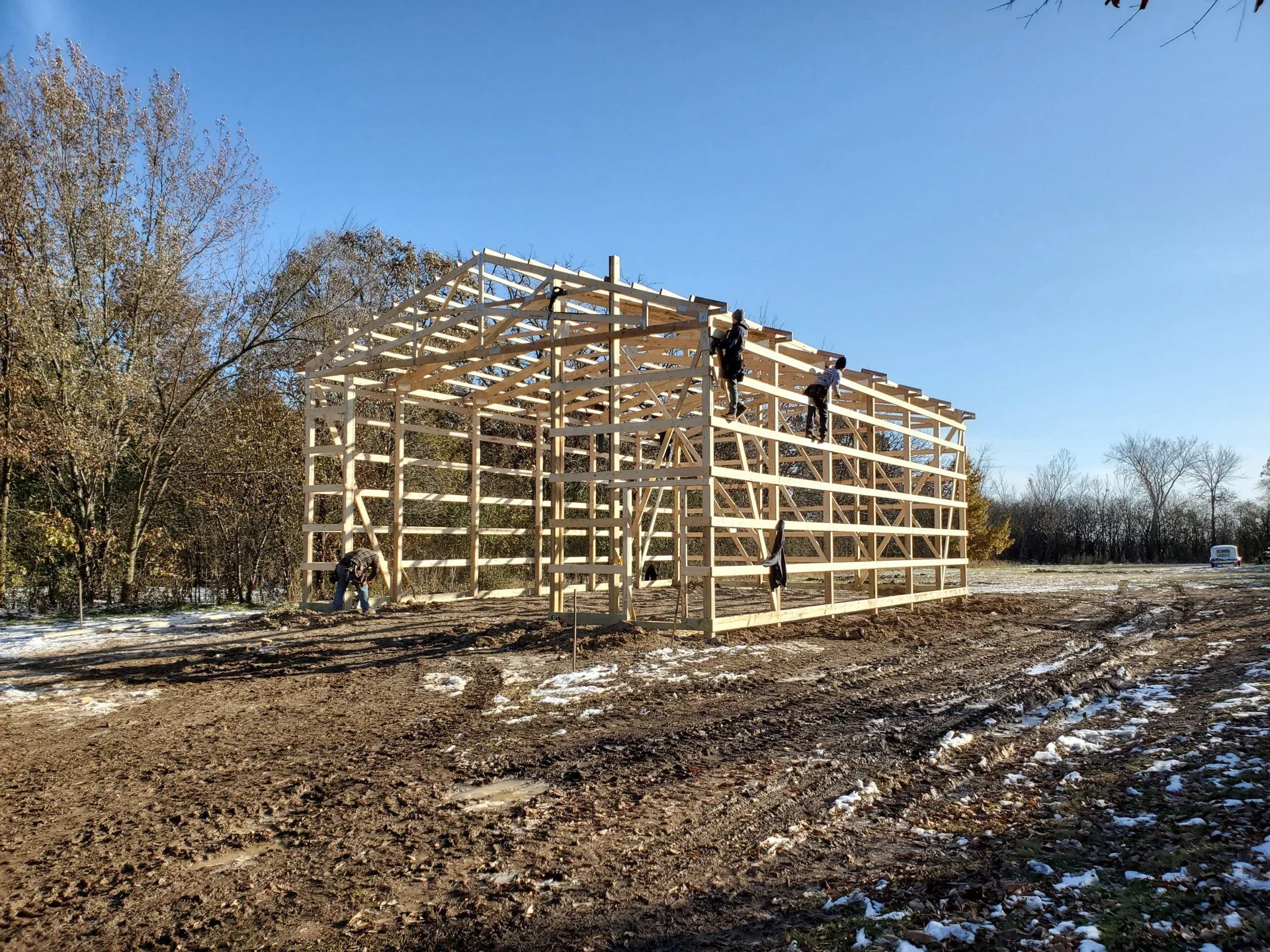

Better pics from this morning. Trusses are supposed to be up today, stay tuned........:popcorn:
As of 5 minutes ago

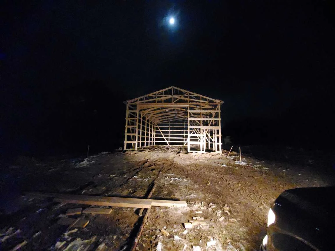

IDK, it really looks too damn small but I know it's not. My eyes playing tricks on me for sure. It was the same way when building the house. When it was just studded walls the rooms all looked too small but when the drywall went up it was like " whoh, what happened, these rooms are now bigger" :eek:. I'm sure once the sheet metal goes on things will look like I expected them too. Kind of a cool picture from last night with the moon directly over head

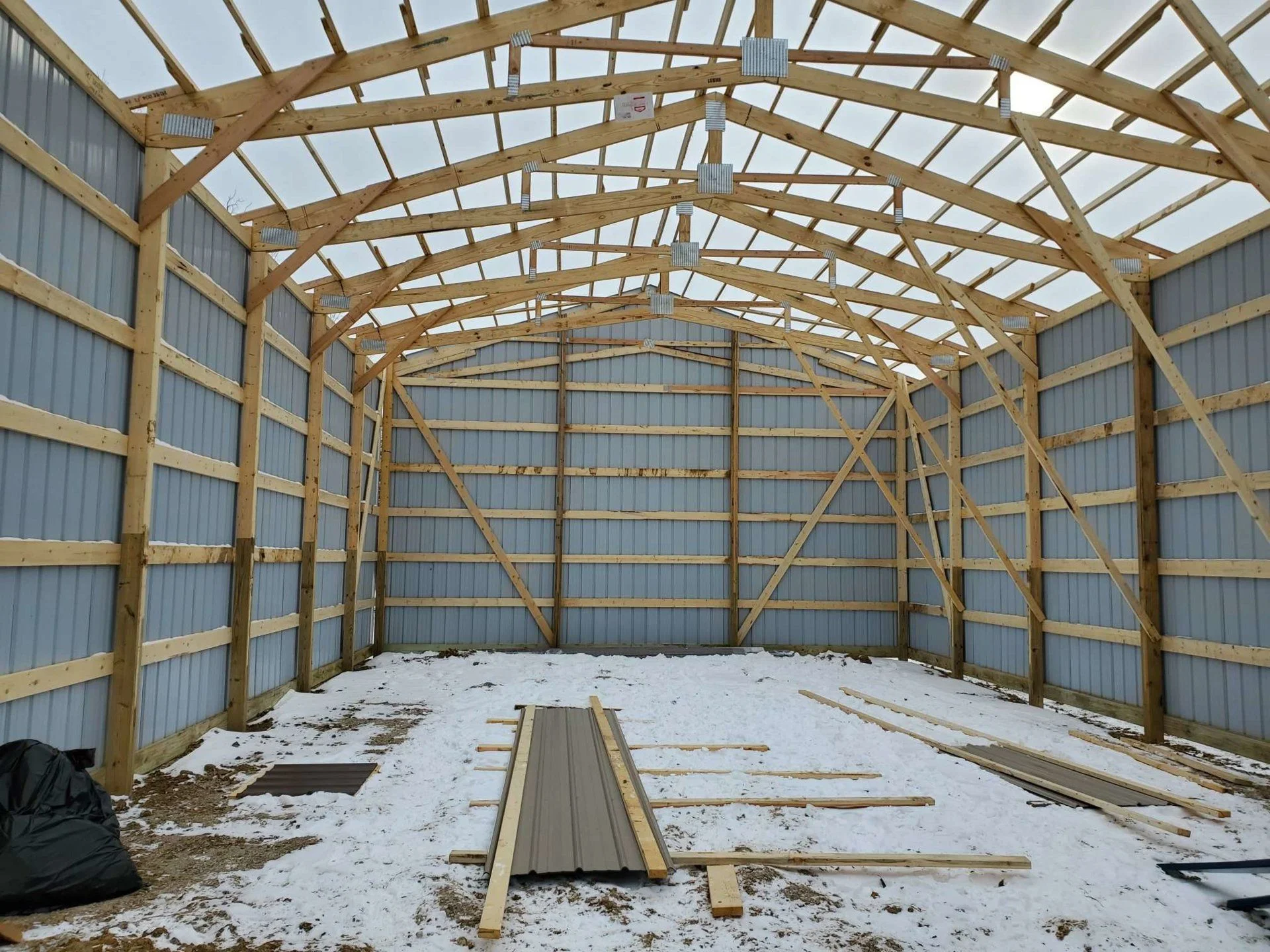

Well they did get some sheet metal on yesterday. I think they will be done Mon/Tues next week.

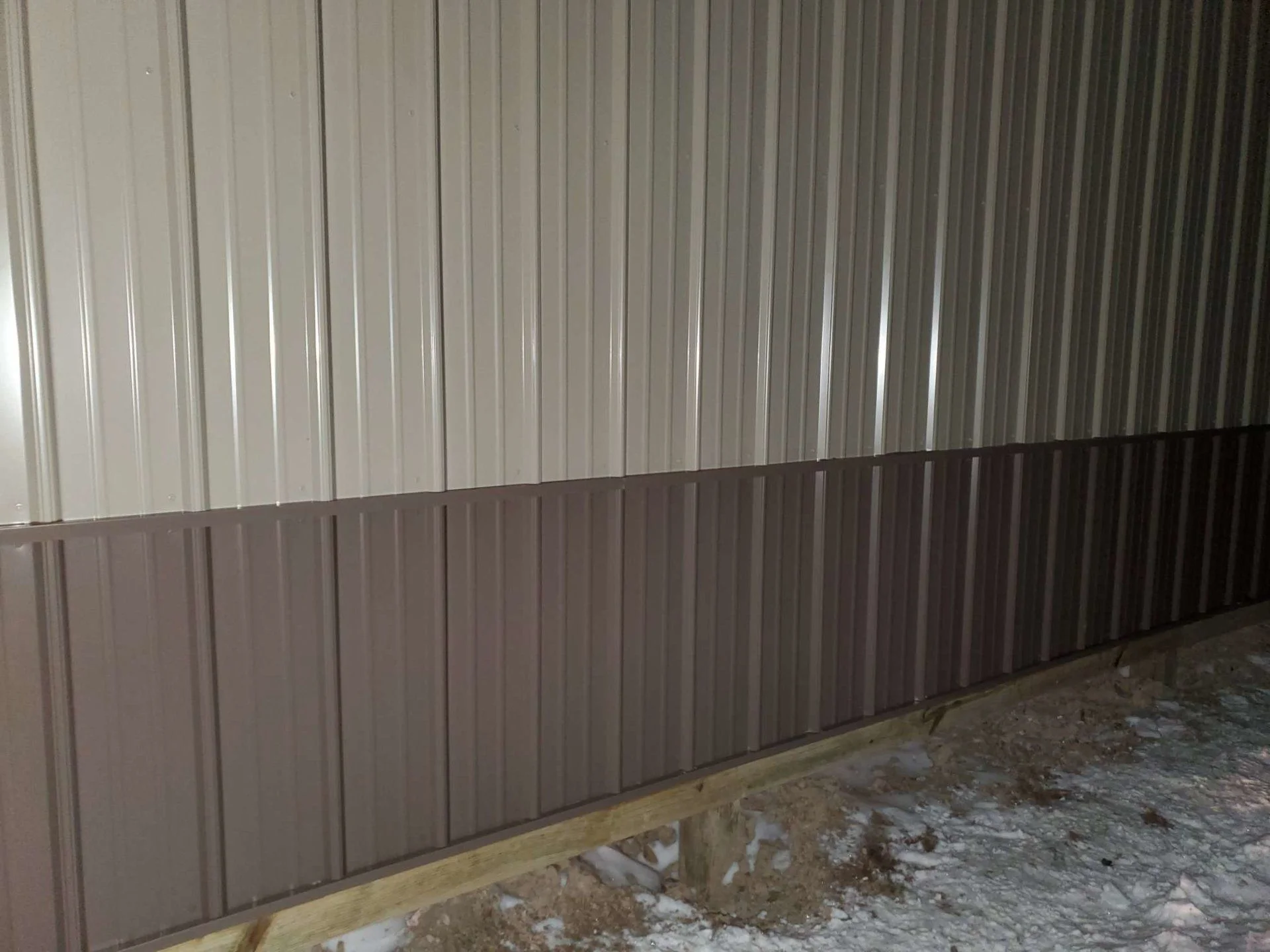

Got a few updated pics, although they are late evening pics. More siding and wainscot have been applied. I have to stop working so late :bang:

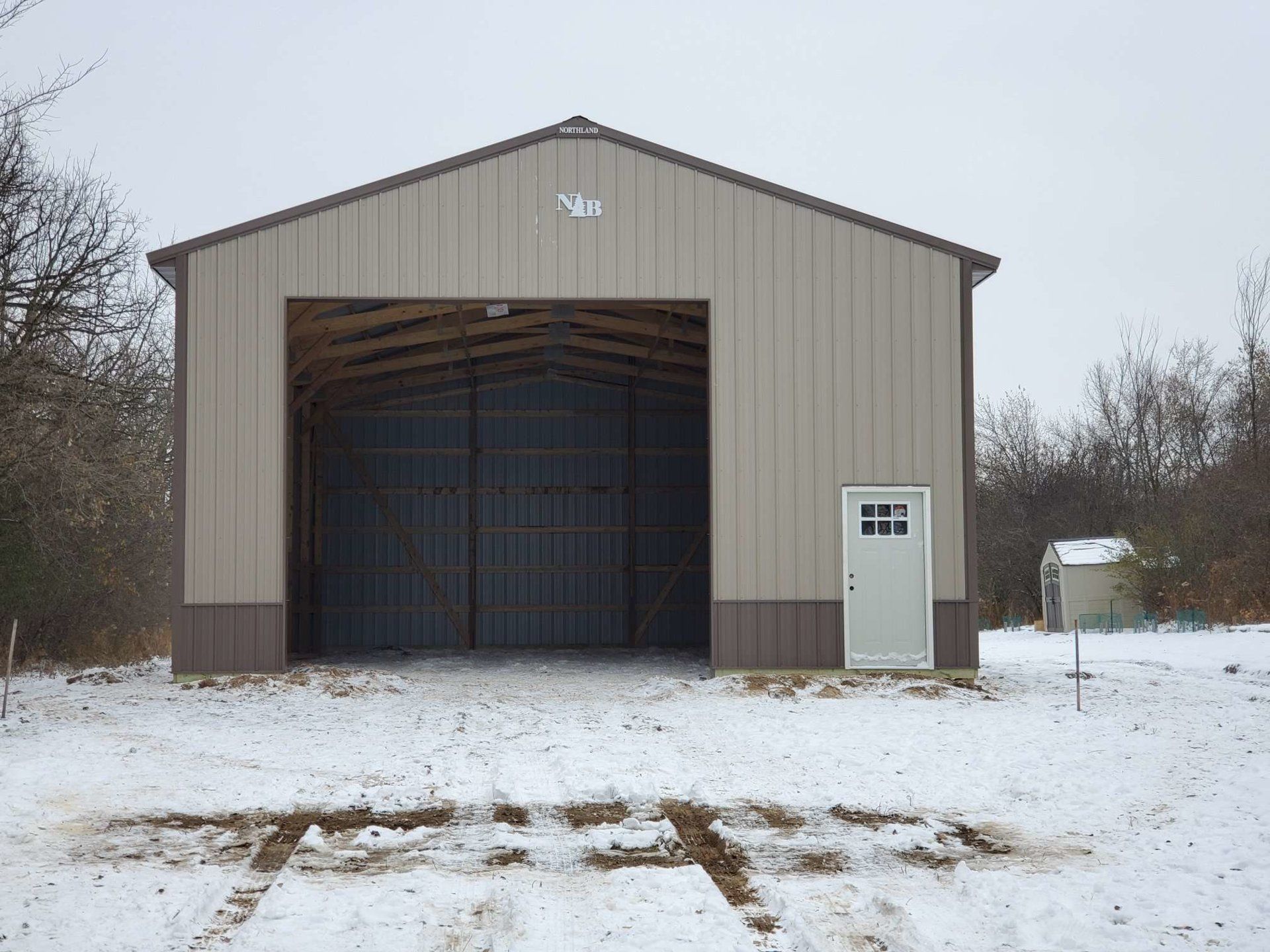

Here are the newest daytime photos

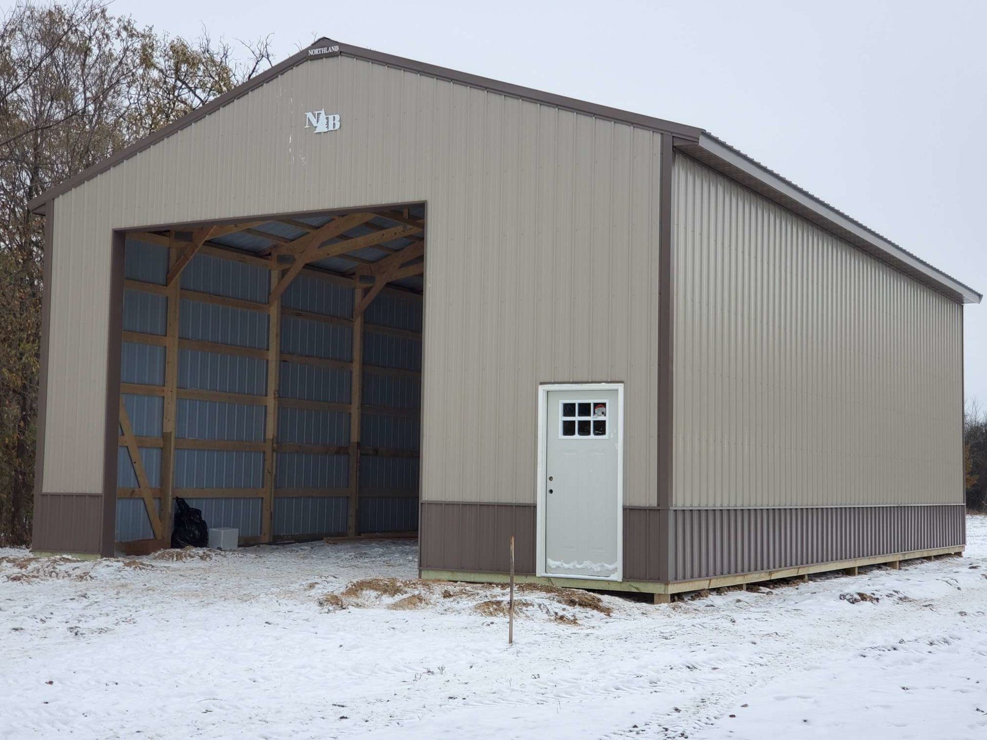

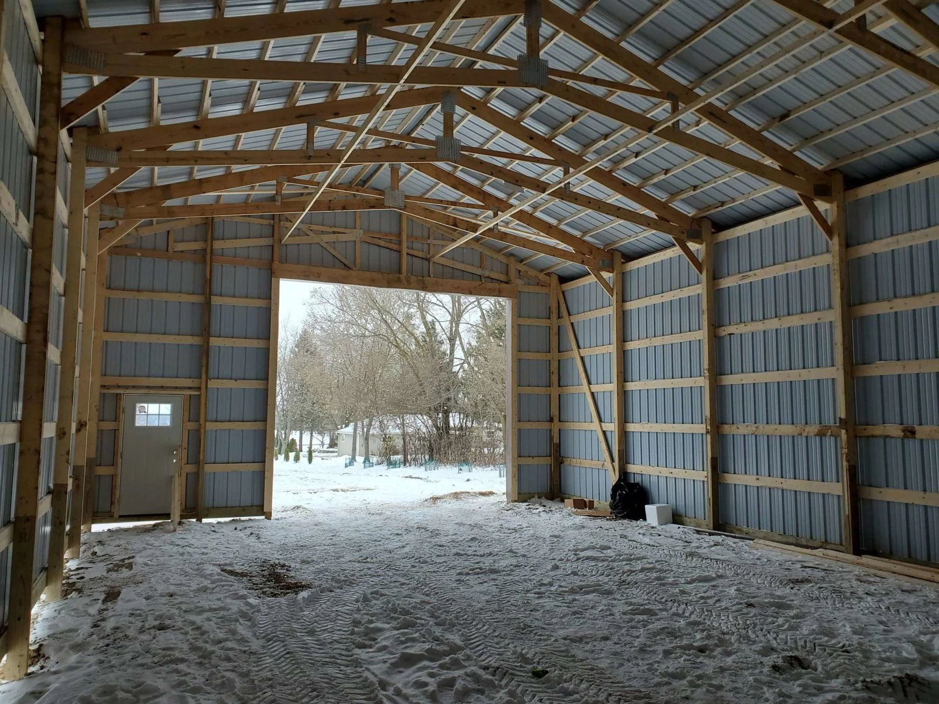

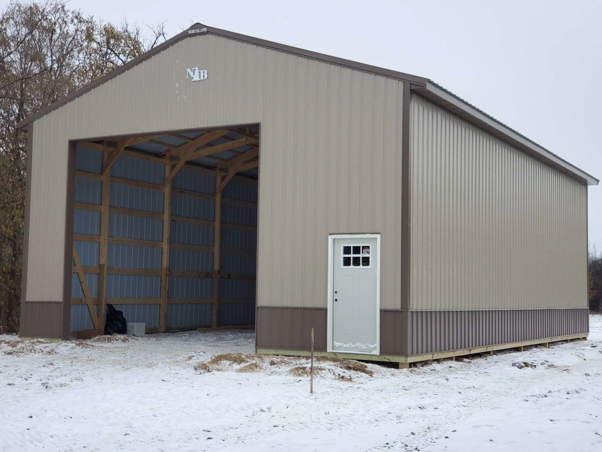

This morning.....nearing the finish line :bounce:
Ordering the 16 x 14 garage door this weekend. Insulated (19.4 R value).........then try to figure out if I can install the damn thing.
Safe to say no concrete till the frost comes out...how big an apron do you plan on pouring?
Actually concrete next week as we will have a few nicer days. Hopefully an 8', full width apron.
