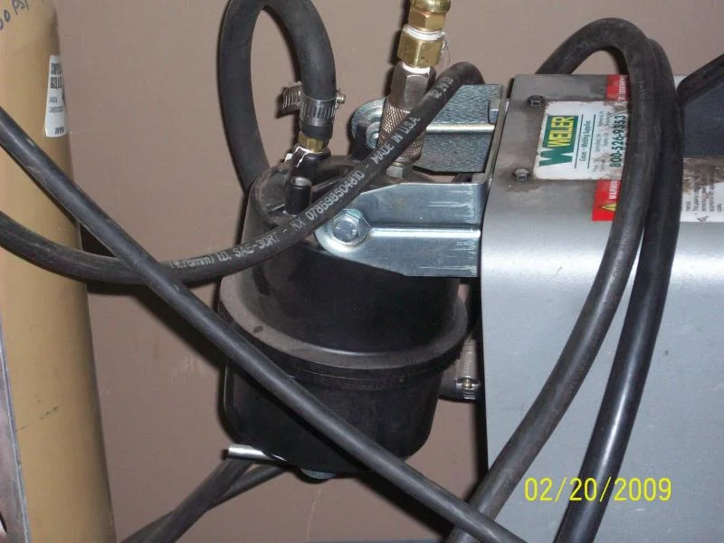

Keith,
Pics you requested, sorry for the delay. My unit sits on top of the MIG and works out well for me. Since I have only a single outlet, this makes it easy to plug in either appliance.

Got the fittings to plumb it in from home depot. Not the final set up by any means, but I HAD to try it out.
I couldnt quite figure it out at first...
It would ignite, then stop.
So I checked all the connections (pull em off, put em back on), then I realized that you MIGHT need to strike the nozzle to get it to ground. I was holding the nozzle OFF the material. I touched the nozzle to the steel, and off she went!

Thanks for hooking up those pics Ali.
I appreciate it.
I ended up using hard line for now till I can build a cart and hard mount the filter ON the cart.

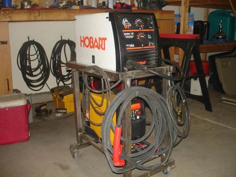

Got the plasma situated in its new home.
Started to build a cart for it, then I realized that I could just stick it under the welder on that cart.
I at least got to practice with the plasma. I made the bracket for the filter with it, and I got about half way finished with the other cart before I realized the alternative.

KEWL!!!!
now set the timer on your camera and take some action shots. :grinpimp:
