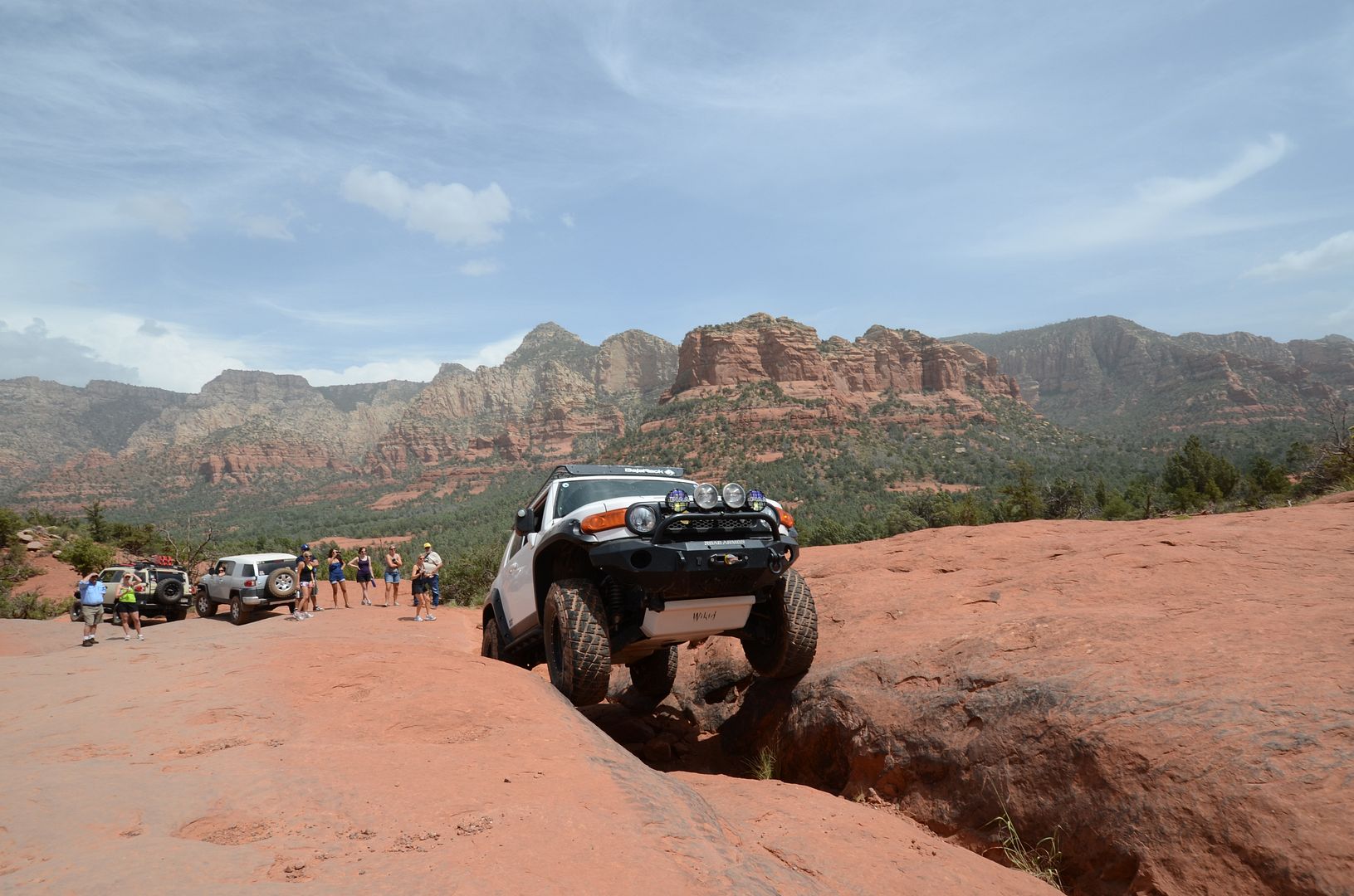

Here is my old 07 on 35s. Picture is from 08. Never should have sold it
