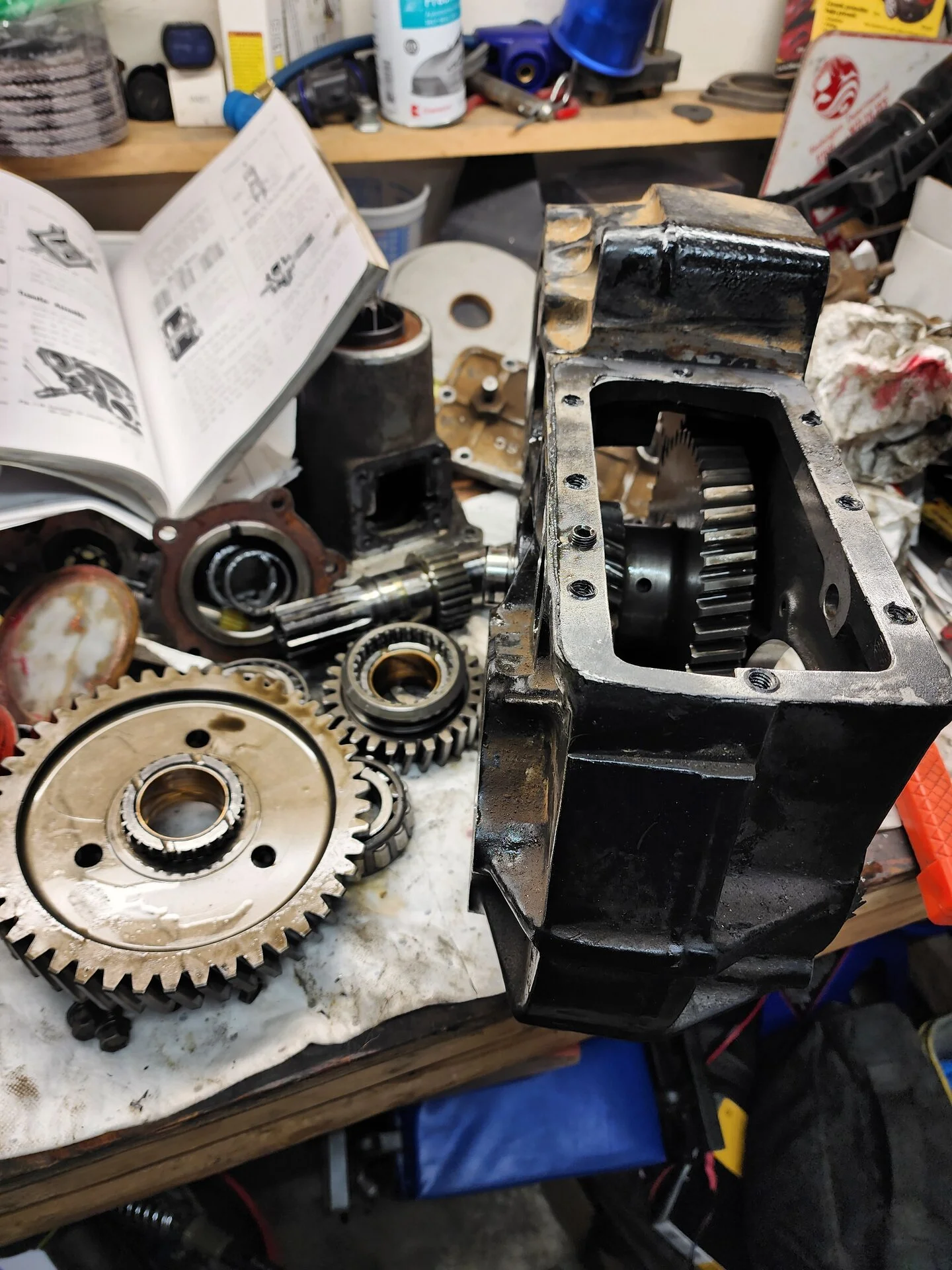

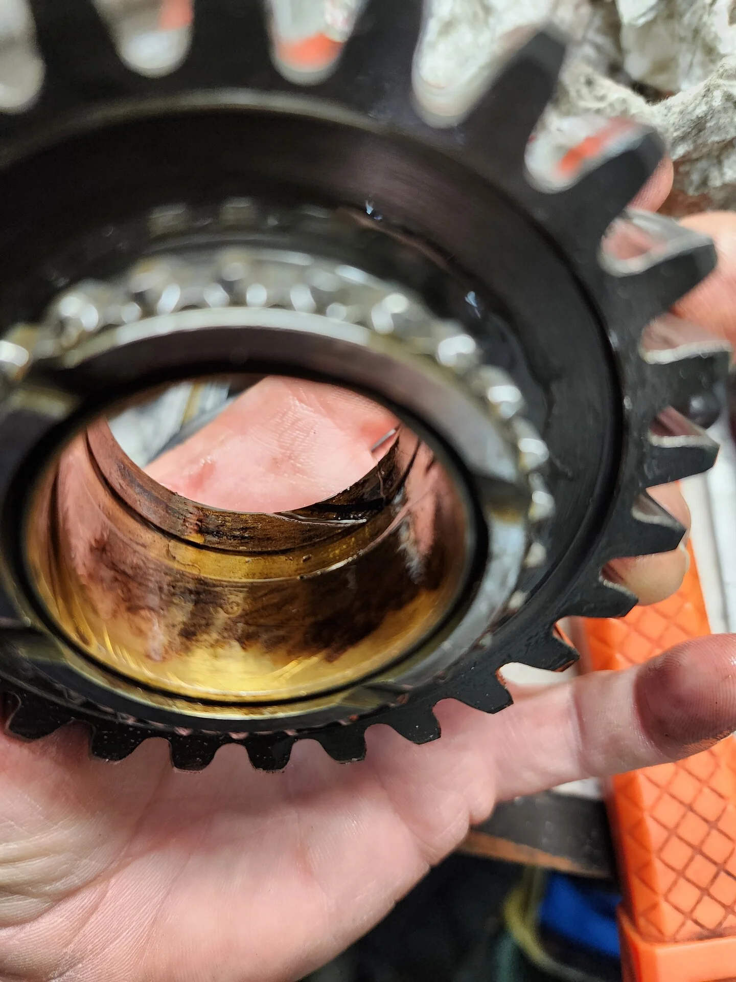

And just like that, a year and a half later, it's time for an update. I said when I tore my Orion apart again, I would document it. So, here it is. This last hunting season, I had the same problem, if not worse, of my transfer case popping out of gear on declines. I ended up posting in the Orion sticky in the 40 series forum. I got some good advice, and sure enough, I found my problem. And that problem is 100% my fault. Going back through the thread, after I built the Orion, I took my 40 up to my elk hunting camp. I flat towed it about 250 miles. I was running late, and decided not to pull the driveshaft. What could go wrong? Well, thanks to @peesalot, I got my answer. I tore down the Orion again...
...and found the high speed gear had worn unevenly. It was painfully obvious when I pulled it apart and inspected it. Heck, burned would be a better term.

After some great advice from Mark from Mark's Off Road, I inspected the rear output shaft and found it was also worn. With an order already placed for a new high speed gear and an Orion rebuild kit from AA, I quickly added an output shaft to that order.
With it all put back together and installed, it seems to be working fine.
I haven't had it on any steep declines since I've rebuilt it, but hopefully soon. Lesson learned (even though I should have, and do, know better), no flat towing with the driveshaft connected! Removing 4 bolts is a lot quicker than rebuilding the transfer case. Cheaper too.
