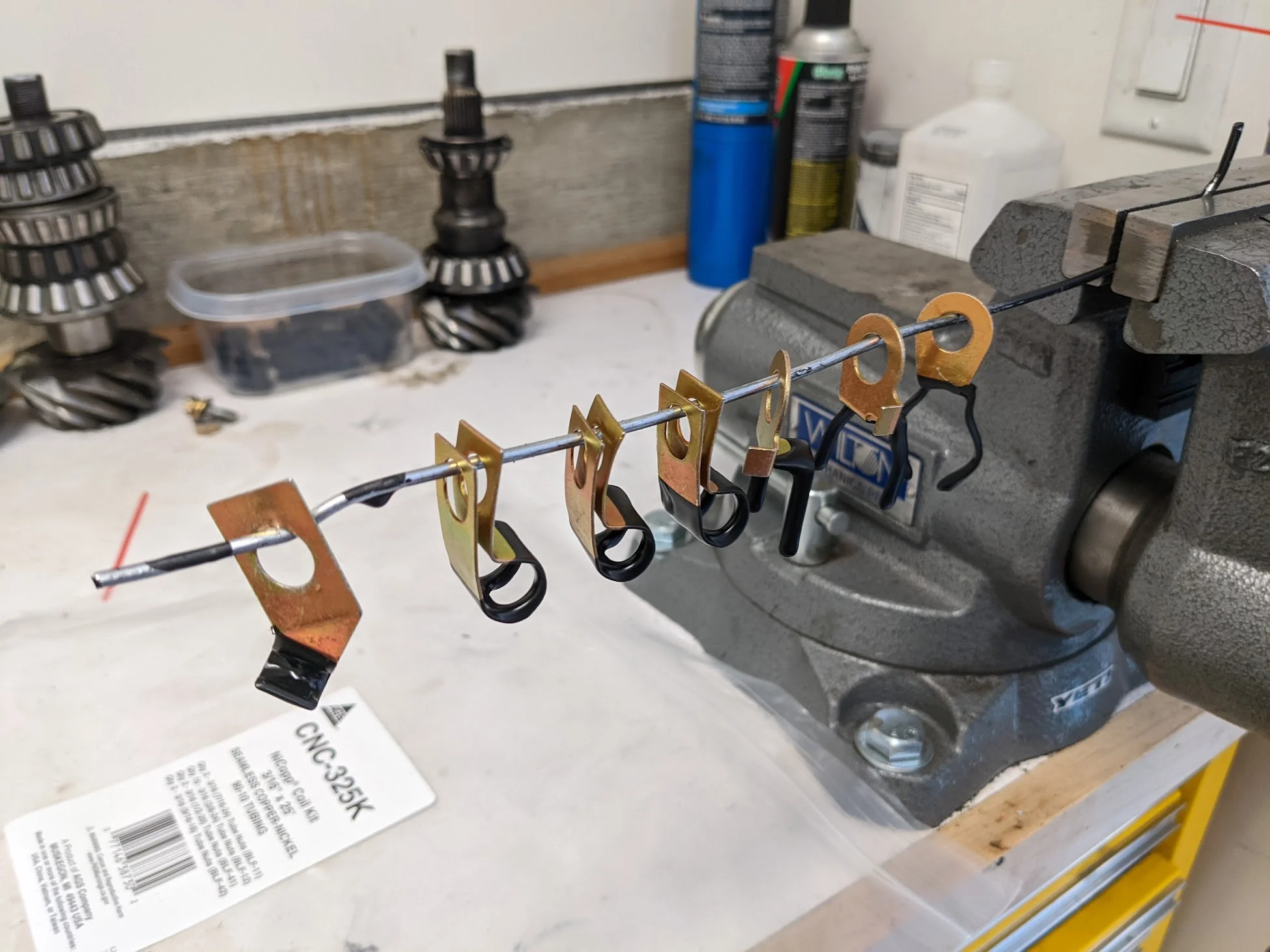

I used plastidip on a few clamps that are NLA when I restored my chassis. Worked great and has held up well so far
Now that's what I'm talking about :) Looks great, thanks for the picture.
That front axle brake pipe clamp closest to the end of the wire is one of the pieces I have had plated and dipped myself in black 2k PU paint.
