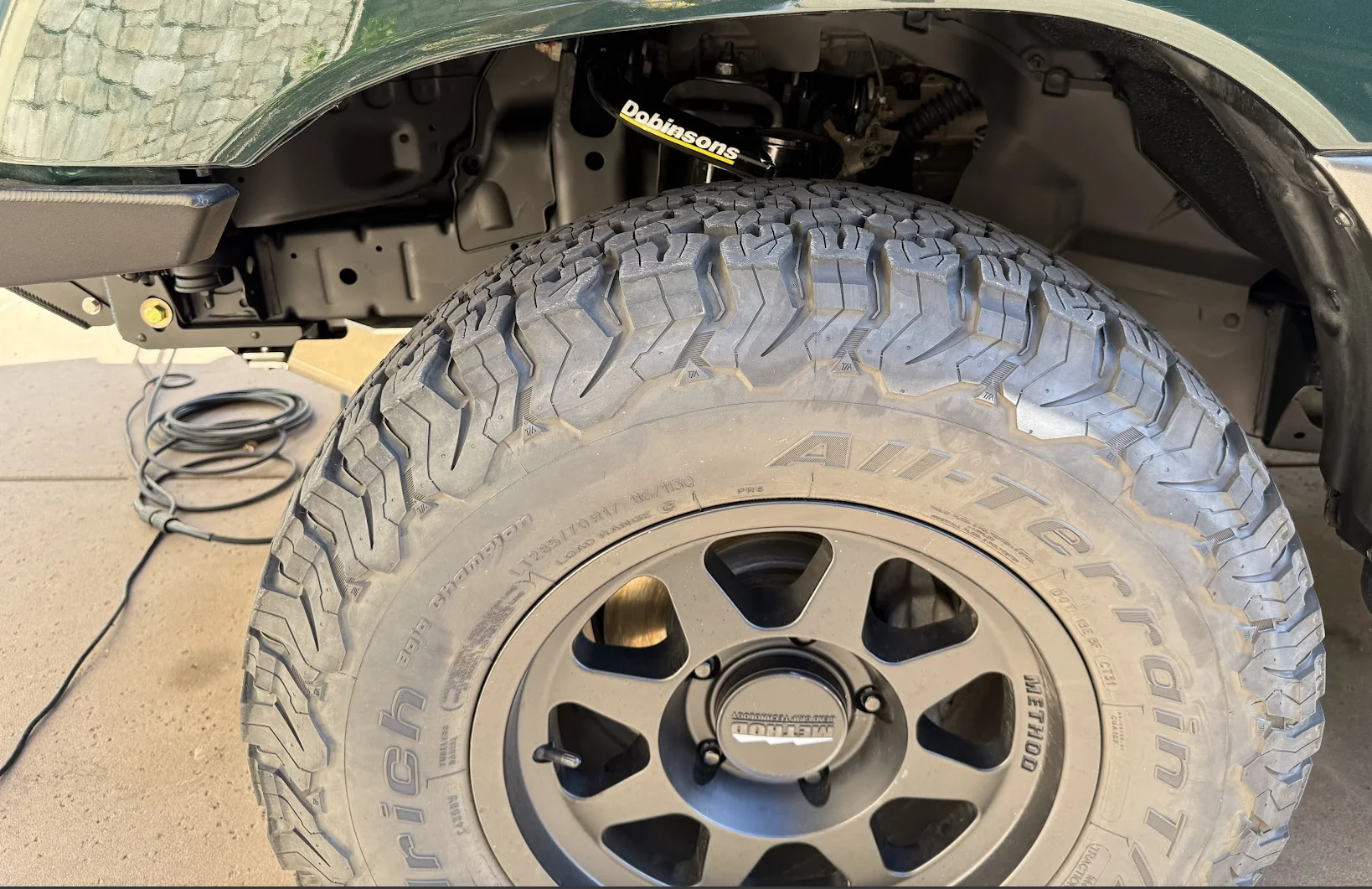

Just finished a 4-hour detail of the wheel wells...not sure why other than I like detailing and had nothing on the honey do list today. Super glad for the Pladwagon reservoir! :cool:

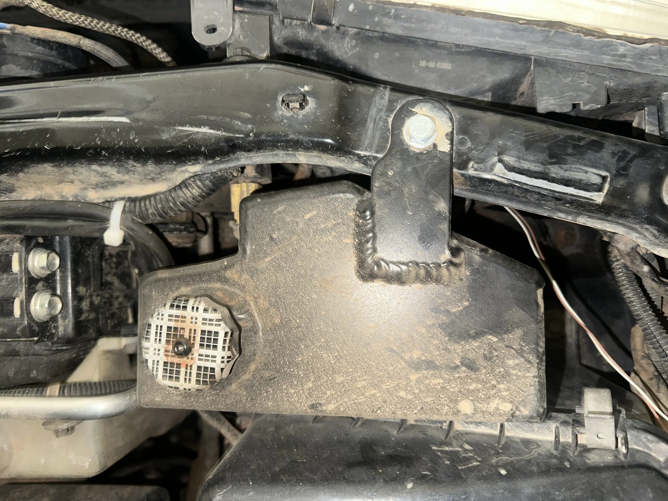

Kyle was awesome in modifying my reservoir tank to fit my monster retrofits. Glad to have it back on the truck!

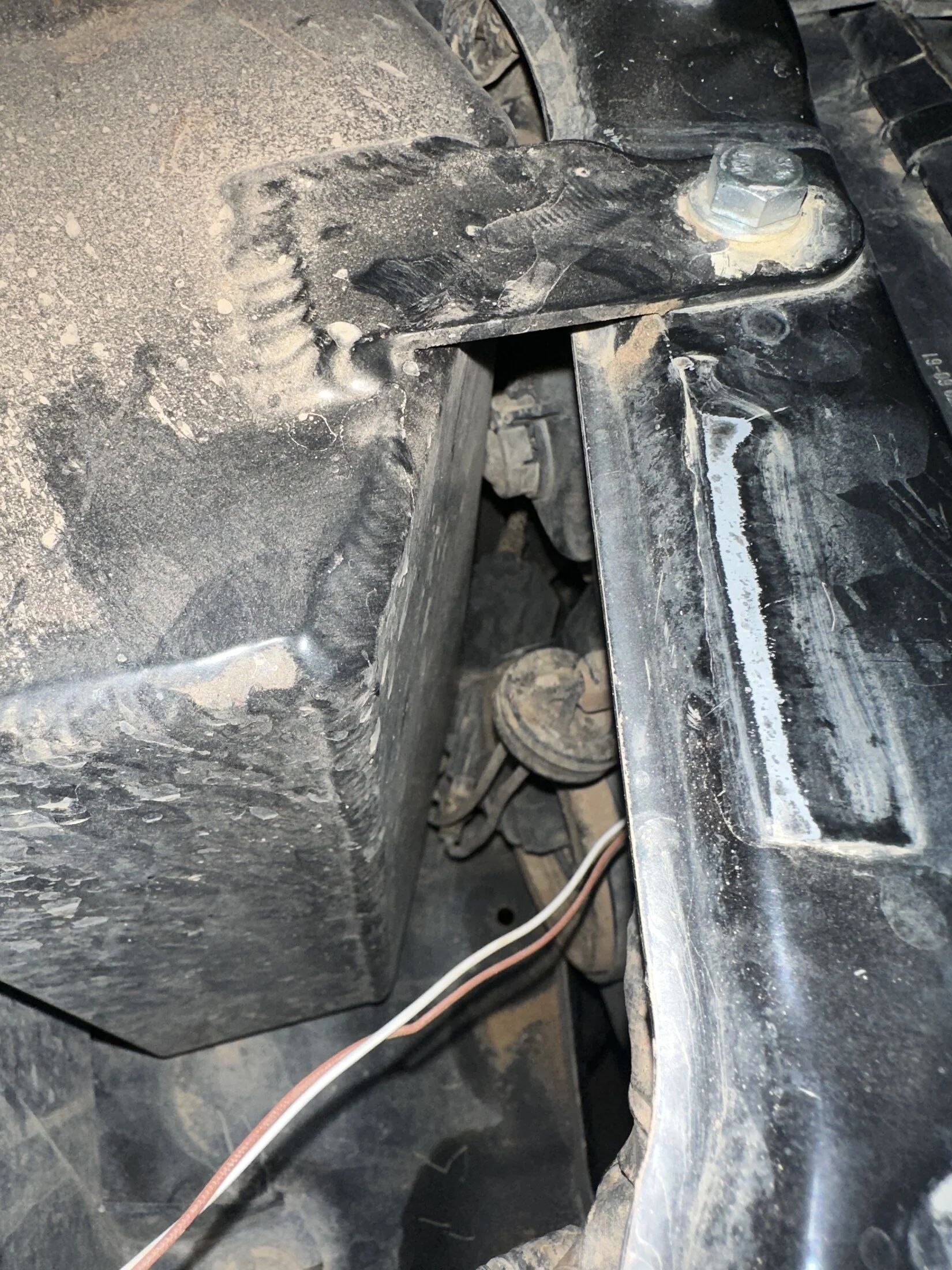

For now I'm taking the tank that I offer and modifying it for clearance based on some dimensions needed to work around the headlight. The 98-02 tank and the 03-07 are different profiles but neither extend forward under the core support for a visual reference. I'm just doing a $50 ($100 if you already have a tank and I need to re-powdercoat and ship back after modding) mod fee on top of a new tank purchase to cut and weld a notch piece, so far its only been the one tank for the Lightwerks Land Cruiser housings. I'd love to have a solid grasp on the popular options that need more room, feel free to drop any pictures on here of your set up to see what is needed.
@splashflash already had a tank from me installed before the headlight upgrade, he put some masking tape on the tank to layout the area needing room and that worked out really well. I think that would be the most efficient way to do this from scratch if we determine some extra clearance is needed.

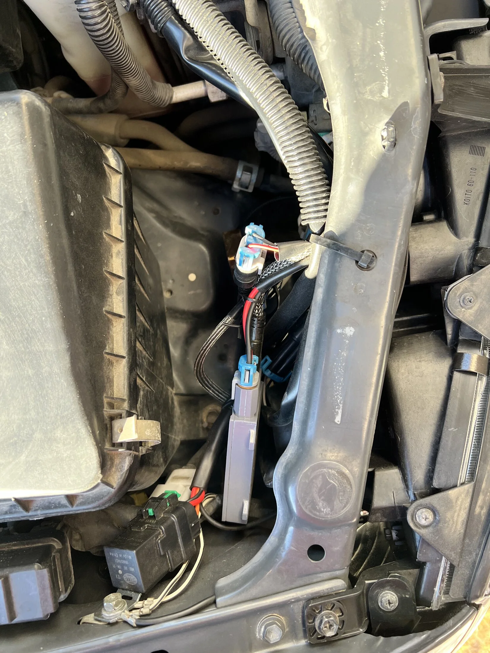

Here’s a picture of my setup. What do you think?
No tank clearancing needed on mine. Its a Morimoto mini h1 setup but looks similar to yours. Might have to move the projector wiring and ballast around. Ballast is mounted in front of the radiator core support
Looks like an 03-07 tank for yours, that tank has a little more room on the front side versus the 98-02 tank that @Ma son has in his. The pumps will be under the relay on that corner of the airbox, they’re down low so you might not have to move that. Physically I think you’ll be ok but you might need to reposition some of the wiring on your lights.
