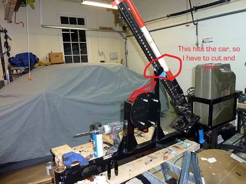

Well, as I mentioned, I ran into a major goof, got to cut of the Jack support and reattach it elsewhere on the tire carrier. Just not enough room for it..

Well back to the drawing board, tough to visualize things and then make them esp. with this portion of the bumper.

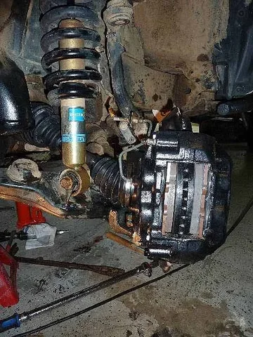

I finally got around to doing my brakes (tundra swap) and axle replacement. Slinky1 came over to help me do some of the heavy lifting since I still have a bum arm...

Install the new tundra brakes....I sure hope this fixes my brake problems.....

OK..... I am done, slow going as I am anal about making sure it is right....
Just cannot drive it yet as I one of my bolts got partly stripped.
What went wrong during the process.
1. Stripped one of the lower ball joint bolts (6 on order due tues)
2. had to pull off one of the dust shields from the old axle and put on after I had put the left side back together
3. Should have loosed the brake line fittings before removing them. Slinky1 cussed a few times on that one
4. Somehow, I forgot to order anti-squeal shims last year, so I had to run to the local dealer
