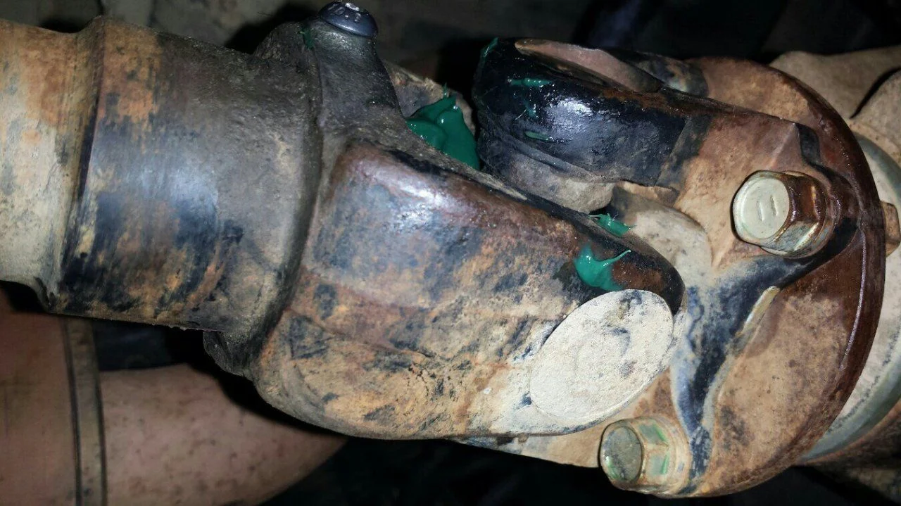

I finally got the drive shafts lubed and repaired the broken grease fitting.

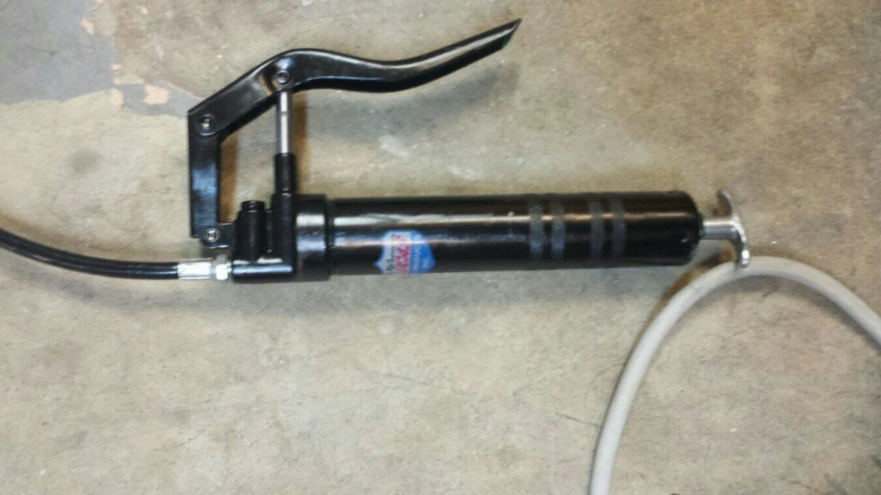

I do need a better grease gun as this one sucks. Any suggestions?

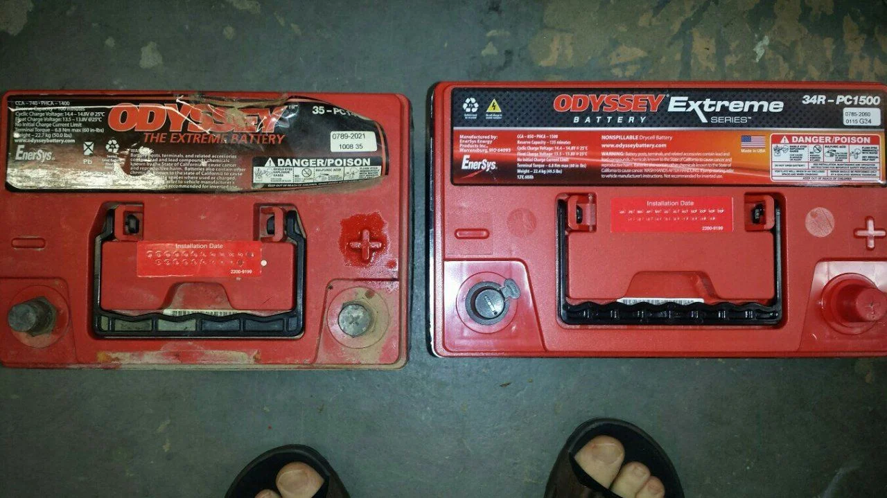

Well we have finally come to a new battery time. I stayed with odossey battery. Got a bigger one with reversed terminals and a tray adapter
what was up wit the old one? Guess that means you'll be hitting the Expo ride then, huh? All the excuses are now gone especially since you're going to OTMT. :flipoff2:
Ha Ha! Old one stopped holding a decent charge a few months ago and slowly deteriorated. I got it in 2008, it sat for 1 year and ran out in June, so I guess that is decent battery life. I need to do the big three (electric) that is....for my truck, but I need to source the parts as well.
Some of the guys by the diehard group 34, a clone of the Odyssey battery. I researched it and agree, but why screw around with reversed terminals with the normal group 34, when you can get them exactly how they need to be set with a Group34R (r=reversed terminals).

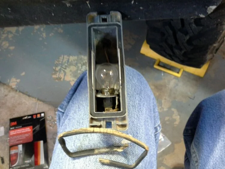

Prepping for the new years ride and the water crossings. Got tired of my blinker flickering and decided to redo both because of the rust inside due to failed seals. I initially replaced with neoprene, but I did not yhink that was gonna work long term. So I got weather resistant 1/8" rubber and cut away. Here is the old verses new seal installed.

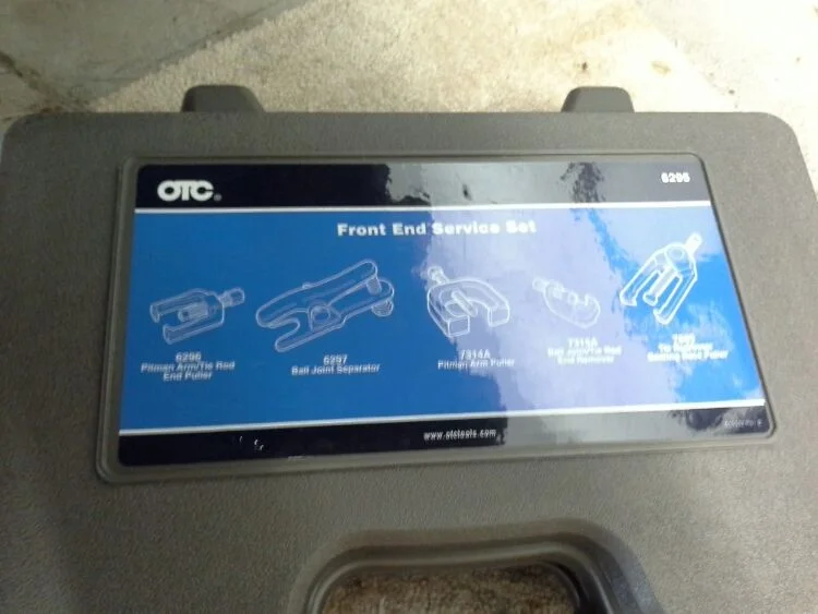

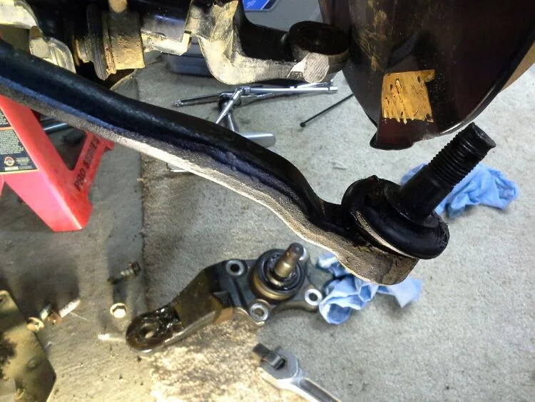

Well, I finally got at the front end lower ball joints. I tore an outer tierod boot so I had to order new tie rod ends (outer) and a front end kit from amazon for $100. What took me 2 hours with home made tools and watching youtube, I got done in 10 minutes with the kit.

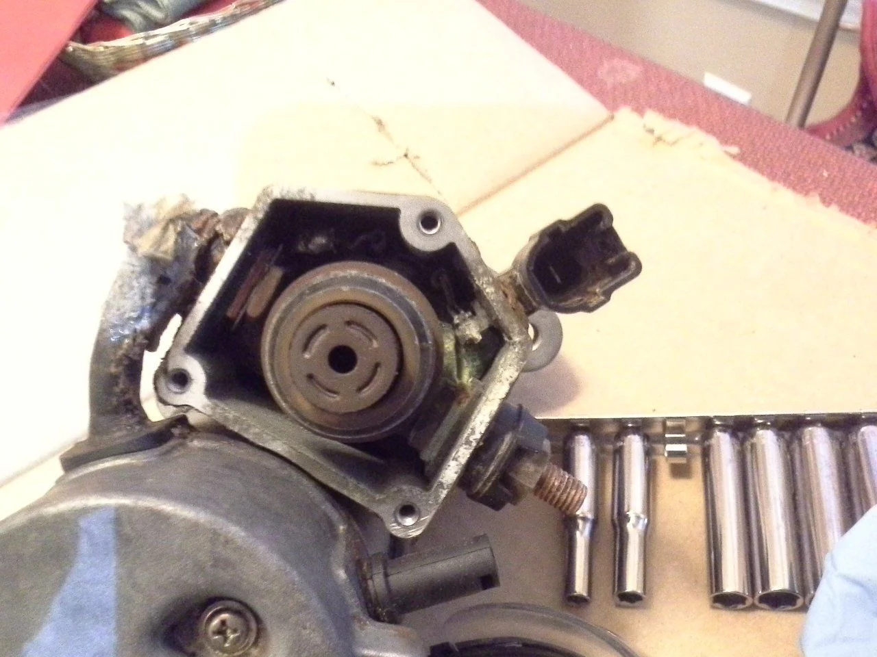

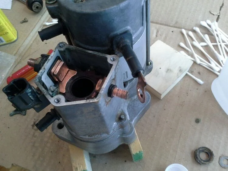

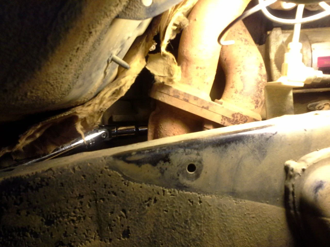

Finally successful in getting the starter bolts loosened. This is one of the most different repairs I have encountered. Can barely see the bolts.

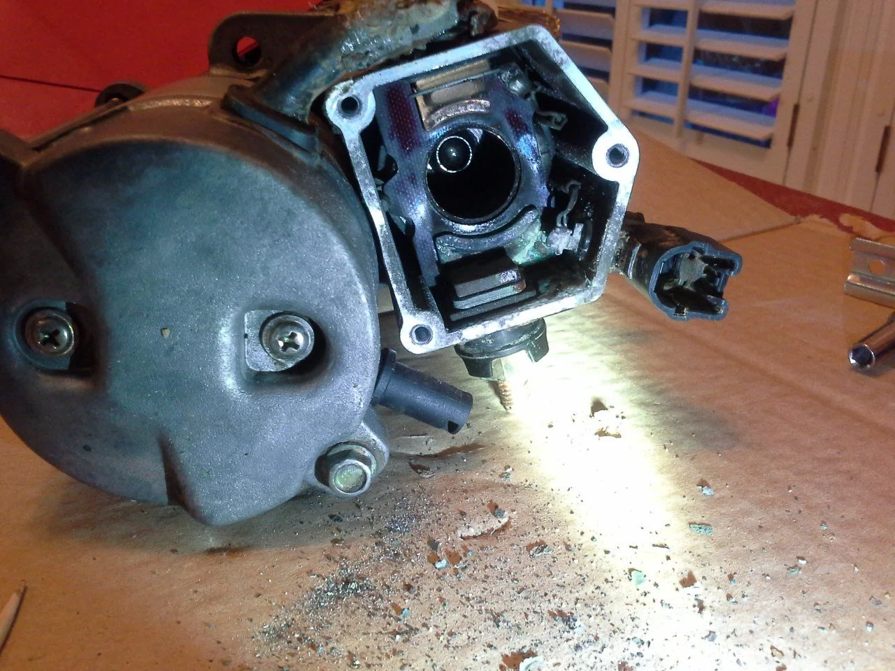

So it took me a half hour to clean it and now I have the cover off and this is what I found.

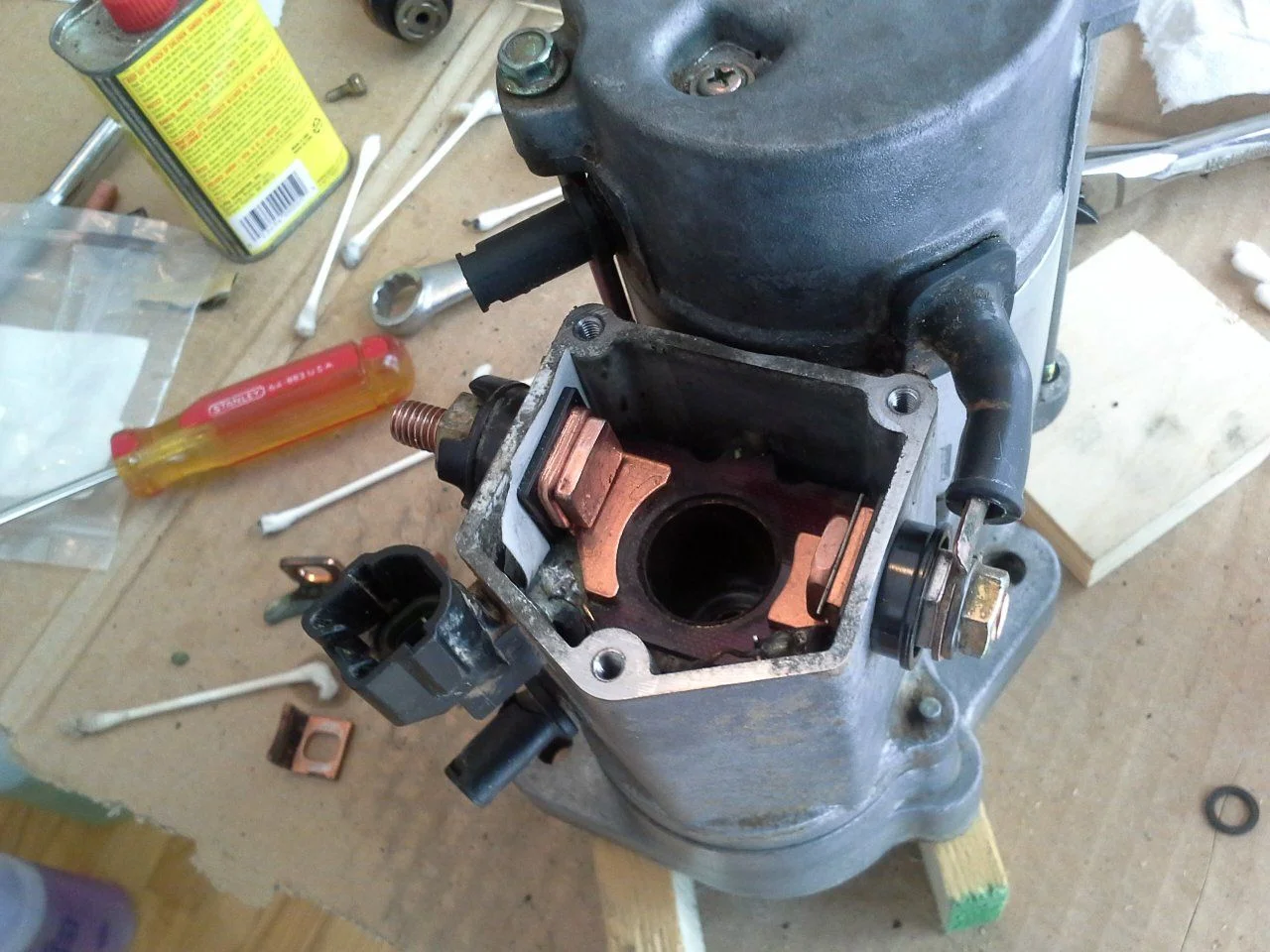

This is a tough one to deal with as the drain valve is broken. What should I use to repair, goop, rtv (what color)?
Ted, the drain valve is ribber, so I have to use goop or something flexible so it will still drain.
Andrew i'd coat it with some quality permatex RTV and let it ride. :beer:

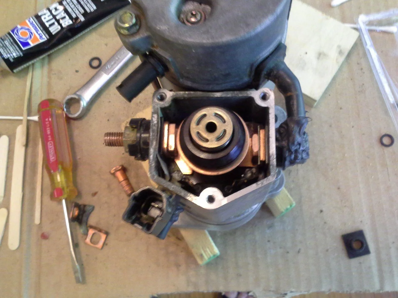

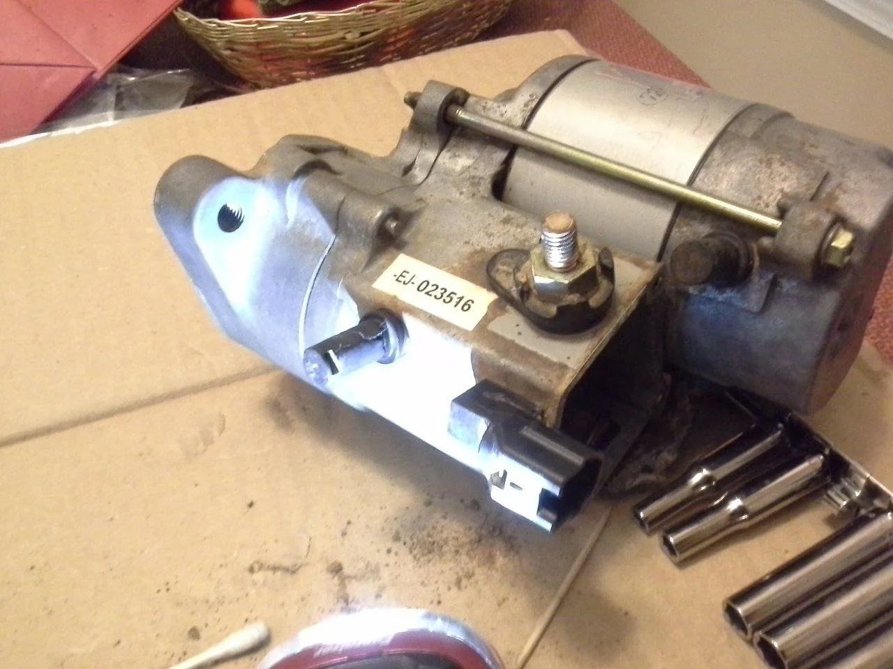

I think that is what I am going to do for a temporary solution. I am going to replace the starter contacts today, but the idiots that I ordered from in NC sent me starter contact kit for a previa van on one side and the correct one for my 4runner on the other side. :bang::bang::bang: I am going to have to recycle a few parts from the old one and just order a reman. starter from Toyota and replace it once and for all. THe Starter that is on it is a reman from Toyota.
Gotta love being able to multitask and improvising. Here is some progress. Note uncured goop on the other contact on the outside.
