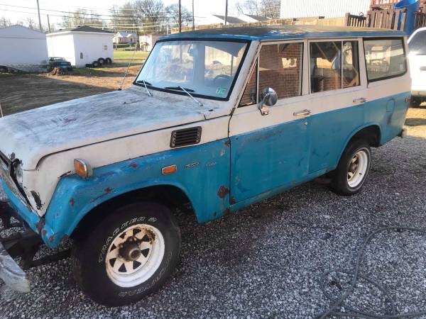

If someone is interested, my 55 could be purchased. I’m facing reality that it’s not gonna be done anytime soon.
It’s actually what got Greg Thompson and I talking and Cottonland started.
PM me if your interested.
I didn't know you had a 55...
Buggy... ✔
40... ✔
Badass 4Runner... ✔
But guess I missed the 55
Buggy... ✔
40... ✔
Badass 4Runner... ✔
No kids, lots of toys....
55, 40, buggy, buggy, Sami....
My toy box rocks but about to thin heard and just simplify things. Cruisers ain’t being driven and 55 ain’t gonna get finished anytime soon.
Pics man! We want pics! :flipoff2:
