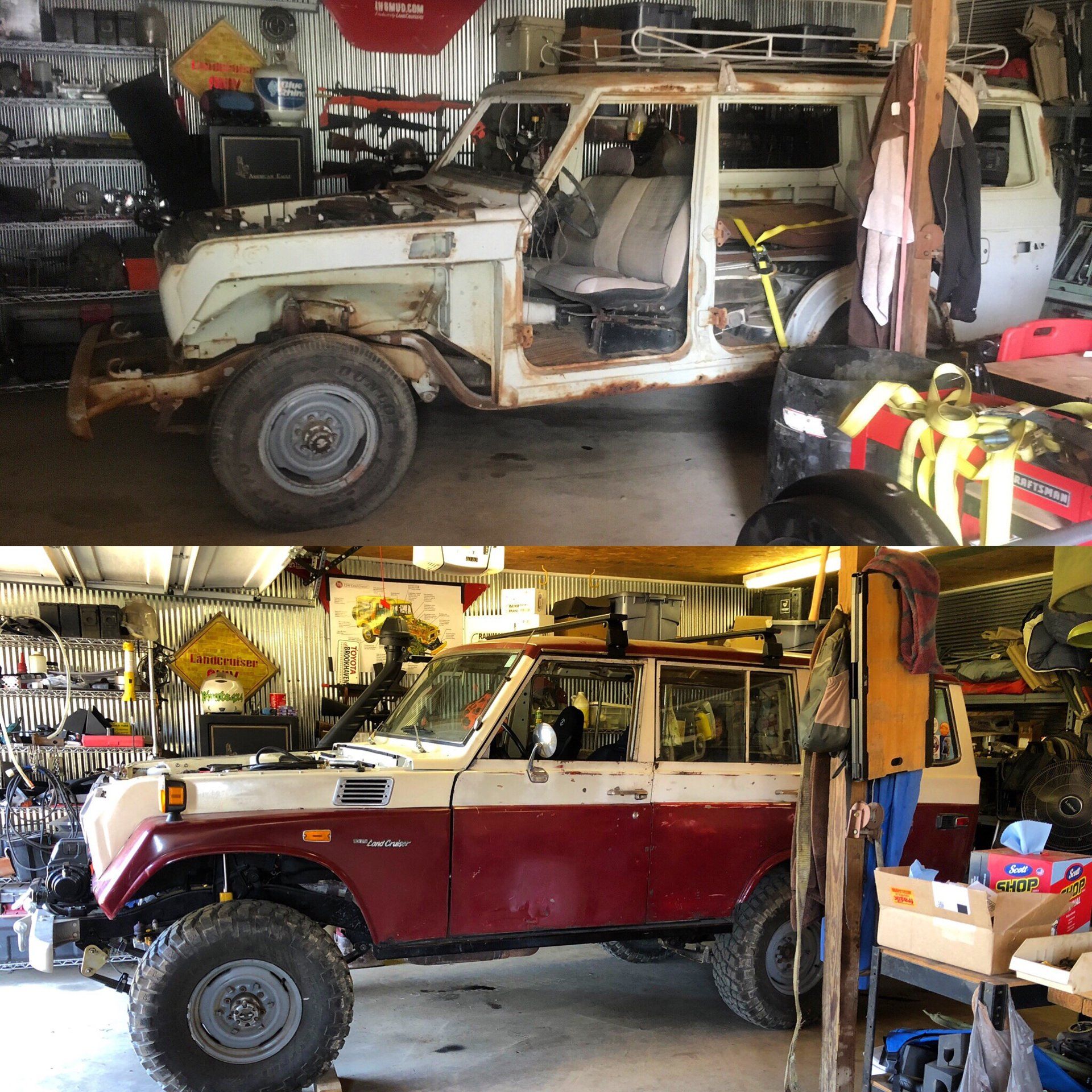

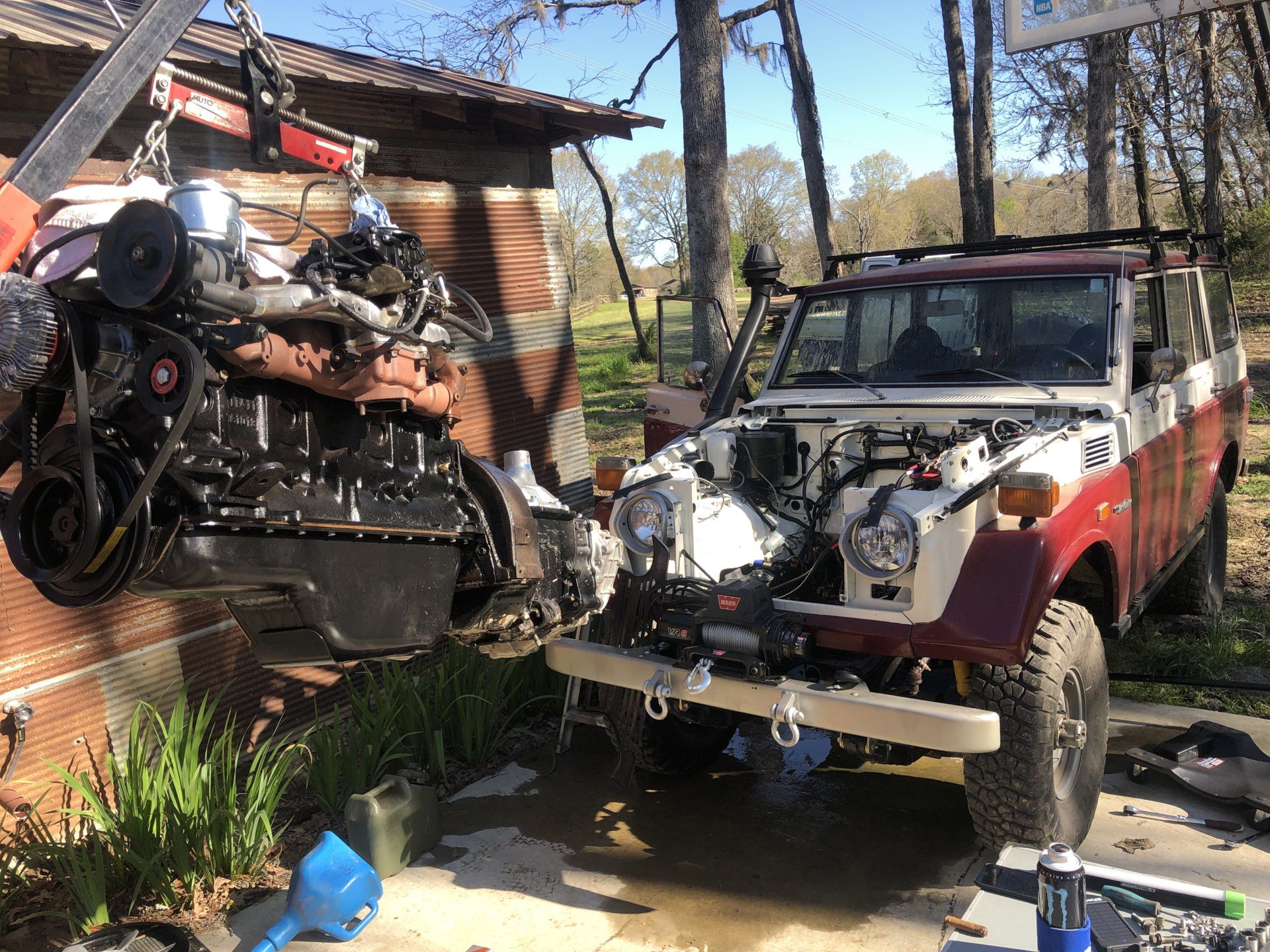

U-joints suck... 1 down, 1 to go, then I can see if this clutch job was a success.
Backed out of the garage and to the end of the driveway and back under its own power!
Still lots of things to reconnect and I need to adjust the throw on the clutch, but it is mobile again. And we FINALLY got the title in hand, so off to get tags this week or next.
Baby steps.
Took a 2 mile round trip to church and back tonight. If the Speedo is right, got up to a whopping 40 mph.

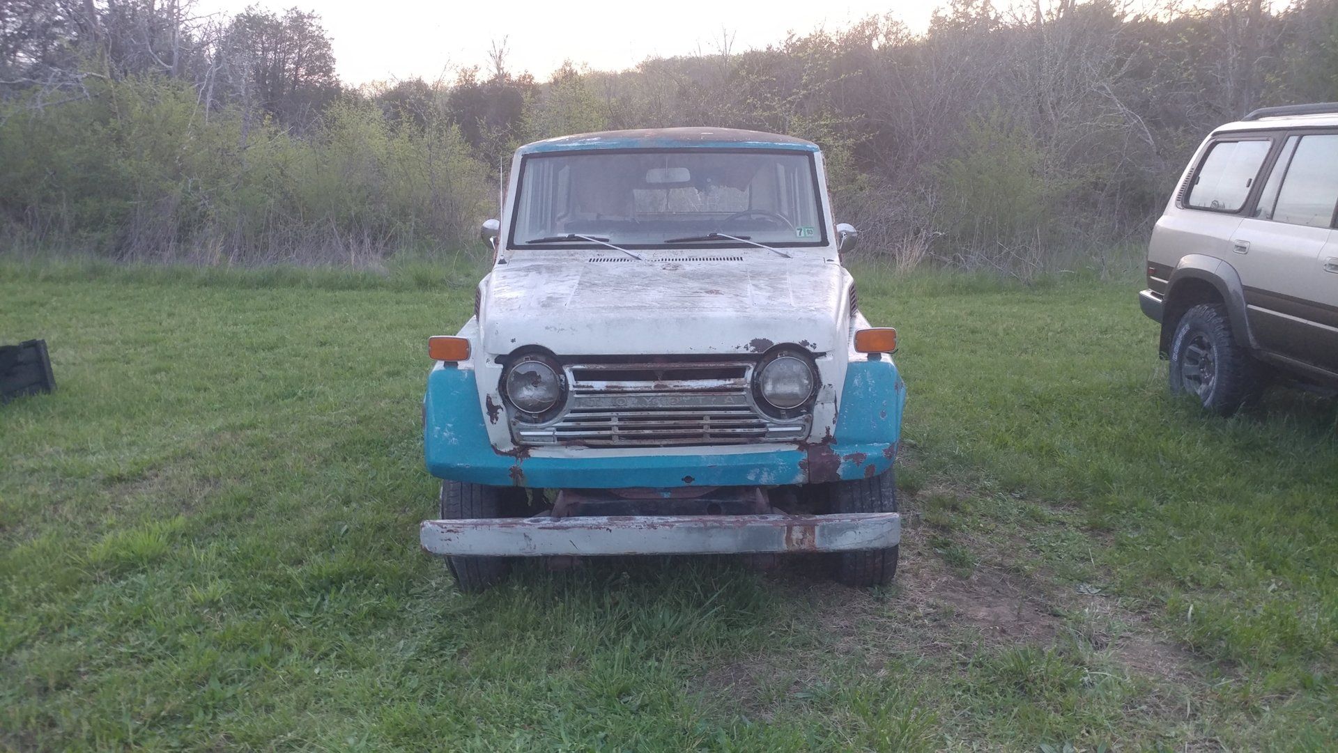

Might be adding a parts pig to the herd this afternoon.... :poof:
Stay tuned
Well, drug off the trailer and where it will live for now...
1971, no title, motor condition unknown, but it is all there. Only thing I noticed missing are the headlight trim rings. Still has the 3 on the tree.
