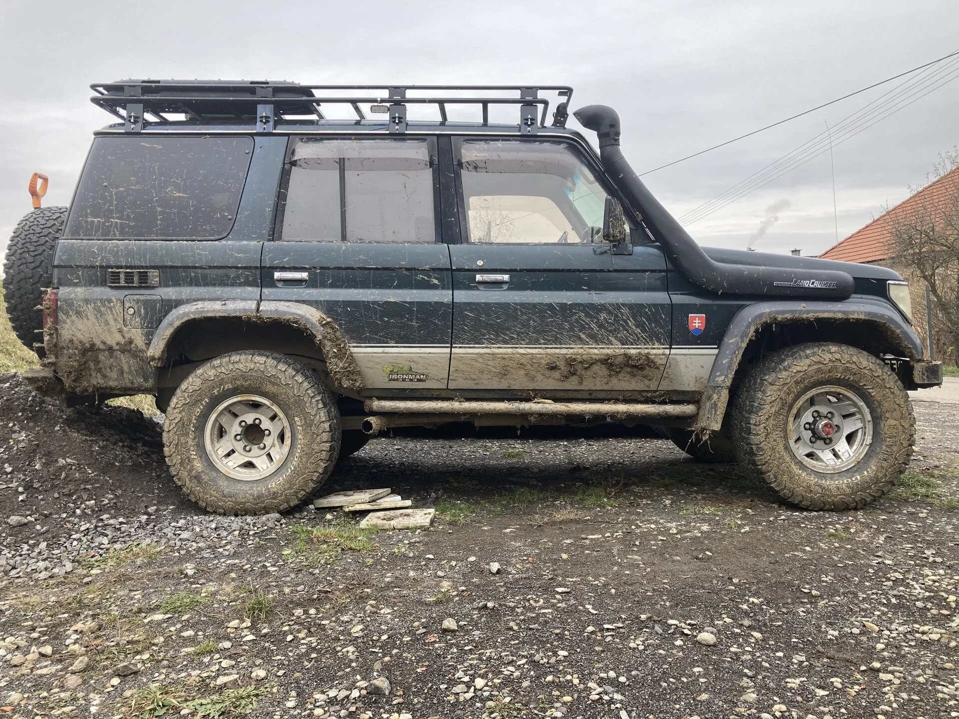

@MyCruiserisaHogBeastI thought hard about a Prado when I decided to get another 70. There were a lot of reasons why I opted to get back into an HD Cruiser, but one of the biggest was a lack of knowledge and support here in the states since they were just becoming available in the US.
Either way, here’s my BJ74 on 35x10.50s on FJ Cruiser Steelies with Spidertrax spacers with a 2” lift. You would need gears though, I drove a manual 1KZ rig and I wouldn’t want to kill the zippiness.
17" FJ Cruiser Steelies with Spidertrax spacers. Came together really nicely.@MyCruiserisaHogBeast
Are these 16 or 17" wheels?

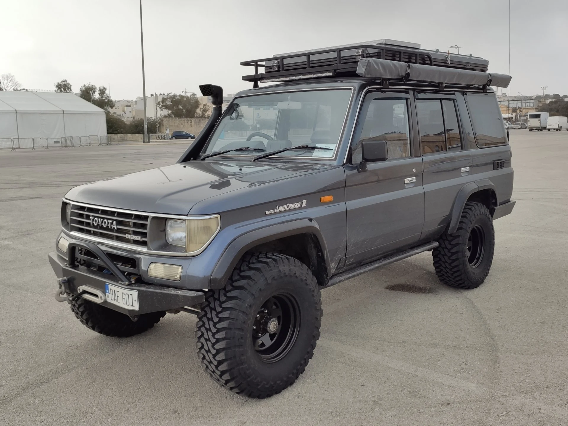

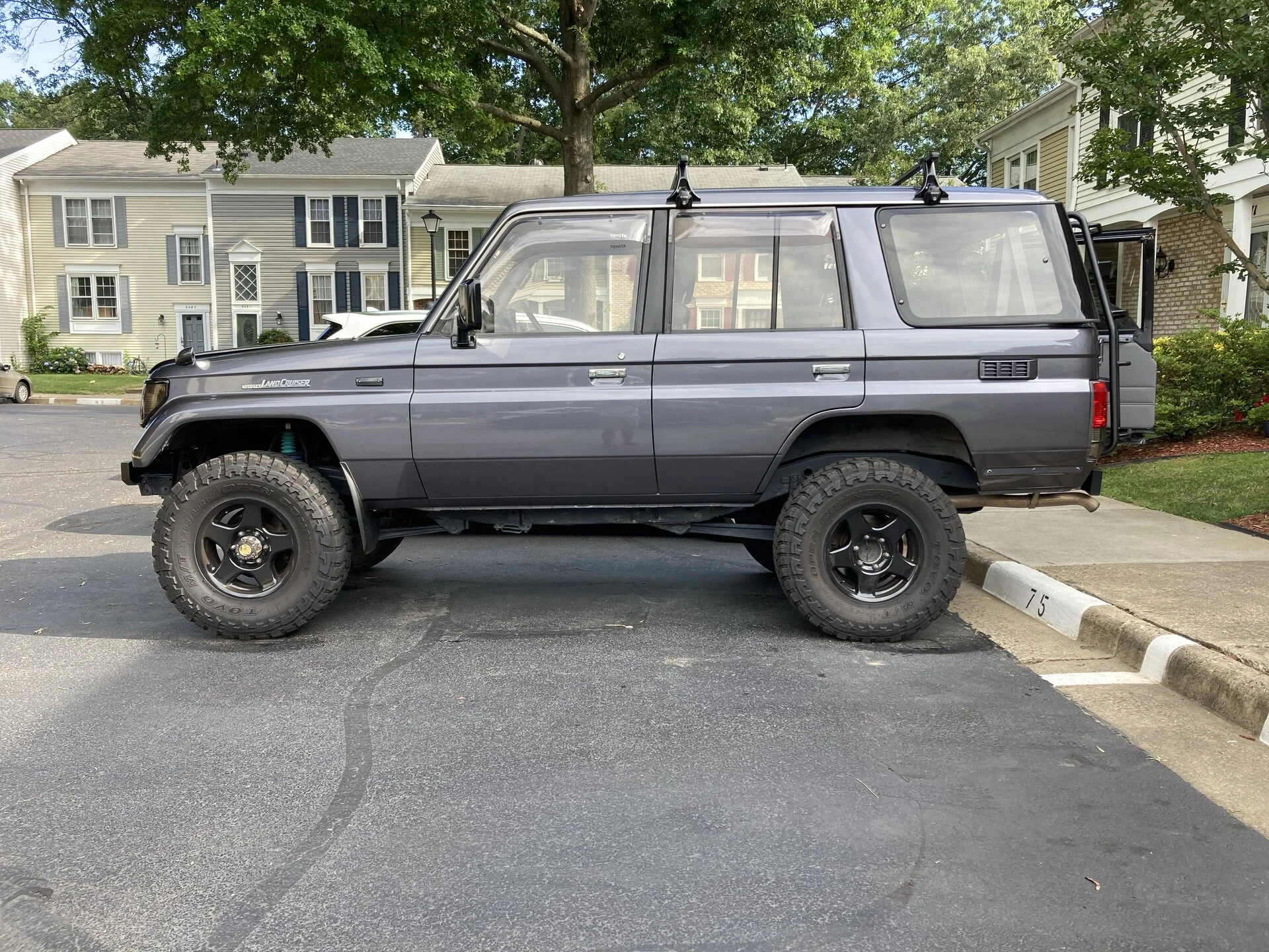

33s will probably fit on the factory suspension and wheels.Hey guys, if I want to run 33s on my lj78, would a dobinson's 1.75 inches lift do or I need to get 2.5 ? Also, do I need to switch to negative offset Wheels to prevent tire rub ? Thanks in advance
Amazing thank you. I was planning on getting a 1.75" from dobinson's anyway. Also planning on getting a bit wider wheels because I feel it would give me more tire options. You think I should go for negative offset to ensure the callipers are cleared ? I'm scared the tire would stick out too far from the car. Mine doesn't. Have fender flares.Skinny 33’s should fit without upgrade. Factory wheels are zero offset, but also have a deep well around the hub face to clear the caliper. Some generic steel wheels don’t work because they interfere with the front brake calipers.

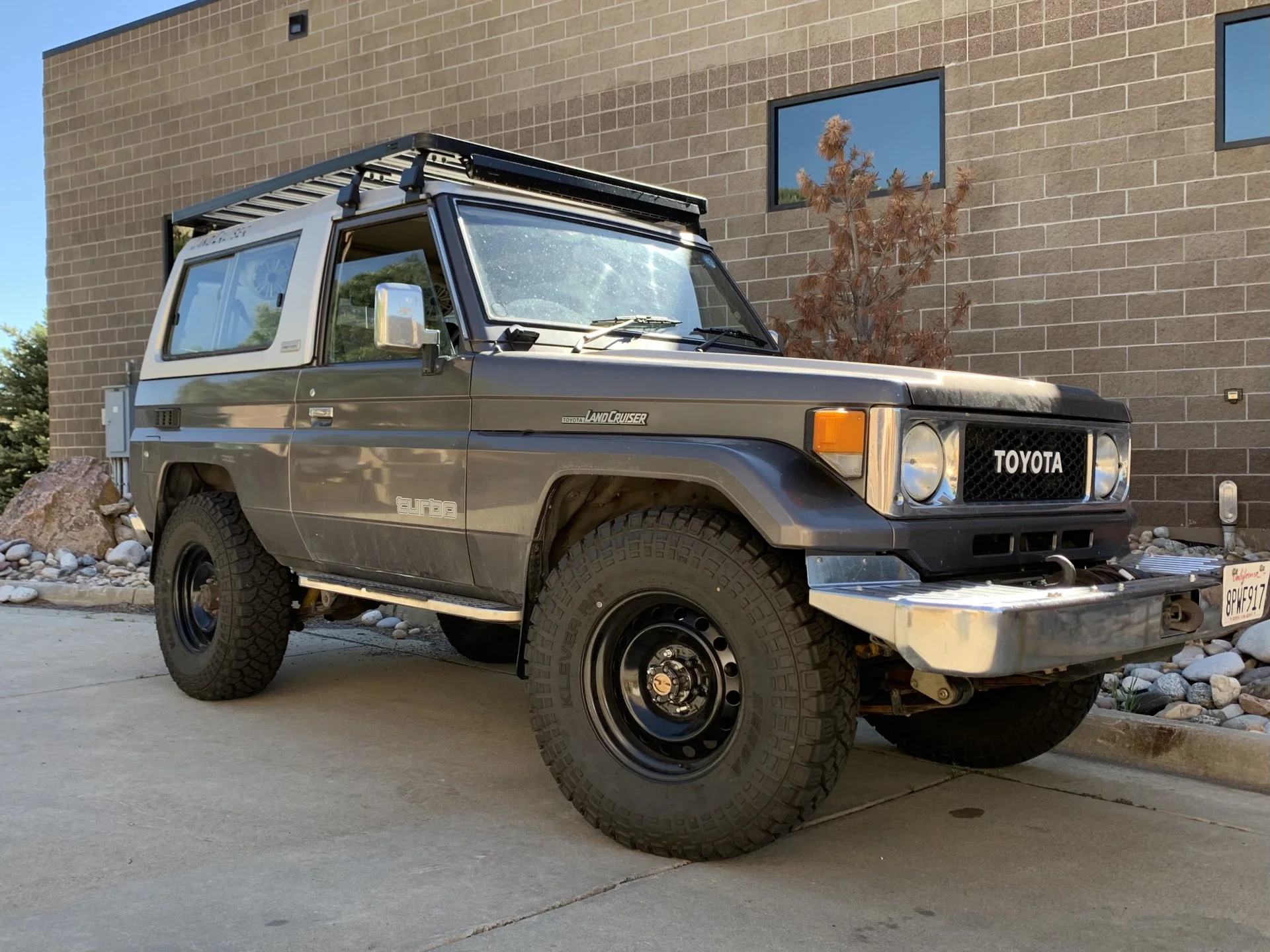

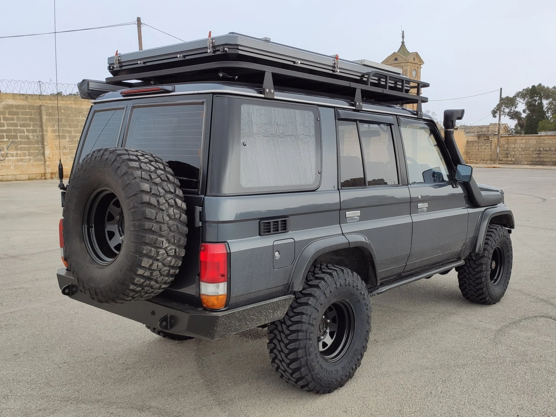

cross bars?View attachment 3490768
Unknown lift height, assuming 3” to 3.5”. Wheels are Bradley V 16” -21 offset with 33.5x10.5 Toyo M/T.
Yes the crossbars sorry I thought I typed it originallyLoving the rig, can you point me in the direction of your rooftop
cross bars?
They are Inno brand, came with the vehicle. From what I can tell they are 7" risers with a 58" crossbar.Yes the crossbars sorry I thought I typed it originally

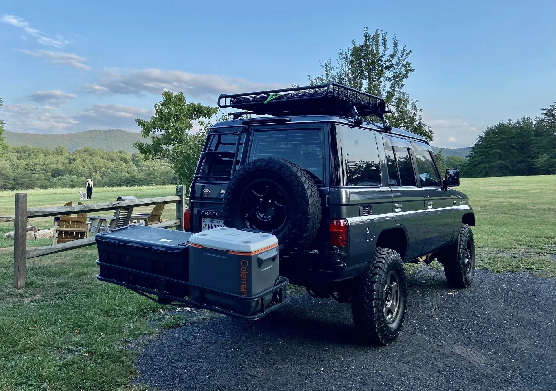

my setup is 2” lift and 33x12.5x15 BFG KO2. But the next ones will be 11.5 or 10.5View attachment 3494272View attachment 3494273
do your tires rub with this setup?my setup is 2” lift and 33x12.5x15 BFG KO2. But the next ones will be 11.5 or 10.5View attachment 3494272View attachment 3494273

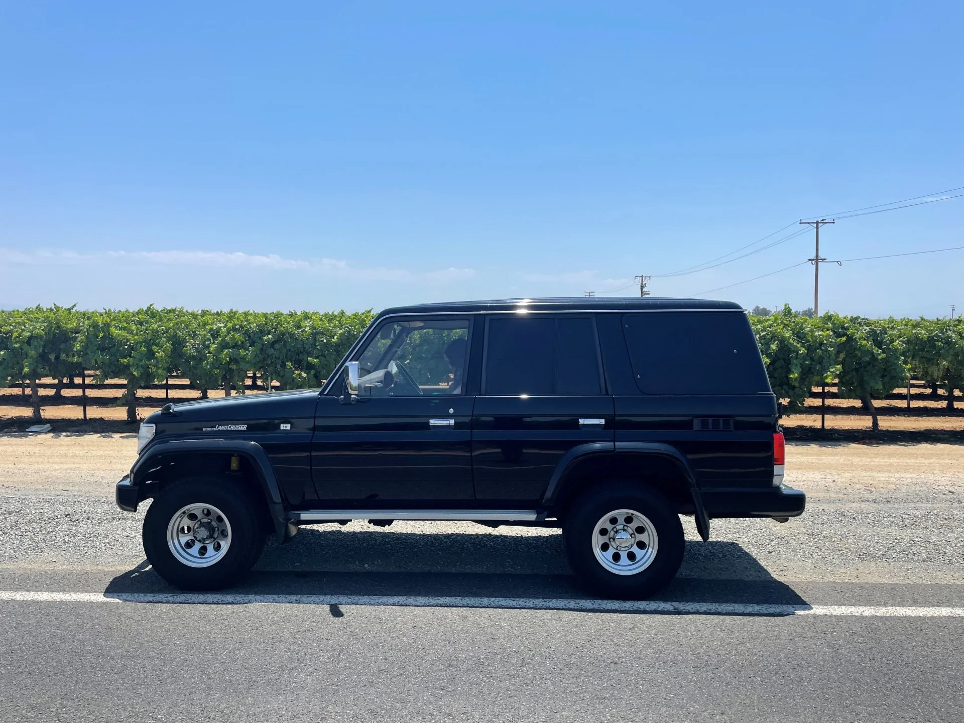

1994 KZJ78; 2" lift from Dobinsons; 31x10.5R15 Bridgestone Dueler A/T on MT Classic ii wheels. I am not sure on the offset
Hey bro! That’s the set up that I want. I’m currently running stock wheels/tires same size as yours. I’m planning to do 2” lift with dobinsons. Can you send me more pictures of you LC? Also besides the 2” lift from dobinson did you adjust /buy more parts? Thanks bro.1994 KZJ78; 2" lift from Dobinsons; 31x10.5R15 Bridgestone Dueler A/T on MT Classic ii wheels. I am not sure on the offset
