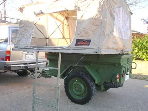

DieselB - forgive the newbie question - However, what wheels are those?? I'm looking into the SOA hub swap route for my M101 and those look like what I'm looking for.
TIA
I'm running 35" MTR's on 15x8 - 3.5" BS black rockcrawler wheels. I did the hub swap to 6x5.5 Cruiser bolt pattern

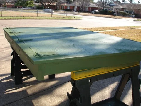

I'd like to revive this thread, as this is where it all started for several of us on the Trailer Tech forum. Any new ideas for your tent setups? I am working to get mine completed in the next 7-10 days. Here is the rough draft of where I am so far...
I have finished with the hinges and the deck, and I need to finish sealing and painting the deck prior to installing the lock hardware and tent (although I temporarily put it on for the attached pics). I am really looking forward to my first outing with this thing.

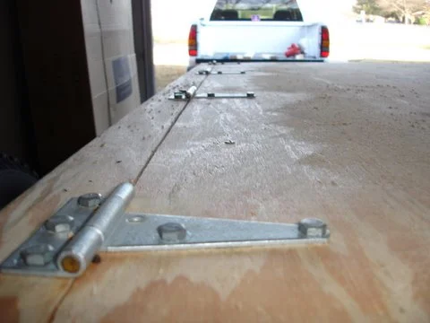

ever shoot any pics of the wood sealed? also how did you mount the wood top to the trailer?

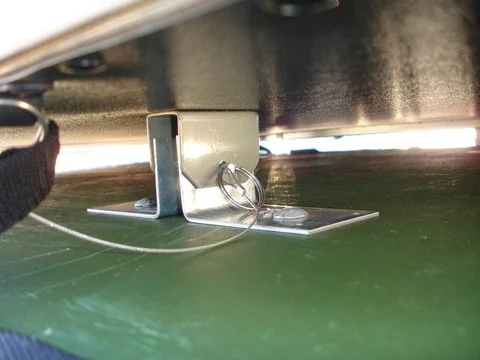

I don't think I have any pics of the wood sealed prior to painting. Here are a few shots of how the rest of it worked. I ran galvanized screws deep into the 2x6s for hinge support. The lid is solid as a rock now. I also reinforced it underneath with steel studs, galvanized carriage bolts which also double as a supprt for the brackets that hold the tent.
