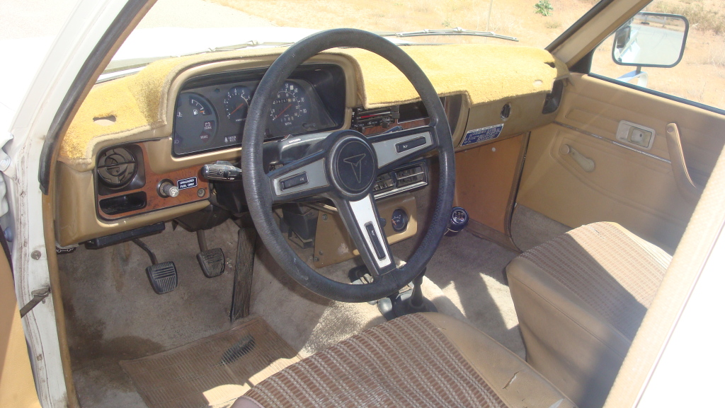

Added a pic. Swapped my stock wheel for a mini truck wheel after installing power steering. Paid $15 for the wheel at a pick and pull. As with the FJ60 wheel, only mod necessary was to set in the turn signal return pins.
Made the change to create some room behind the wheel and underneath between the F150 captains chairs. School bus wheel became unnecessary after adding mini-truck power steering. Love the look (OEM almost), feel and extra room. FJ60 console fits perfectly in between the seats. Before anyone asks, that's a modified t-case lever to the left of the shifter. It's for the Ranger overdrive. Couldn't bring myself to use the big chrome lever.
