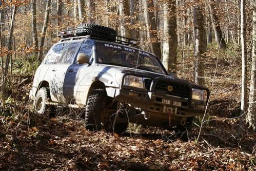

255/85 r 16s on 100s - Thoughts?
Guys,
Please post up your or any pictures of 255/85 r 16s on 100s. Also, any comments on this size tire on a non lifted 100.
Thanks,
uzj100
bfg km
4'' backspacing wheels
I think it a 33.4'' size and a 285/75/16 is 32.8'' but not sure

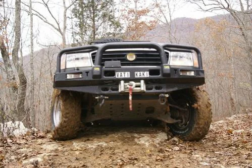

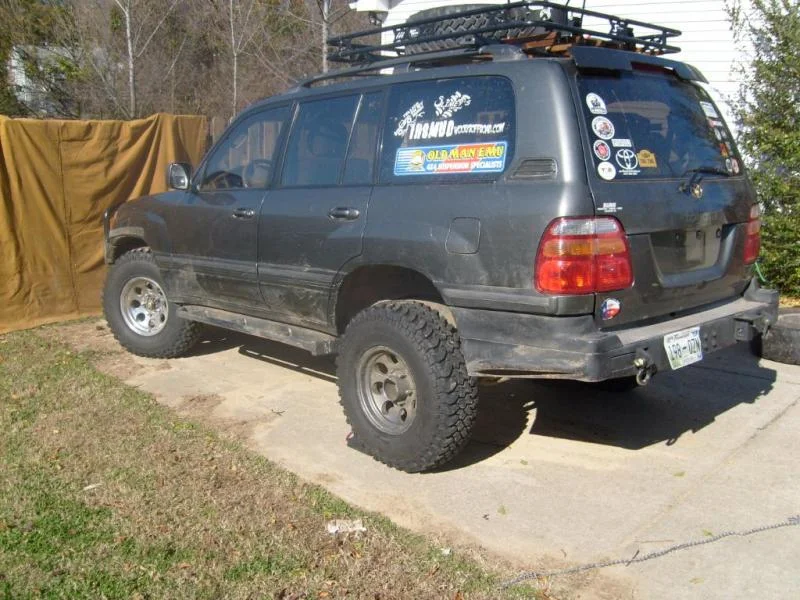

I have a few pictures on here... great size as I have said many times before.

Simply because it would just be exhausting to do the close to 10,000 miles we did on-road.
The 285 BFG ATs are just a far better behaving highway tire. And they're a pretty damn good offroad tire as well.
The 255s are the better offroad tire IMO, but what your highway<-> offroad driving distribution is -- and what the offroad conditions you commonly encounter are -- will determine which is the better size for you.
255's on my 80 at highway speed they tend to drift requiring both hands on the wheel were as the 285's on the 100 behave alot better.. one hand steering...I'm running remington mud brute on the 80 some road noise but I like them...
So are you saying the 285's are a better on highway tire because they are All Terrains as opposed to Mud Terrains - or because they are a wider tire at 285?
Just to clarify - in your pics the KM2's are 255/85/16's?
OK thanks for clarifying for me. I have 255/75/17 MT's on my 4Runner and have noticed many of the same things you have. For me, I really noticed the difference of the skinny tires on smooth graded dirt roads where you have a long sweeper turn taken at 25mph to 25mph. I've found the 255's feel far more unstable in this type of turn - the whole vehicle feels as if it wants to break loose and almost slide to the outside.
