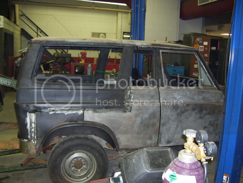

Sectioning the rear to eliminate the rear doors and the overhang is easy enough. Just don't think in terms of one section. I did mine in three. from a line Just above the wheel wells I cut 21' from the rear overhang. From that line to the roof line I took from the rear door. It left the rear door fixed window almost perfectly. I drilled loose the roof and took the area with the most rust.

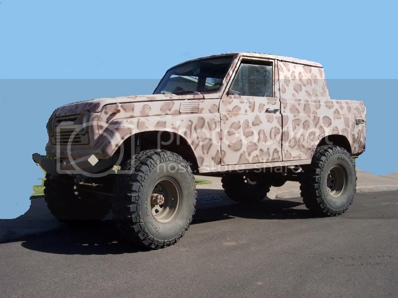

Not sure if this is what you meant or not.
That looks pretty cool, but if you think bottom door hinge mounts are a problem now :eek:
that looks great troll. now if you put that small window behind the door i think it'll be pretty spot on. i dont think i'm gonna push the axle back that far but it does give a good perspective with the angle of the pic. also i am going to have new glass cut for the doors so they will be one piece.
