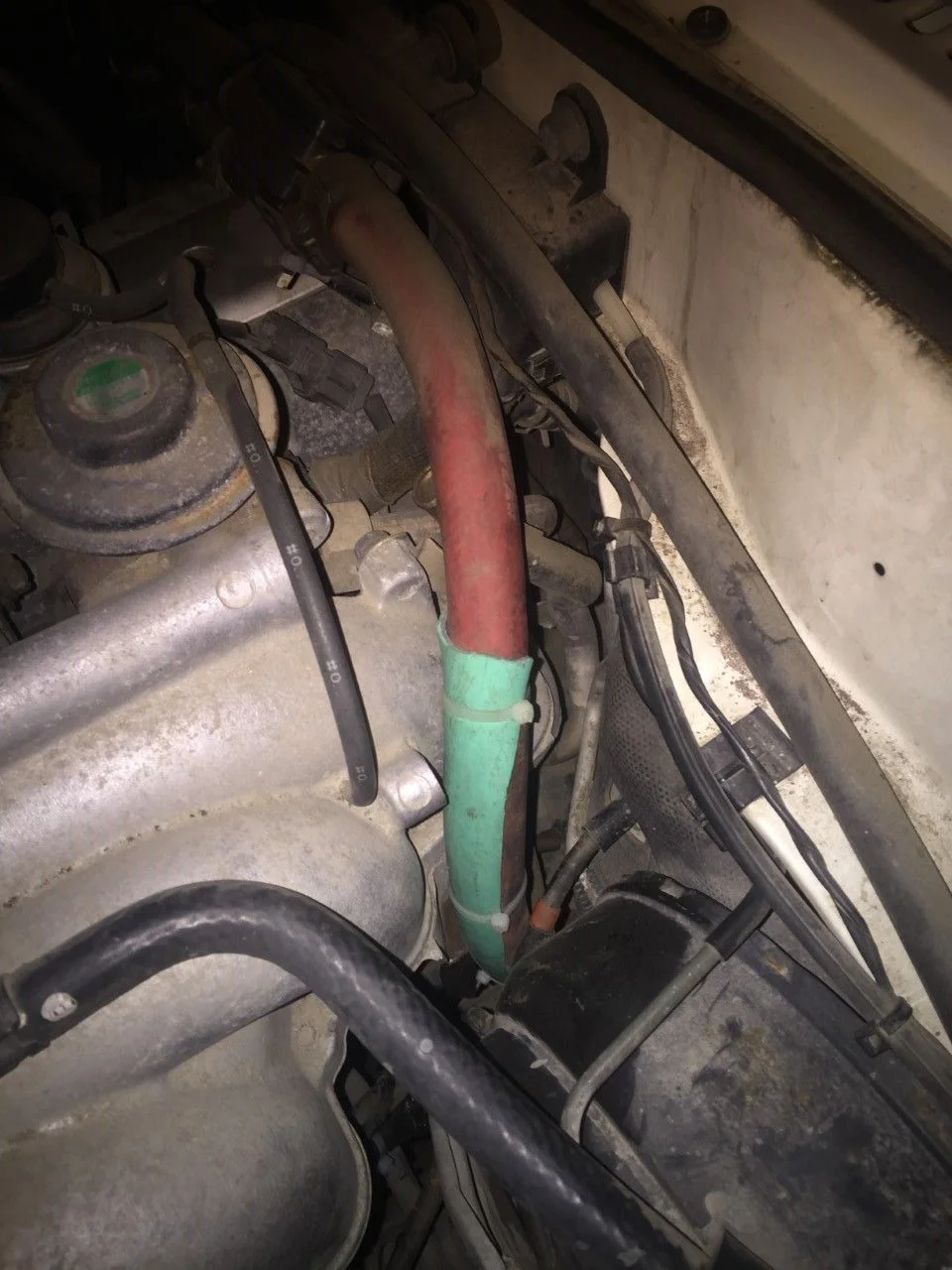

The 40th started leaking a week ago with 199,200 miles. I changed it out in about 2 hours thanks to info on here. Actually did the bypass and was very simple. Did a full coolant change, fan clutch, and hoses change at the same time.
Now on my 80 the PHH is bulging and about to fail (see pic) so next week it gets the same treatment. It has 199,800 miles on it.
