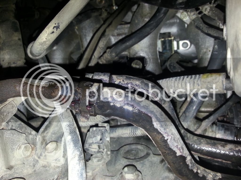

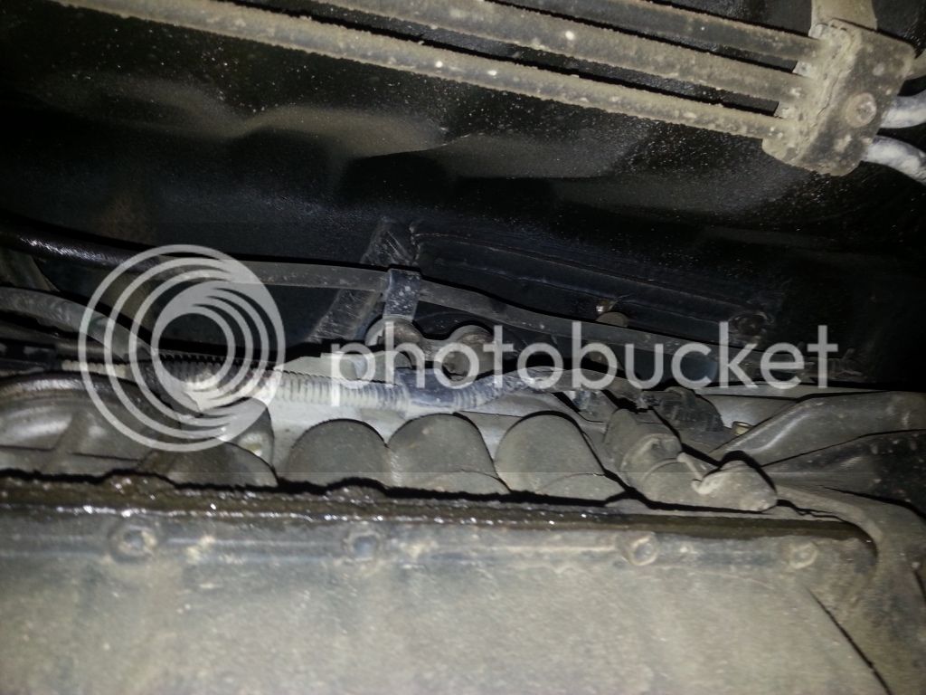

Coming back from Sean's yesterday I noticed that the temps were a bit higher on the Scangauge. Avg temps have been 191-195. Yesterday the temp was around 198-202. I thought maybe it was the hot a$$ weather causing the higher than normal temps. Once I got home noticed a small puddle of pink/red stuff under rig so I crawled under the rig and noticed this:
I checked oil and it looks normal. Checked radiator and its seems full. Resovoir is empty need to check for leak there. Rig is running good but evidence of leakage is on driver side. I read Slee PHH page and for whatever reason I can not locate the PHH. Have not removed tire yet to really take a good look but that is next.
I have a new PHH that I have been meaning to tackle but hear horror stories.
Any advice will be greatly appreciated.
Pull your wheel and you'll see it. If/when you do tackle this, remove the knock sensor down there first so you don't break it!

Hard to see but it's above or behind the starter on the DS. Remove the wheel and you should be able to see it.
If you do change it, do the fuel filter and starter contacts while you're in there.

This past Saturday I went over to TJ's place for PHH, starter contact and fuel filter replacement. Thanks to TJ's skills all went well. The PHH removed did not look bad.
On the way home the temps held to avg 193. Then I noticed the temps climb on the scangauge to 202. "Oh crap" I turned the heater on and rolled down the windows to help cool the engine. When I got to my destination I looked under the rig and more fluid leaking :frown:. Since I had some coolant I refilled the resi since it was now empty.
I have been climbing under the rig each day since trying to find the source of the leak. Yesterday I drove the 80 to pick up the kids from school. This time the temps stayed between 190 - 193. Cooler than my pre-PHH avg. Also noticed resi was still at fill line but more leakage. It's not drips but a steady pour for a bit when stopped.

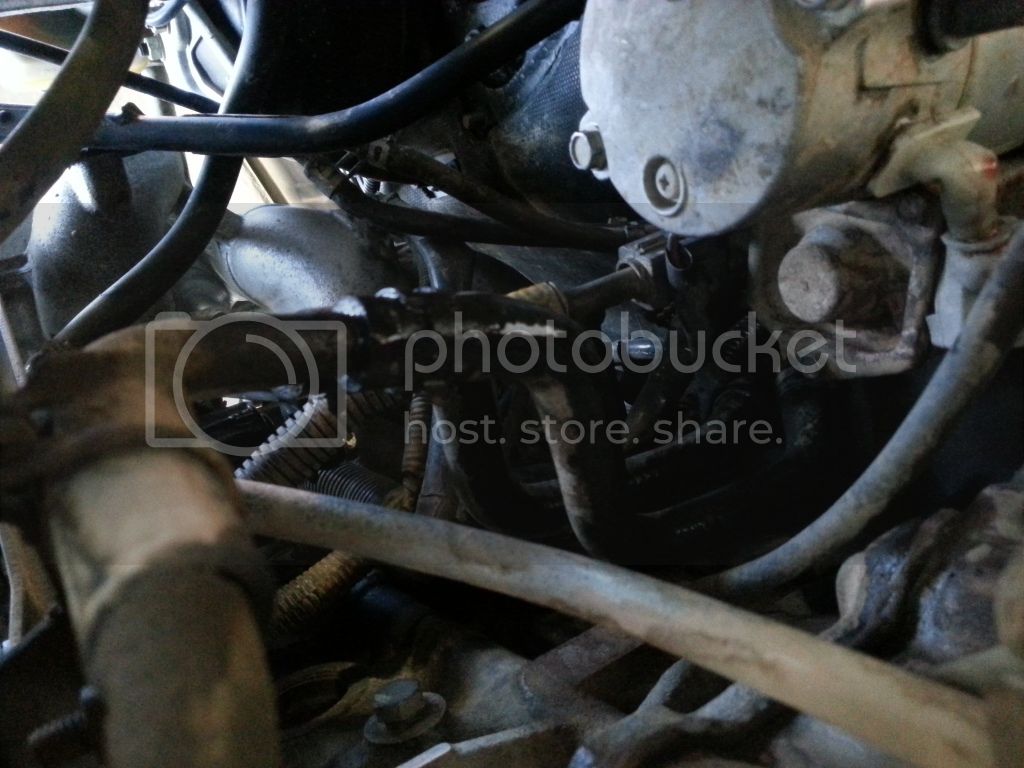

When I got home I climbed under the rig again since the leakage was fresh. Took some pics:
You can see some of the fresh coolant on starter and hoses:

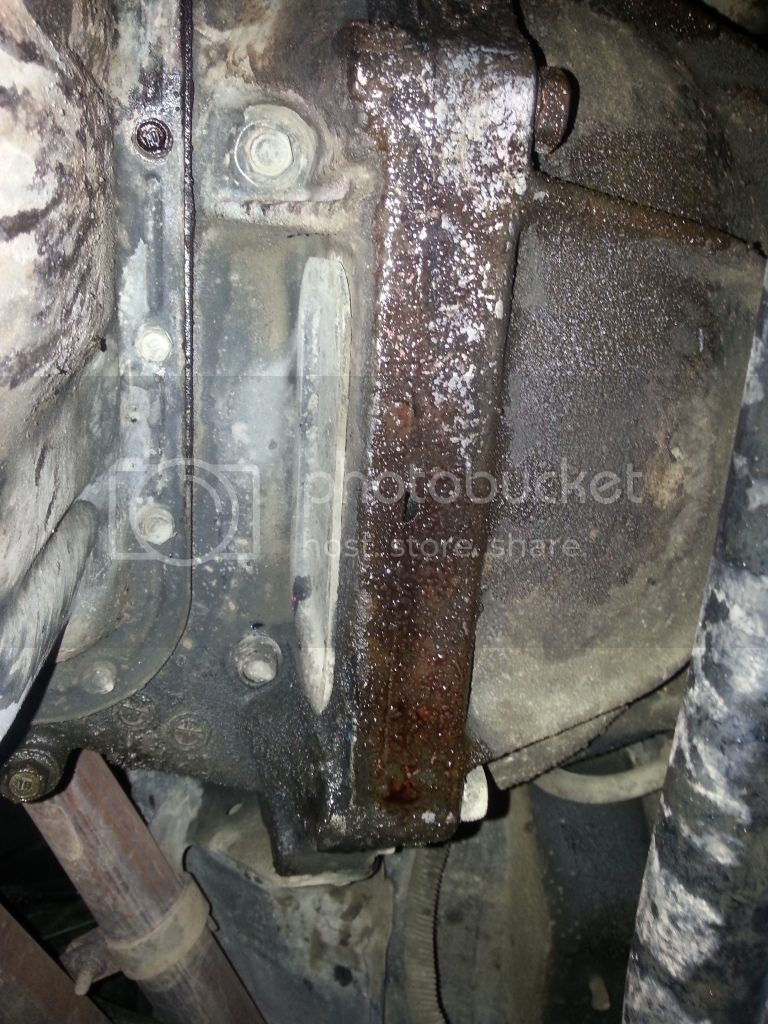

Looking from rear, you can see more fresh coolant on sway:
Then I noticed more drops further back near cross member closer to passenger side:

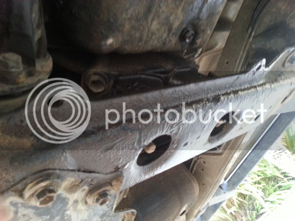

Cross member soaked
Could it be the rear heater lines? Going to climb under to see if I can find those damn heater lines when I get home from work.

I think I might have narrowed down the culprit or one of them...
Is this bypass hose #1 that I have been reading about? Or is this the tranny cooling line? If so, might explain the last few pics.

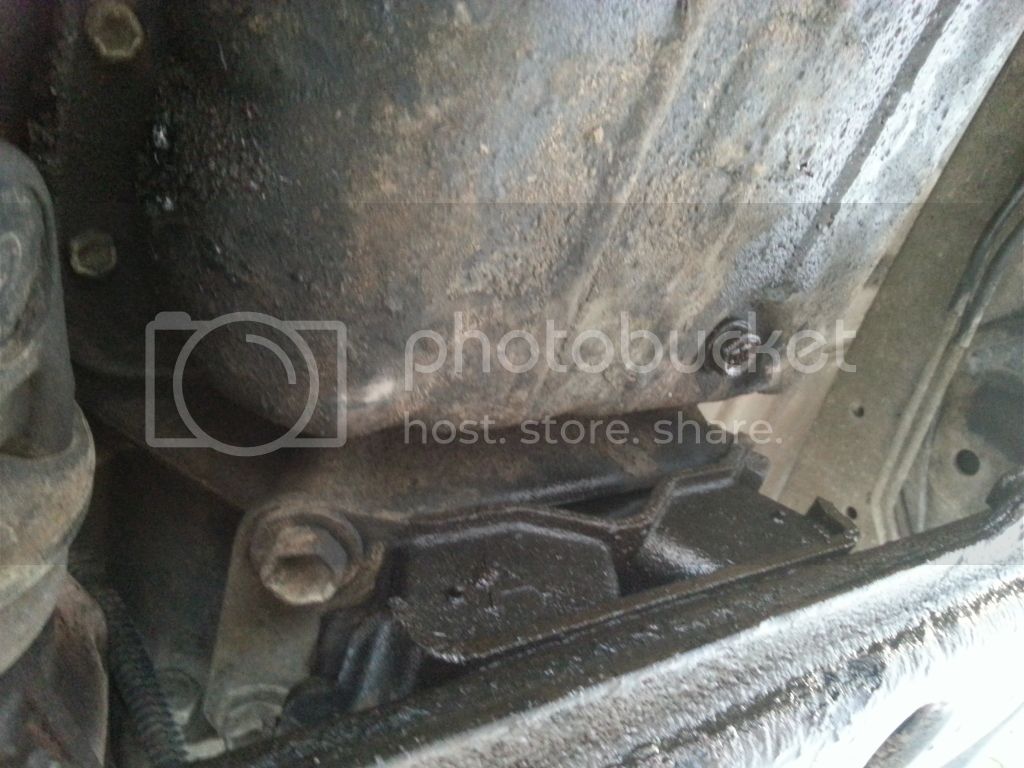

Noticed this yesterday:
Seems a little wet where near the bolts.

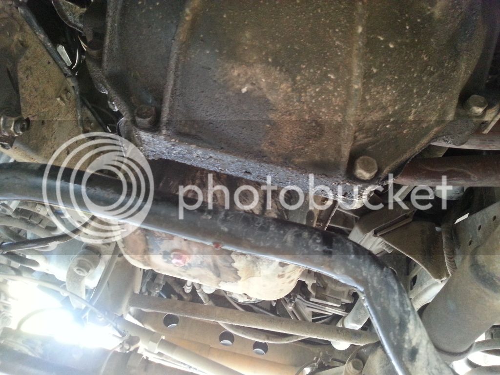

This one as well:
Same as yesterday, the cross member is soaked.
Are the leaky hoses letting that much fluid out that it's getting all over the place or I may have multiple leaks :crybaby:
Hard to tell with everything soaked like that. Can you get the underside steam cleaned so you can tell exactly where the leaks are coming from. Fluids often get blown around and get all over the place and it's hard to tell where the leak is exactly.
Check the bottom seam on your radiator. I had the bottom seam go on one of my radiators and it blew coolant all over the bottom like yours.
You may need to take the fan shroud off to get a good look. Inspect the entire radiator for any cracks or pinholes.

looks like its bypass hose #1 causing havoc.
