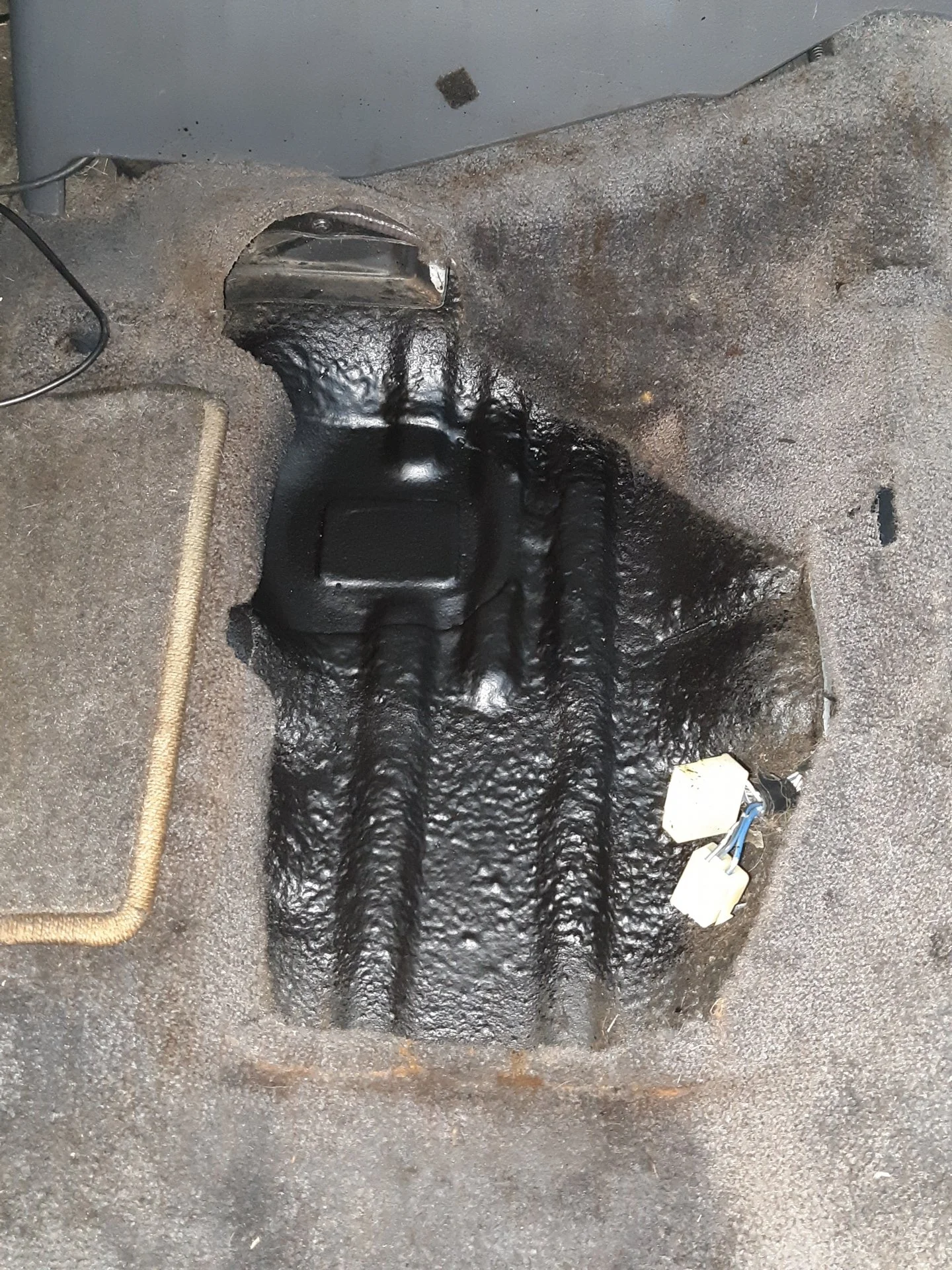

I have a new question for anyone who knows, since I'm going to have the cylinder head off, Is it possible to replace the rear heater hoses/pipes at that time? It would be nice to have it functional again. Or is dropping the transmission the only way to replace them?
IMO, the rear heater was either a marketing request for the North American market or just an after-thought. Not part of the original design. The fact is that a failure there while wheeling is catastrophic...and easily avoidable.
Personally, I delete it quite some time ago as many other members before me.
My two cents: what you perhaps might loose in convenience you’ll gain it in peace of mind.
Cheers!
Second opinion for deleting. I couldn't get it out without cutting with head and exhaust removed. Lots more room for activities.
Cheers!
That's a good point.
I removed my rear heater from under the seat/blocked off the opening. Bypassed the hoses of course. Never used it nor felt I needed it.

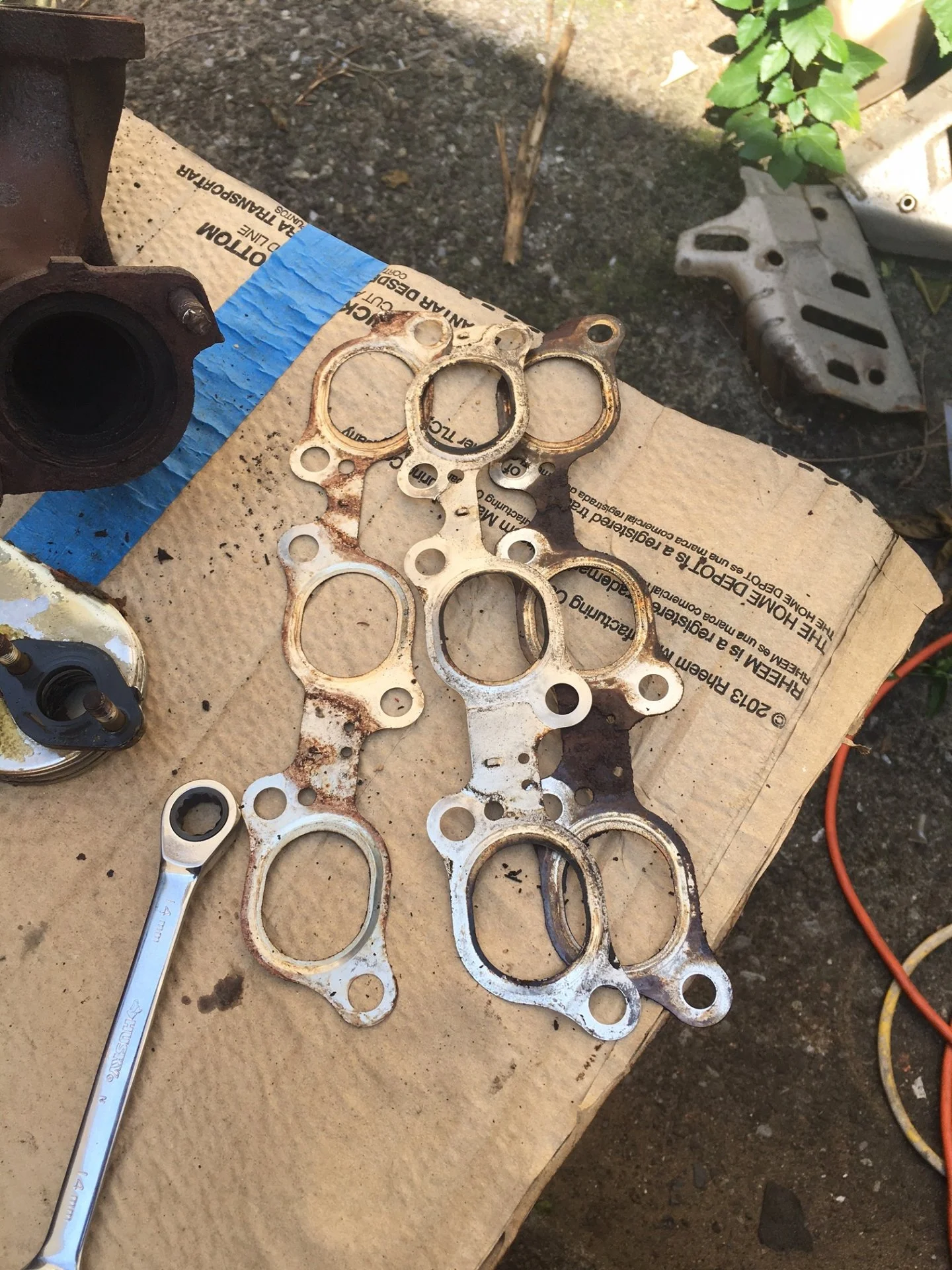

Finally made some progress after the third rainiest July in the Albany NY region. Got one exhaust manifold off, is it normal to have three gaskets ??

Finally made some progress after the third rainiest July in the Albany NY region. Got one exhaust manifold off, is it normal to have three gaskets ??View attachment 2751787
Most exhaust gaskets I am familiar with are multi layer, its common for them to delaminate on removal, especially after a number of years in service.
