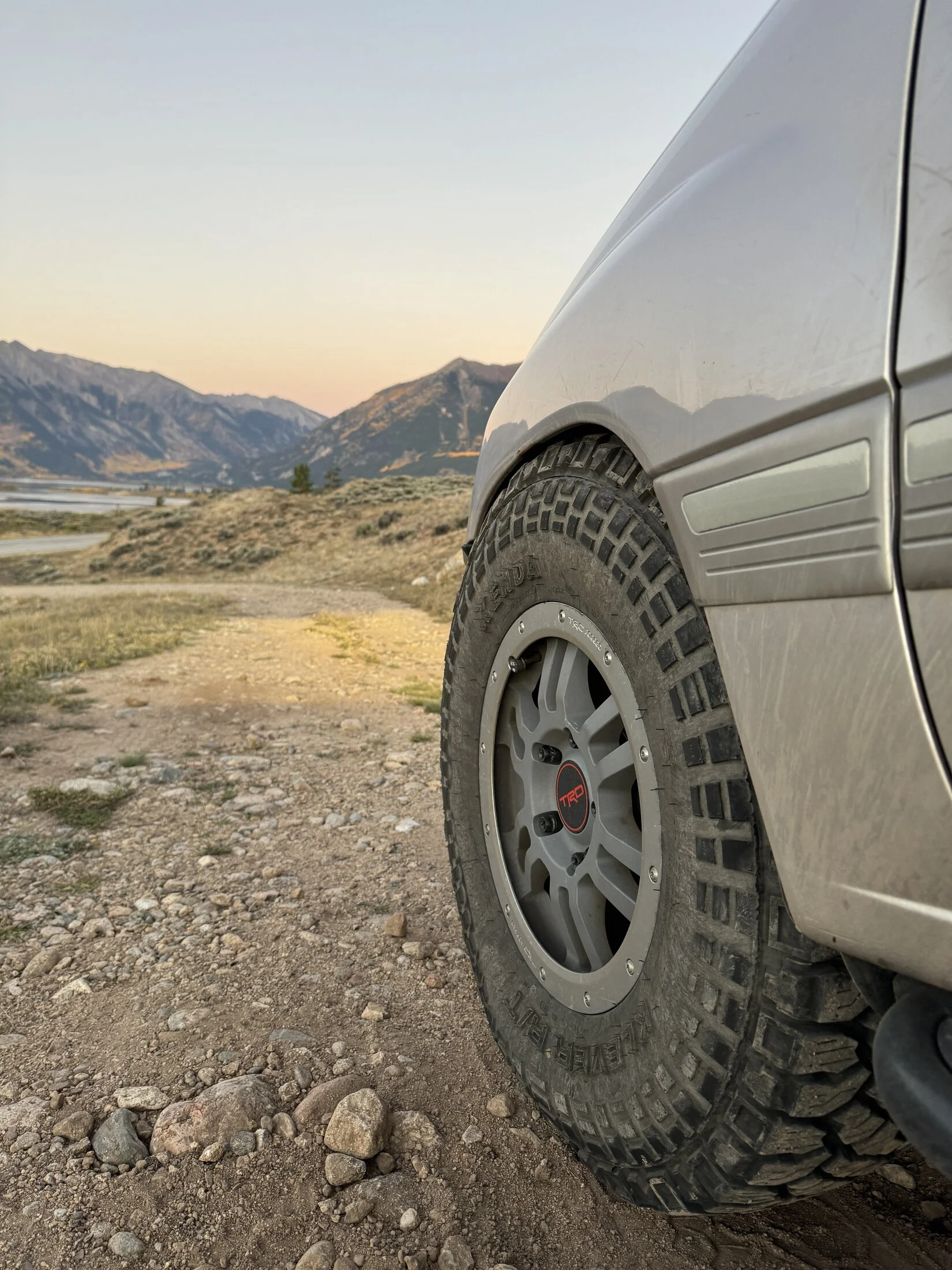

I have the @TRAIL TAILOR 1" body lift sitting in my garage already - so I will eventually tackle that. For now though, I purchased, received and installed my new Evo Corse 17x8.5 et40 wheels and the change from a 17x8.5 et0 (Kansei wheels that were on the truck for my trip to Texas) to the new ones with the 40 less offset has eliminated all rub.
Drove into work today and took a corner with a big drooping bump faster than normal and didn't hear any rub. Pretty stoked, I have an appt with Slee on the 16th to install HD springs for the added weight out back and in prep for an additional long range fuel tank - but otherwise, I am in maintenance mode from here on out (with the exception of snow tire setup incoming this December).
The 35's have created new stress on my front suspension components (new rattles/clunking) so I need to investigate that, but my rig is very close to being done with the additions and moving on to keep it on the road chapter. Feels good, thanks mud for the help.
Solid. ET40 is the way. Aggressive yet minimal poke and rub. Nice.

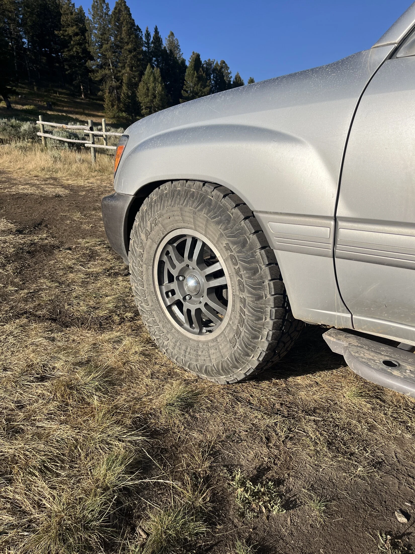

I'm on +31 with 35x11.50's (spec is 34.5x11.3"). I have a 1/2" BL, 3/4" sensor lift and the pinch welds are hammered flat. I get the smallest amount of rub at 12:00 but only when both sides fully bottom out.
I'm on +31 with 35x11.50's (spec is 34.5x11.3"). I have a 1/2" BL, 3/4" sensor lift and the pinch welds are hammered flat. I get the smallest amount of rub at 12:00 but only when both sides fully bottoms out.

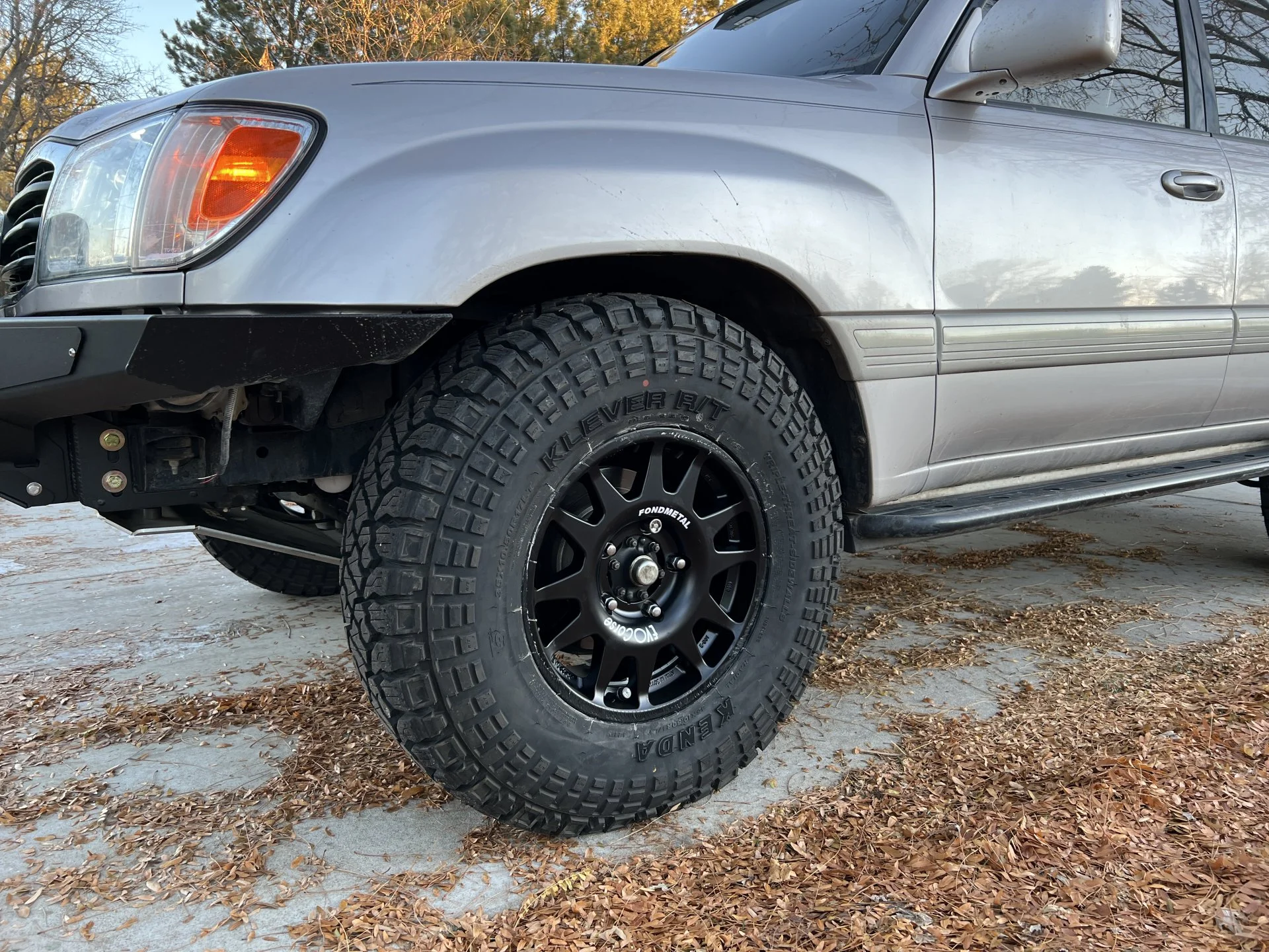

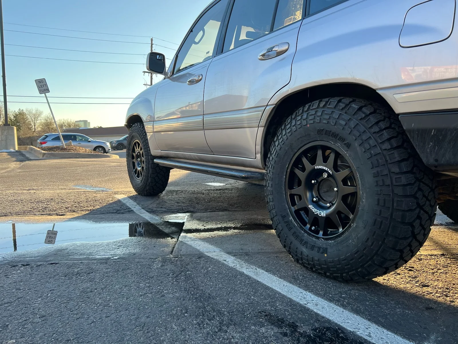

I'm really diggin' the Kenda Klever r/t 35x10.5. Finally got around to this project after having parts sitting around for a while.
They actually feel like they produce less scrub than the "smaller" 285/75R16 I was running. The stock 4.30 gearing is not too bad either, for now.
Still got a little rub on the liner, even after knocking everything back. Might have to add-in a little more castor to move the wheels centerline more forward.
Overall, I am very pleased with the results.
