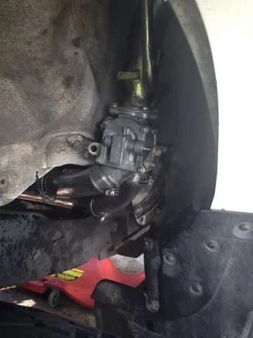

Just when I thought I was ready to install the tank and do some testing, I came across one of these in the classified:
A non US market dual filler neck. I don't know what I like better- the fact that I got a hold of one, or that I only paid $20 for it. I was going to just hide away a filler tube somewhere.
The modding for this will prolong the tank install, but worthwhile.

My progress is been slow lately because I've been focusing on family (well I guess that is progress) I've mostly been doing petty stuff like running Wires for fuel gauge sender, gauges etc.
But today I got my dual filler neck installed. Tomorrow I'm going to see if I can't get the tank installed so I can start testing.
I still need to figure out some mechanism to actuate the valve, but that'll be easy.
Pat
