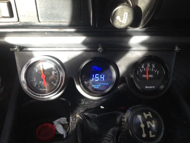

I got my gauges in place, most notably the fuel temperature gauge. At operating temperature, the fuel temperature is anywhere from 145F and 160F through the flat plate heat exchanger. That should be hot enough for the vegetable oil, right?
