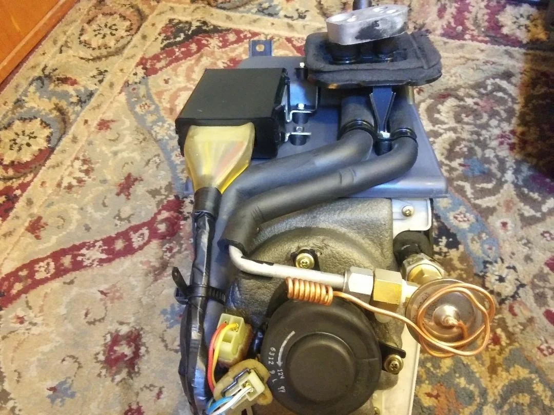

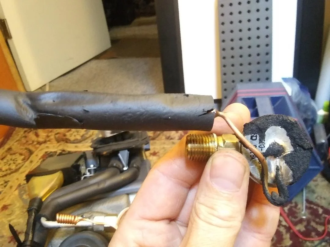

Hello. I'm hoping to find out whether the mounting position of your cool box TXV bulb ended up resulting in good cool box performance? I'm in the process of installing a Denso 475-0103 TXV in the cool box on my 1991 HDJ81. I'm a bit confused about the factory position of the original TXV bulb. The bulb was strapped to the high pressure inlet pipe of the evaporator. From all I can glean from my A/C research, a TXV bulb is supposed to make firm metal to metal contact with the OUTLET pipe of an evaporator. The factory bulb had an insulating sleeve on it that would prevent such contact. Just wondering how I should position the bulb of the new TXV, and whether I should put the insulating sleeve on the the new bulb. Any guidance would be much appreciated. I'll attach a couple pics.
Original TXV
New Txv installed with sensing bulb positioned where factory bulb was positioned

I had the same head-scratching concerns! I installed mine in the factory position, WITHOUT the weird insulating sleeve (but I did wrap everything back up together to insulate the assembly again), and it's been working great.

Thanks for the helpful guidance! Much appreciated. I'll follow your lead. Just to clarify, you wrapped the new neoprene around the bulb and pipe, encasing them together in neoprene?
Yes, exactly.
