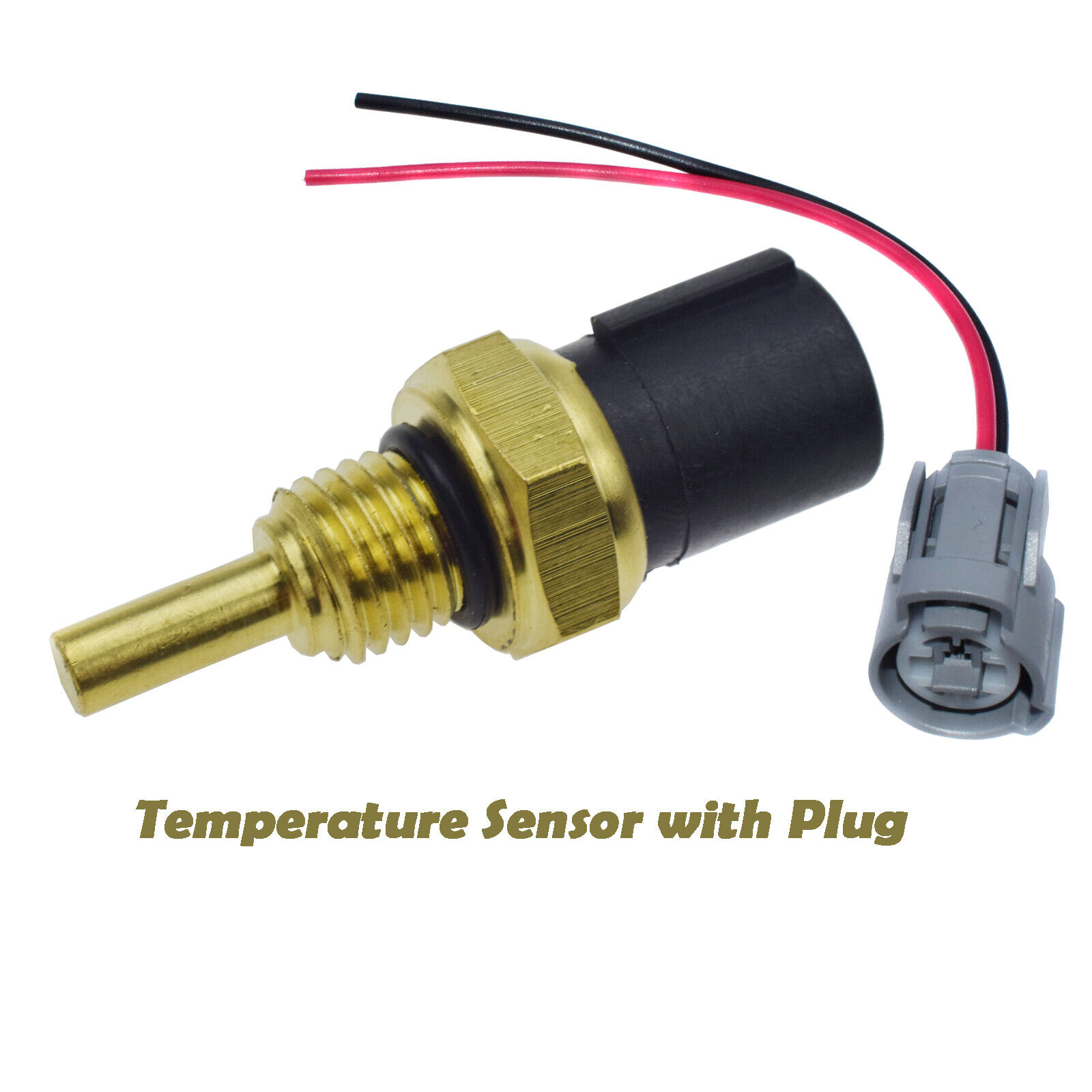

Doing my headgasket and i've crumbled almost every connector i've removed and have repinned them all except this water temp AC switch.
Trying to source 90980–10184 does not seem possible. Is there another switch that comes with a pigtail to solder instead?
The problem is that it can't be a fan switch for normal electric fan radiators because of the temp where the switching happens.
Need to find a 230F temp switch

the engine harness side connector, 90980-10157, is NLA. It was used on every Toyota in the 90's and some in the early 2000s. Your best bet is to scour salvage yards and cut one off a harness.
This really sucks, because the sensor is readily available from mutliple sources.

Here's a Different Gage but IDK if the threads are the same, FWIW
