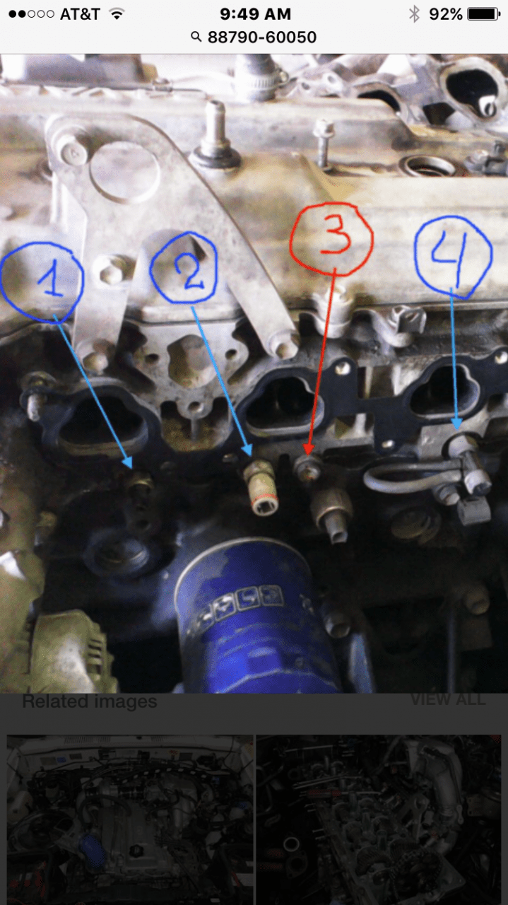

I'm looking for the name and part number of the sensor in the middle of the picture. It's the sensor/switch that turns your AC off when the engine is overheating. I've read every thread about the sensor and it's function and how to test it, but can't figure out how to buy one.
I've been looking for two weeks and cannot seem to find an actual name or part number for it!
Anyone?

Here's a reference from a Russian site with a part number; can anyone confirm this? Image search does not show the sensor I'm looking for.
That looks like I think the coolant temp sensor on driver side head of North American 1fzfe above oil filter
See edit above: I misread the original question, the part number I posted is for the pressure switch located on the AC line up near the (left side) battery on a US spec FZJ80.
New info. Have not found a Toyota part number that matches up with a picture, but here are some aftermarket part numbers and photos. The aftermarket makers are calling it an A/C Switch, Radiator Fan Switch, cooling fan switch, etc. First photo is of the switch on my motor.
88790-60050 is the cross reference suggested, but Toyota parts sites have differing part descriptions and photos.
In some places it's a thermo switch assembly, in some places a Valve Assembly Magnet.
Why not just pull it and read your number
Uhh, wrong sensor. There are 3 or four of them there. I'm confident in the sensor I'm asking about. It's the one that allows the a/c compressor to kick on when you unplug it, even if the engine temp is 239 as read by the computer.
It would be nice to have the new one on hand and just replace it at the same time. At 172k miles who knows if the number on the old sensor will be readable.
The part number is 8879060050

Plug this number 88790-60050 into google image search and see if it looks like yours.
The one I ended up using was an aftermarket part from a US source but was stamped 'made in Italy' on the actual sensor.
That is the PN.

I'm about to pull this sensor (I've seen it called "Engine coolant temp relay," "Water temp SW for AC," and some other things, but it's the relay that has caused my AC not to work). I've pulled off the electrical connector, and the AC now works, so the sensor is my issue (I'm quite sure the engine isn't actually overheating). The sensor is covered in oil from before the head seal was replaced, and there is oil inside the connection. I'll clean it up, do the hot oil test on the sensor, and see if it works. When I pull it, will coolant leak/gush out? Have others drained the coolant to below that level, or jammed a rubber plug in the hole while the work has been done? Is there another trick to this?
It will drain some coolant, but not much. Maybe enough to drip on the ground. It will not gush out. I changed both of those sensors along there at once and I think I lost maybe 6-8 oz of fluid.
