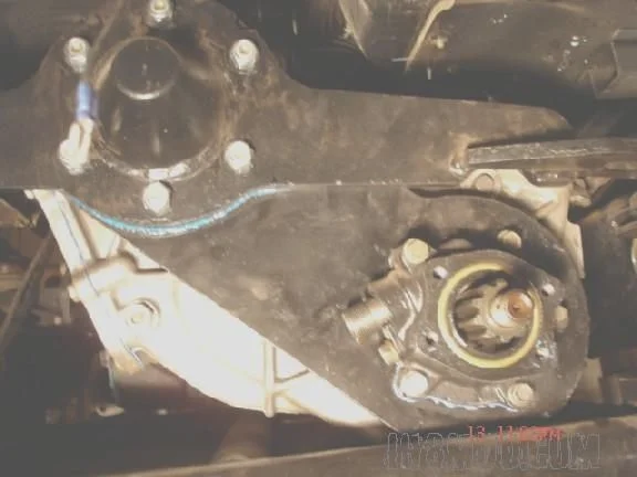

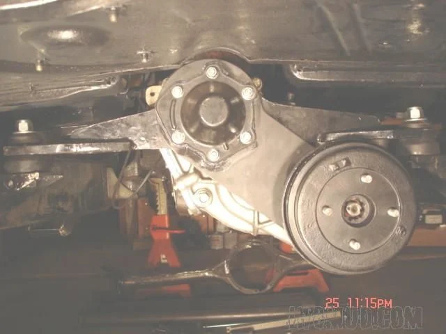

here's some pix I have saved over time. I'm interested in one.

any issues with the speedo gear housing being spaced out? that's where the shims are for the shafts.
Nope. A supplied 3/8" thick spacer keeps your preload set w/ your shims. Maybe John can get us a pic of a complete unassembled kit (?)
