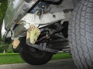

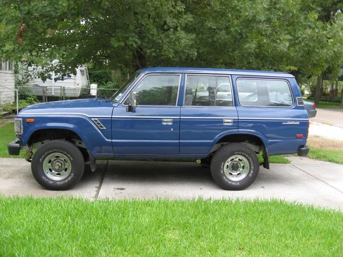

Here are before and after pics
Sweet Aaron,
The pics look great. Do you happen to know how tall it is from the top of the roof to the floor? I don't think it's going to fit in my garage after this.
Gallo Pinto, thanks for the pics. Looks like they have settled a little bit which looks good. I have been looking around and comparing prices to OME and just haven't made a decision yet...we'll see what happens.
Sweet Aaron,
Measured it today. Probably need 75 inches minimum to clear. Good luck.
