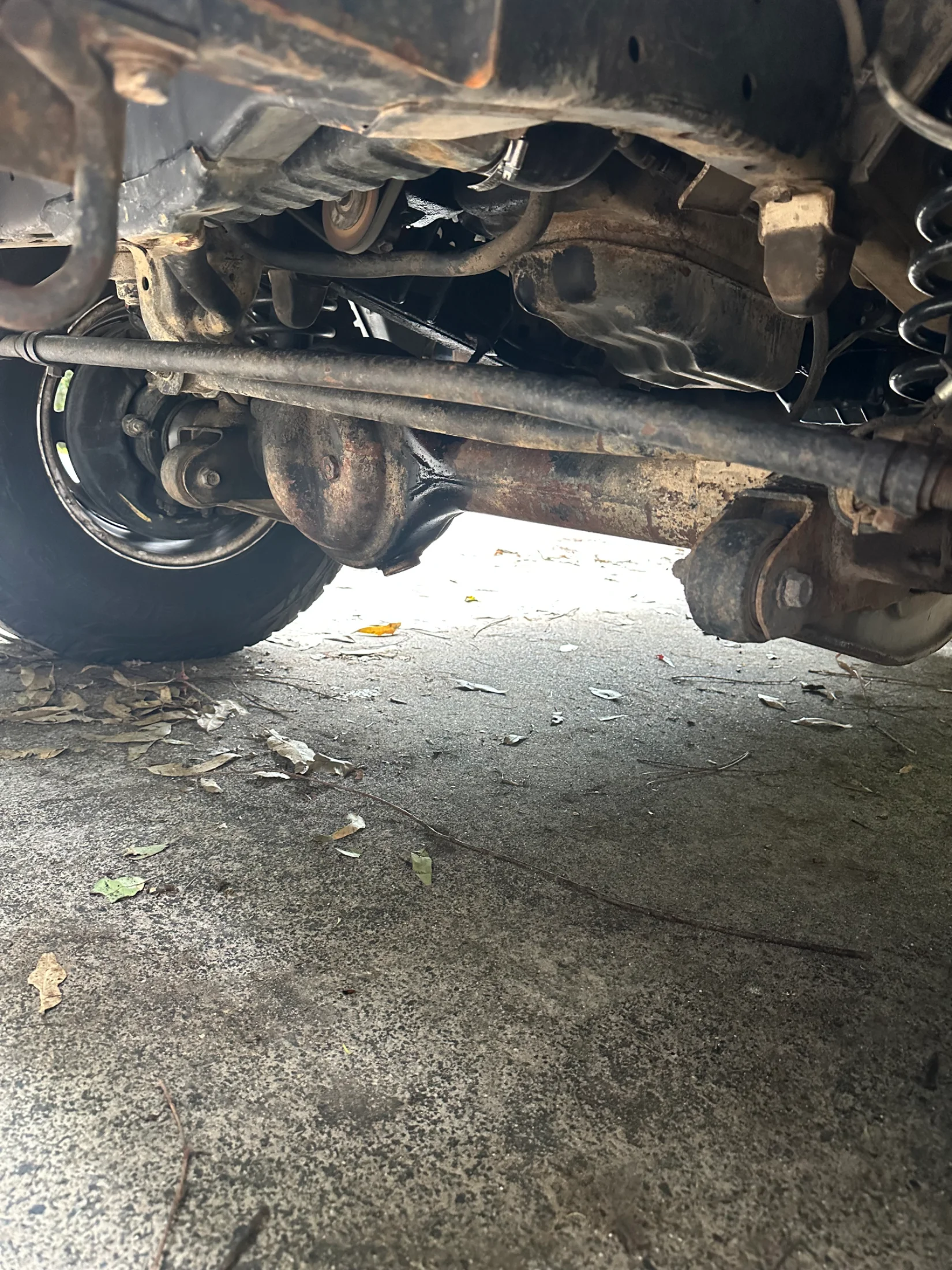

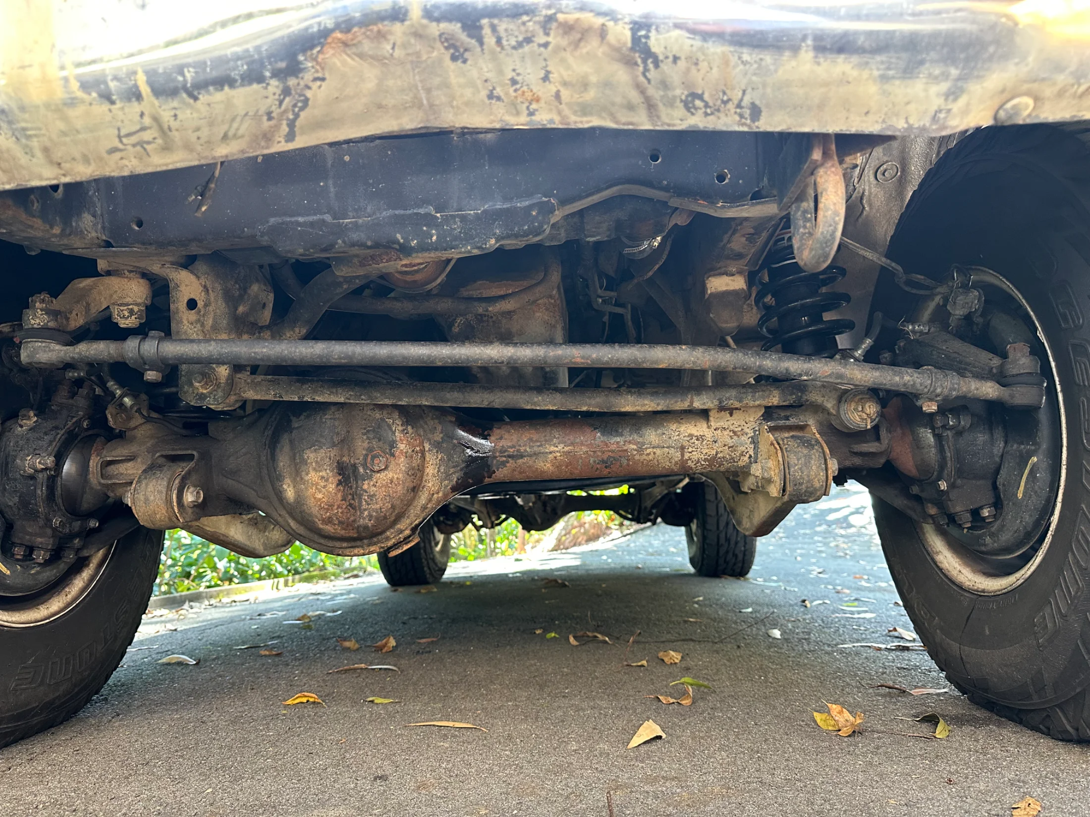

Hey guys,
I was told while getting a RWC (Roadworthy Check) done that my panhard rod is bent, however I honestly thought it looked quite normal.
However, I did experience some form of death wobbles if I hit rough roads / aggressive potholes which stops if I slow down. (Which the panhard rod could explain).
Would love some advice / happy to move to an adjustable as have recently added a 3” lift so it probably needs one. Do we think RTC Dampeners are worthwhile as I could easily add one at the same time.
Please let me know your thoughts & recommendations.
Kind regards,
Reedys
Panhard rod looks bent and the track rod (aka tie rod) is badly bent. Must drive like 💩
EDIT - it's the drag link (aka relay rod), my bad.
Hello,
It is bent. An offroad hit, perhaps.
Juan
both the panhard and the draglink/relay rod look bent
Thank you all very much, not sure what happened with it, as I've just recently picked it up. Could the recent lift have anything to do with it, or this would purely be from an off road hit of some kind?
I'll go ahead and replace these, any product recommendations or anything goes?
Thanks again.
Maybe it caught something like a tree stump and levered the drag link against the Panhard rod, bending the latter downward.
I guess you mean did the recent lift cause it - no, it will just pull the axle slightly to one side due to lifting the Panhard rod, and have no effect on the drag link.
Whatever you do, that will need an alignment job.
No worries, thanks for the help. 👍
Will get onto this asap.

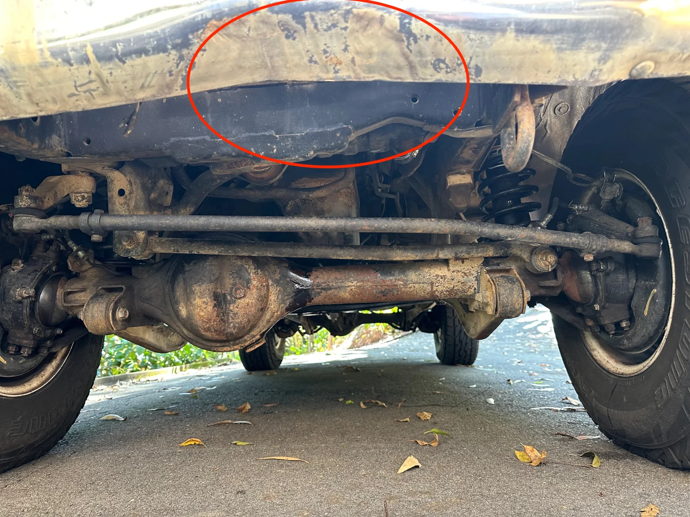

If I had to guess this might be related:

To be clear what can be seen in the picture is the drag link and panhard bar.
IMO the they are both bent.
Behind the axle is the tie rod/relay rod, it can’t be seen in the picture so no way to know if it’s bent.
If it is that would change the toe and effect how the truck drives.
All 4 tie rod & drag link end should be changed at the same time.
And if your having death wobble you should be looking at all the bushings in the front end.
You should also take a close look a the frame mount of the panhard bar for cracks.
