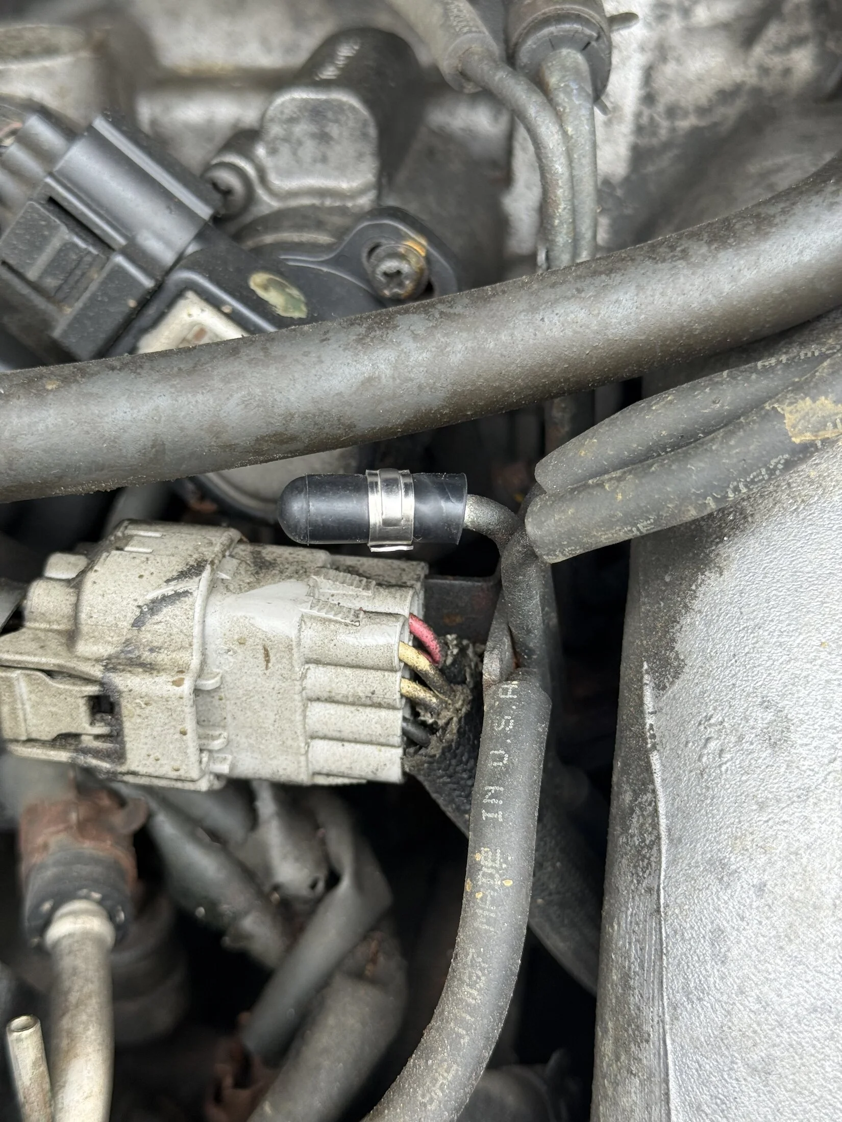

Ok time to revive this thread, I recently removed my PAIR what did you guys do with the small vacuum line that heads infront the motor to the top? Cap it? Leave it? Thank you for any info
Removed it, capped it at the intake. the metal line is still there, but nothing is attached to it.
cap it back at the intake and remove the hard line. or you can leave the hard line in place and cap that instead of back at the intake

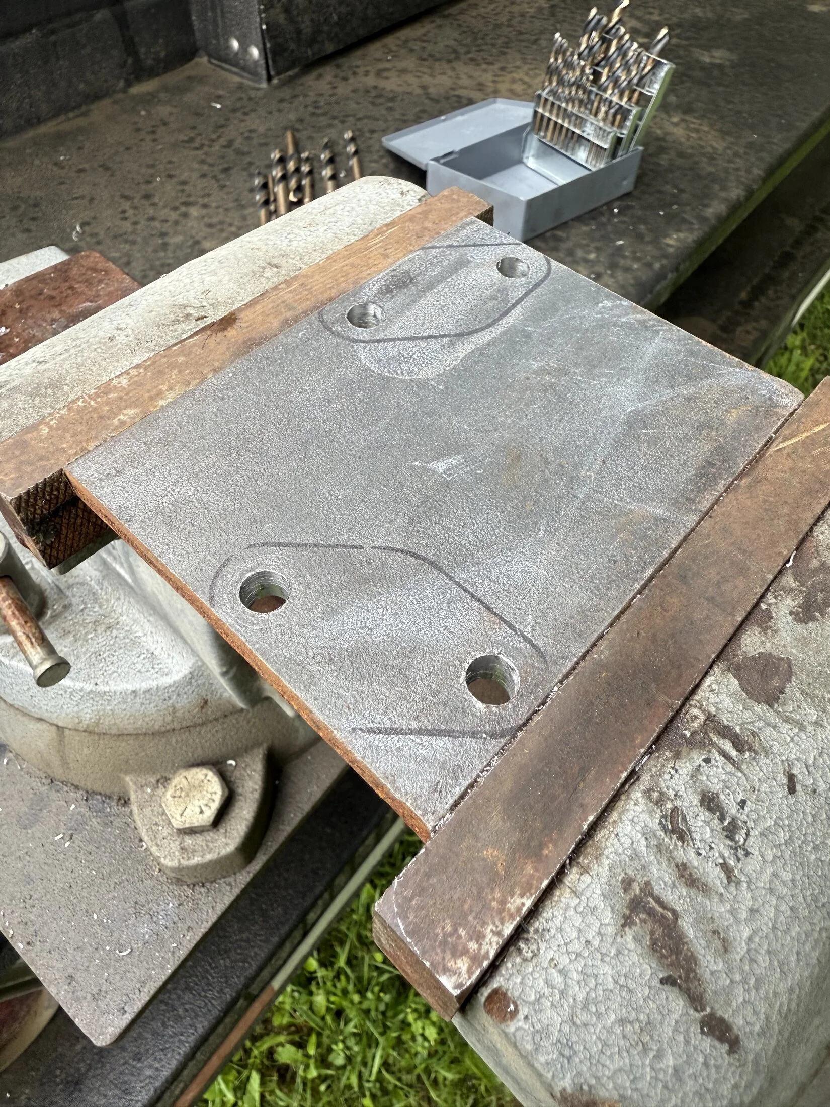

Get ready for some world class high end fabrication folks!
Made my own block off plates from 3/8 plate I had kicking around.

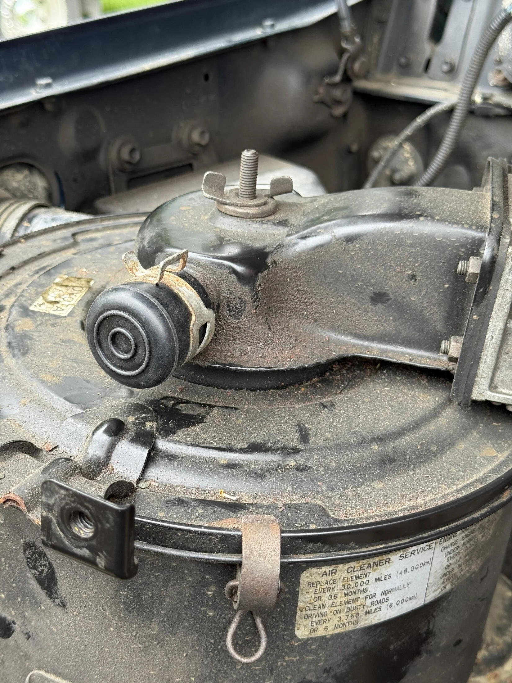

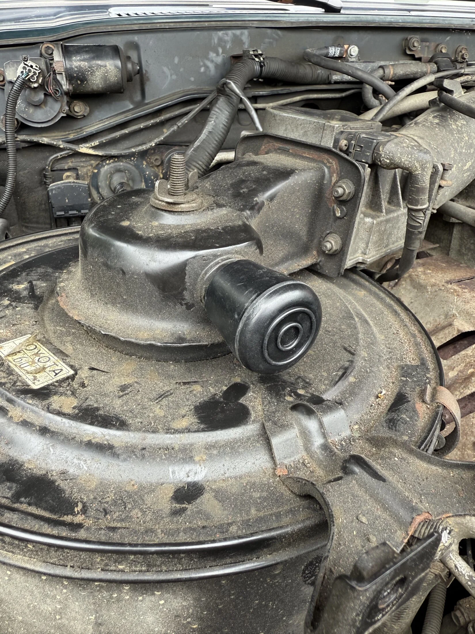

Vacuum line capped off at the intake manifold end and some more world class fab work for the throttle cable bracket (I bent the factory bracket in a vise)
Red hydraulic cap on intake elbow is temporary until I find an 1-1/8" rubber cap at Home Depot that'll fit over
