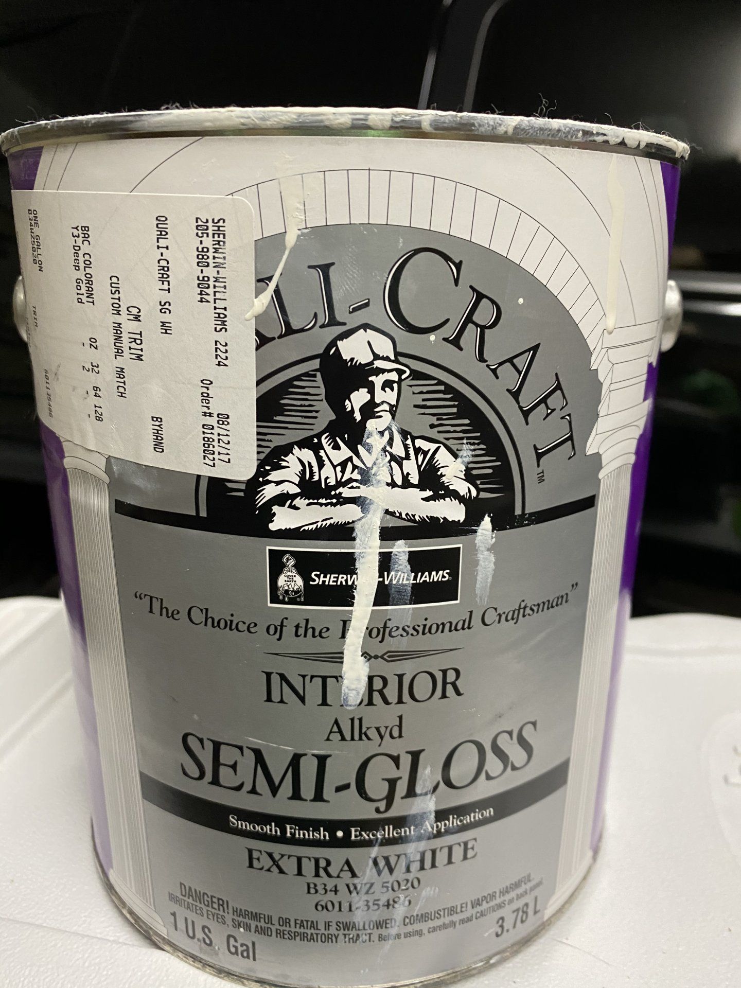

This paint from my parents home I tried stayed on decent in some places, and not in others. I didn’t even bother trying to clean the brush. It’s an alkyd paint. It self leveled which was nice but the local Sherman Williams said it will yellow very fast in our climate with the moisture. I feel I know more about paint now than the guys working there.

So far the best has been the alkyd paint but I was told that it will yellow sooner in our humidity and it didn’t stick in every situation. It isn’t as white as the others and cleaning brushes suck after it.
