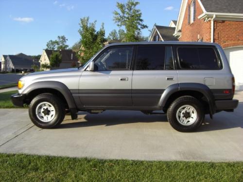

I'm assuming the paint scheme below is the one you have? Is only the silver section in need of paint? This is sort of a broad question, but what "quality" of paint are expecting?

Yes, that's what's she's supposed to look like!! One mine, the lower (darker) color is acceptable to me (a few scratches but not too bad for a 26 year old vehicle) but the top silver paint has nearly disappeared in places. I'm looking for about a 10 footer paint job.
