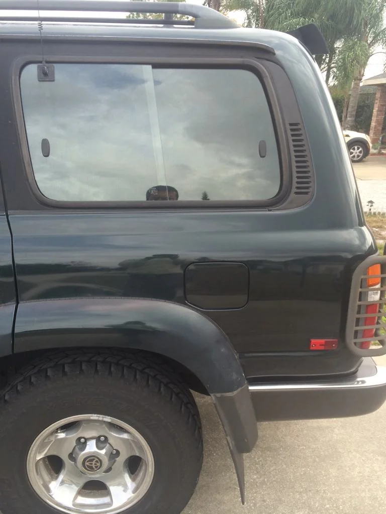

The above picture is the driver side rear quarter panel. I am keeping the fender flares. I'm assuming a body shop can repair and attach back. Since I want to keep (what some consider tacky) fender flares, I know I'll need the plastic clips from toyota that secures them. Is there also a weather seal i need to get as well?

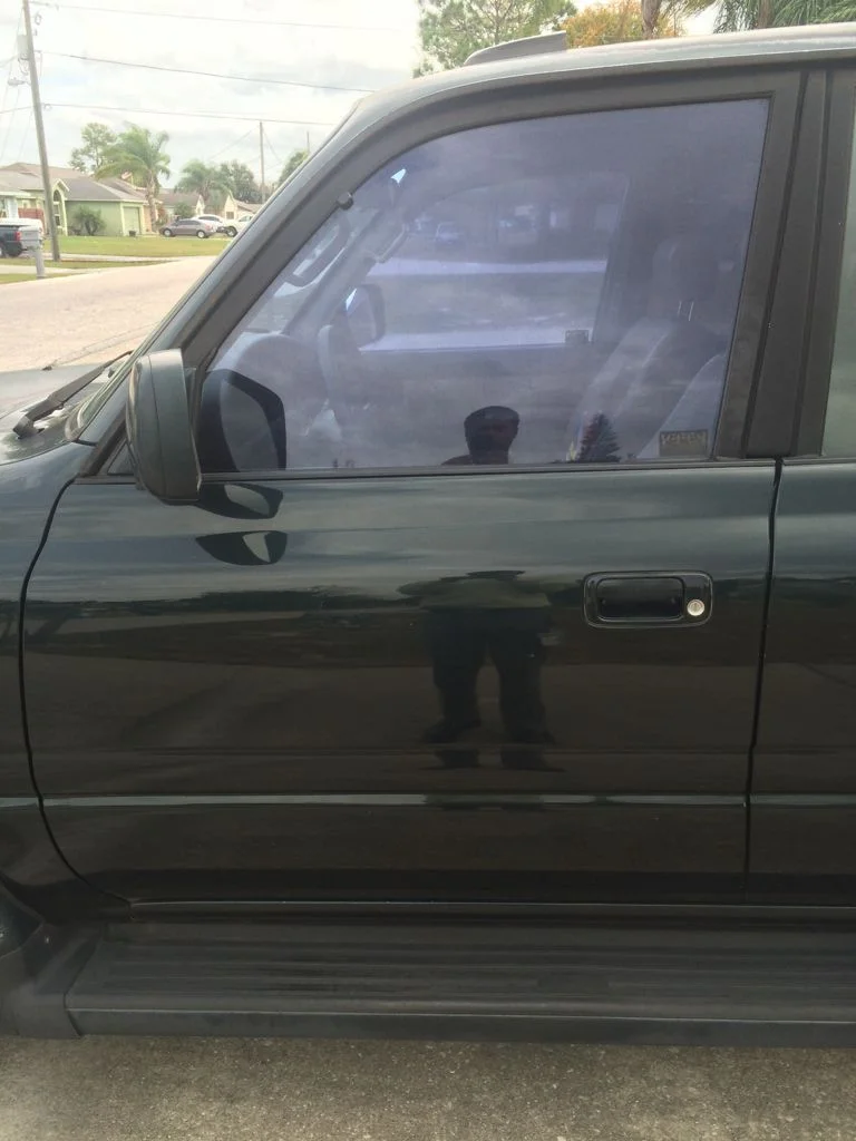

The above picture is the driver side passenger door. I am keeping the fender flares. I'm assuming a body shop can repair and attach back. I did notice the door handle. I would like to know if it's easy to remove the door handle and have them painted off the truck and if I need some rubber gasket when I remount. My other issue is should I worry about pulling / replacing the door window black gasket.

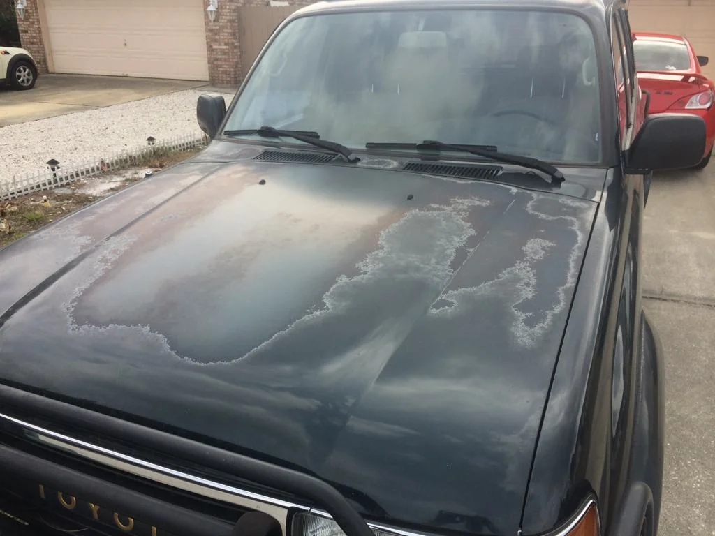

Obviously the worst is my hood where the clear coat is off and the hood is exposed. I want to have the section where the windshield wiper arms are removed and painted off the truck just like the door handles and rear view mirrors. Can the wiper arms be repainted as mine has some surface rust? Also, is it best to pull the rubber surround moulding around the windshield and we can reuse it ? Or is it better to buy new and apply?

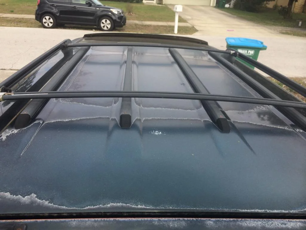

The roof. I would like to keep this truck as stock as possible. Can any of this stuff be reused or should I source some new stuff to mount. Now if some members can show me some good alternatives like jdm style racks or safari style (in time I would like to add the sleeper tent / water / extended camping equipment up here)

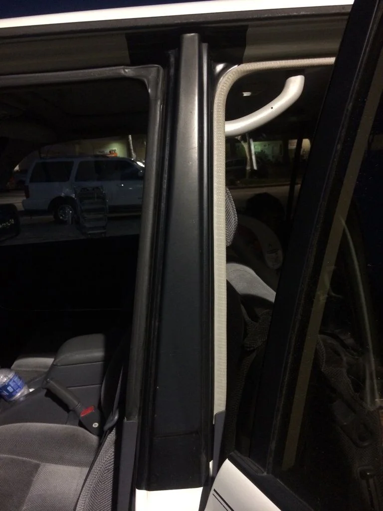

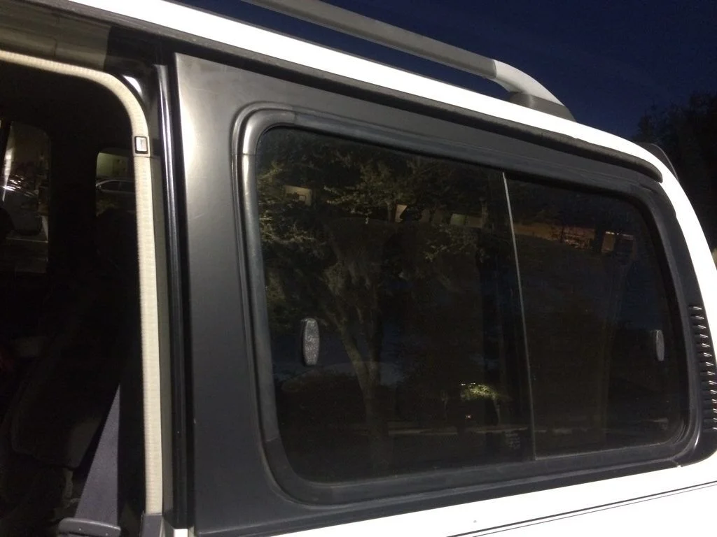

Hey folks can someone please let me know the correct paint code for this black paint found in between the doors and surrounds the rear sliding glass
Is this just flat black ? Is it applied after you paint or before??

There is no code. It is a generic satin blackout. Any body shop should be able to duplicate it.
