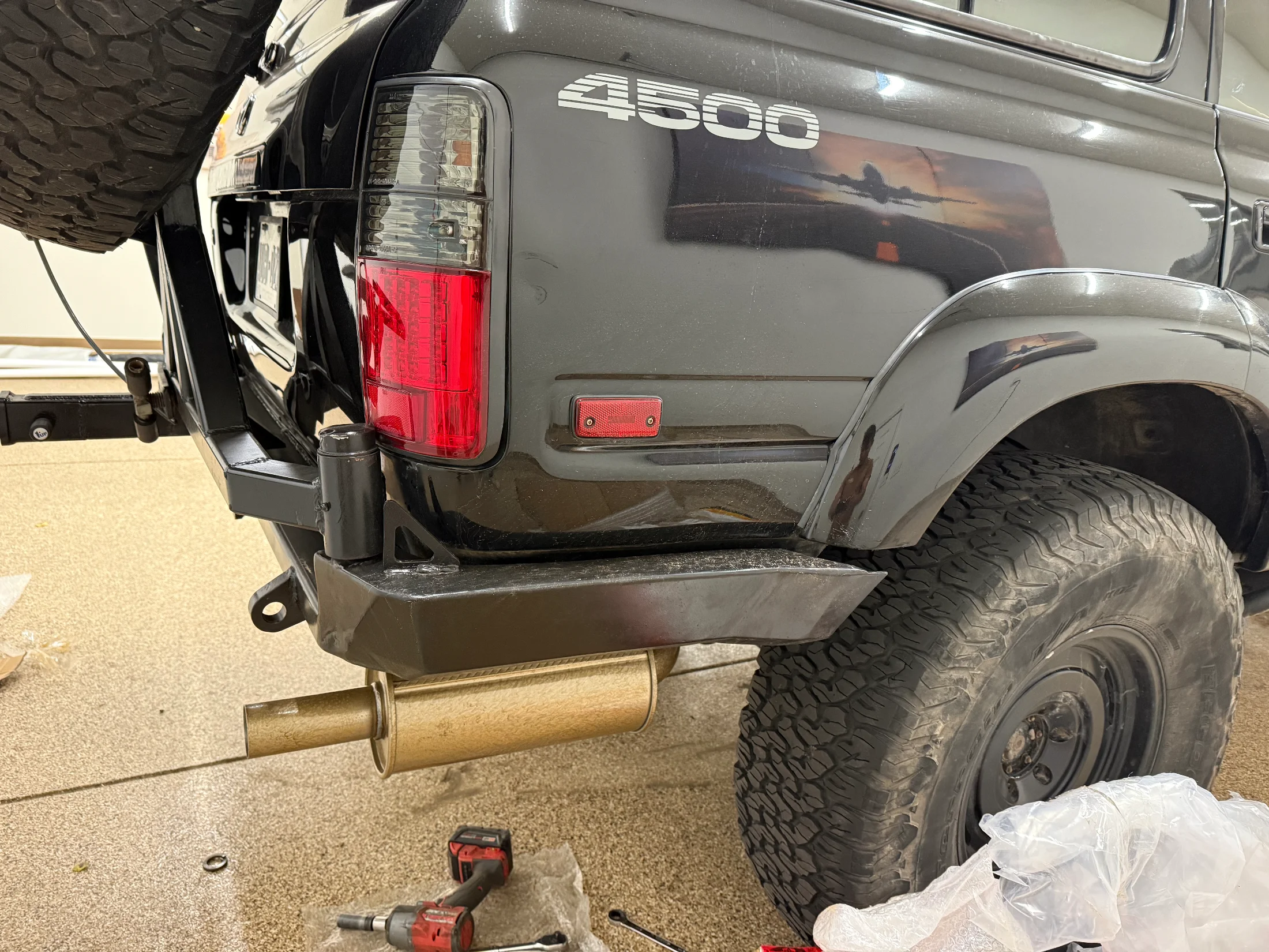

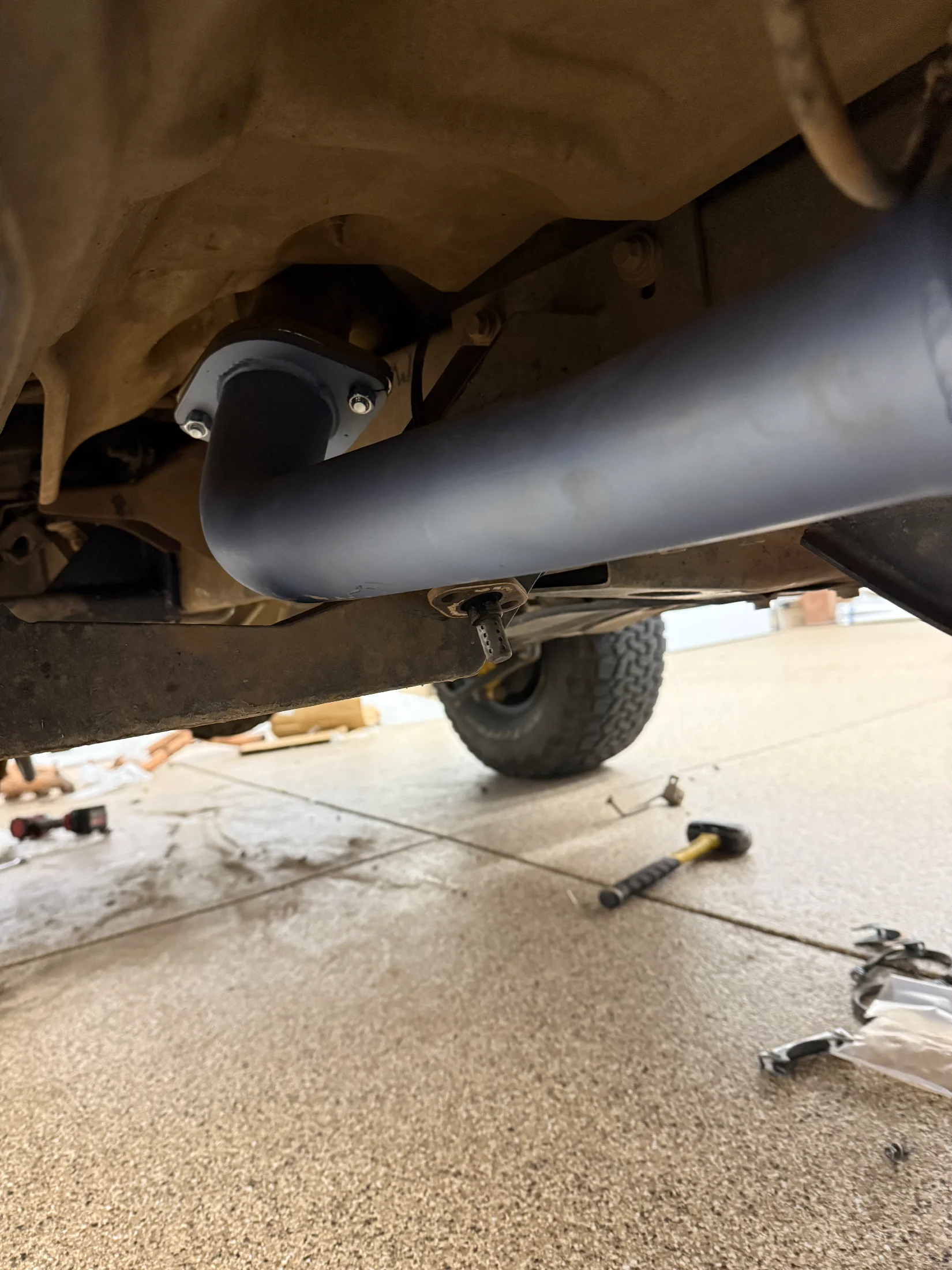

I have the same exhaust, didn't read anything about it being the 105 to get it over the frame rail.
Ordered it from here: LandCruiser 80 Series 4.5L1989–1997 | Pacemaker & King Brown Exhaust - https://bestmufflers.com/bshop/toyota/7932-toyota-landcruiser-80-series-fzj80r-45l-1fz-fe-19891997-pacemaker-headers-king-brown-exhaust-system-kb12015-hxmr.html
any noticeable change.
Not sure yet. The shocks are getting rebuilt at Icon, hence why you see it rocking all over the place in the video.
The sound is subdued while giving it a bit more character. I preferred the way it sounded before I put the muffler on but my wife has to potentially drive it too.
Well, the butt-dyno tells me it’s a little peppier. It might also have something to do with the cruiser going on a diet. Removed the spare tire carrier, the Jerry can holder, the ABS pump, LPSV,
