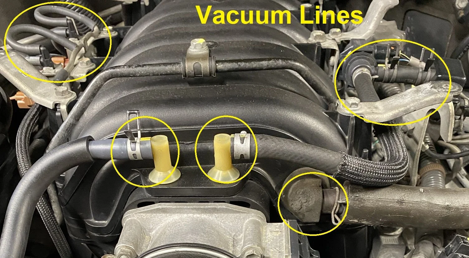

Make sure all vacuum lines are connected and sung, Including those to A.I. VSVs on RH side of intake manifold and two on power steering pump idle up control up to intake manifold and air pipe. Also check ECT (engine coolant temp) is ~187F.
Make sure no air leak at either end of tube connecting exhaust manifold to #2 A.I. switch bk1 and bk2, particularly bk1

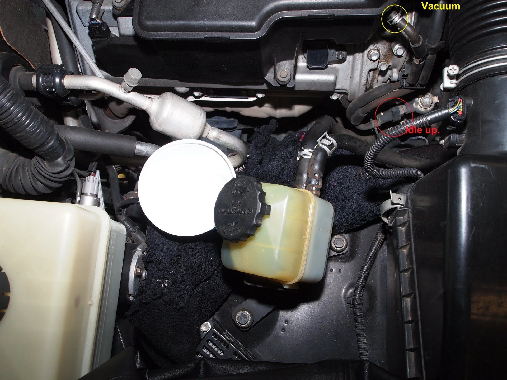

Vacuum lines. Idle up

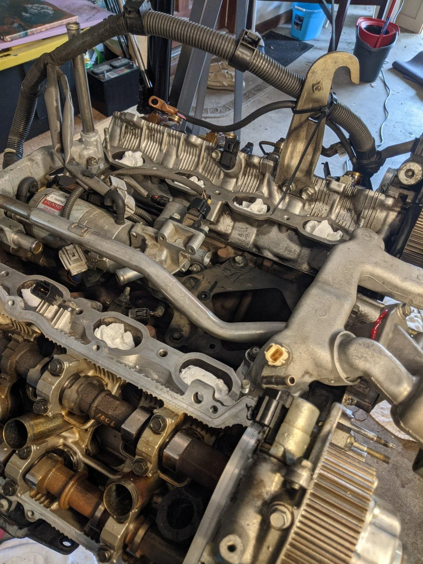

I'm installing mine tomorrow and I was going to remove everything. WAS..

The VVT engine has one place that with age, we get a vacuum leak other than obvious vacuum lines. It's the intake manifold (IM) gaskets. With these I look for gunk build up on IM tubes coming up from heads. Oil from PCV will seep out during cool down and capillarity action draw up the outside IM tubes.

I was maybe going to leave the pump and valve removed from under the manifold and leave the pressure sensor in place.
But since your thread I'm thinking I clean it all back up and put it back with all three plugged in- just in case.
I guess there really isn't a need to remove the two removeable items altogether.
