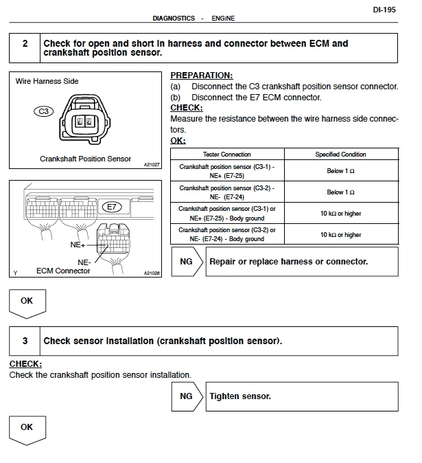

Do you have the repair manual? Ive cut & pasted some pages starting at DI-191 referencing P0335. This is from 2004 repair manual- this might help get you most of the way there. If you have tech stream you can pull the freeze frame data to see where & when the DTC triggered and anything else that is going on.

Thank you very much for the helpful info. The FSM is the same for 2007 so this should be the right protocol. I will go through this with my mechanic and let you guys know how it turns out. Hopefully this doesnt turn into some electrical grimlin.

the book is good and should be the order you go in. sensor, wiring at ecu, crank wheel teeth. In order of difficulty.
I do not know if you can get a straw in there and spray the teeth off, I'd try i though. Going 2400 miles with a code seems like it might rule out wiring at the ecu. Unsure.
That wiring does run up the front of the engine though, routing on it is pretty important.
