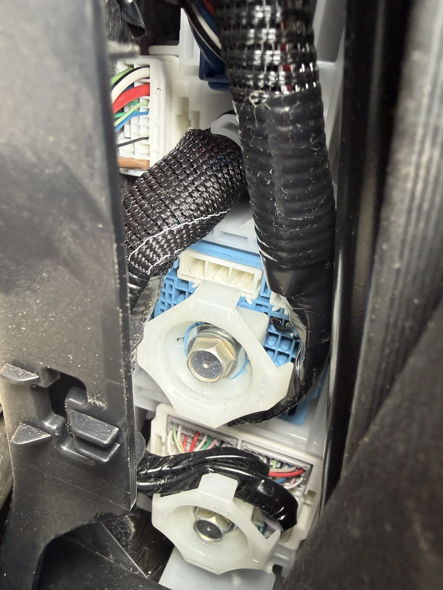

Have you pulled the door sill trim yet to look for evidence of water in the rocker panels? Very common issue and very easy to inspect. I can dig up a how-to video if you need.
Edit:
Confirmed- I’ve pulled sill trim on both sides and no evidence of moisture on either side.
That’s a relief, but now you need to find someone with the skill and patience to diagnose this properly. I’d start looking for competent Toyota independent shops, personally.
