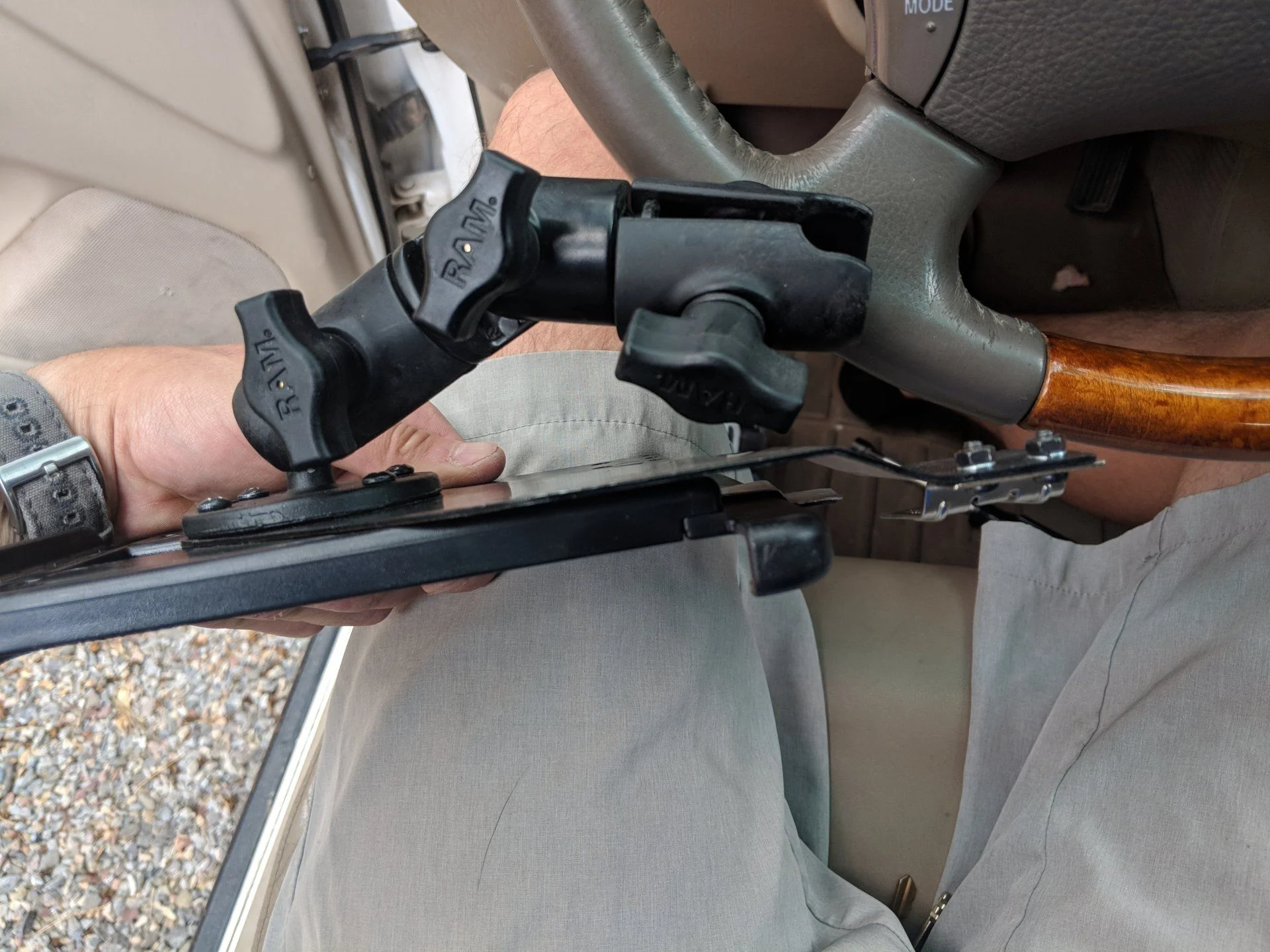

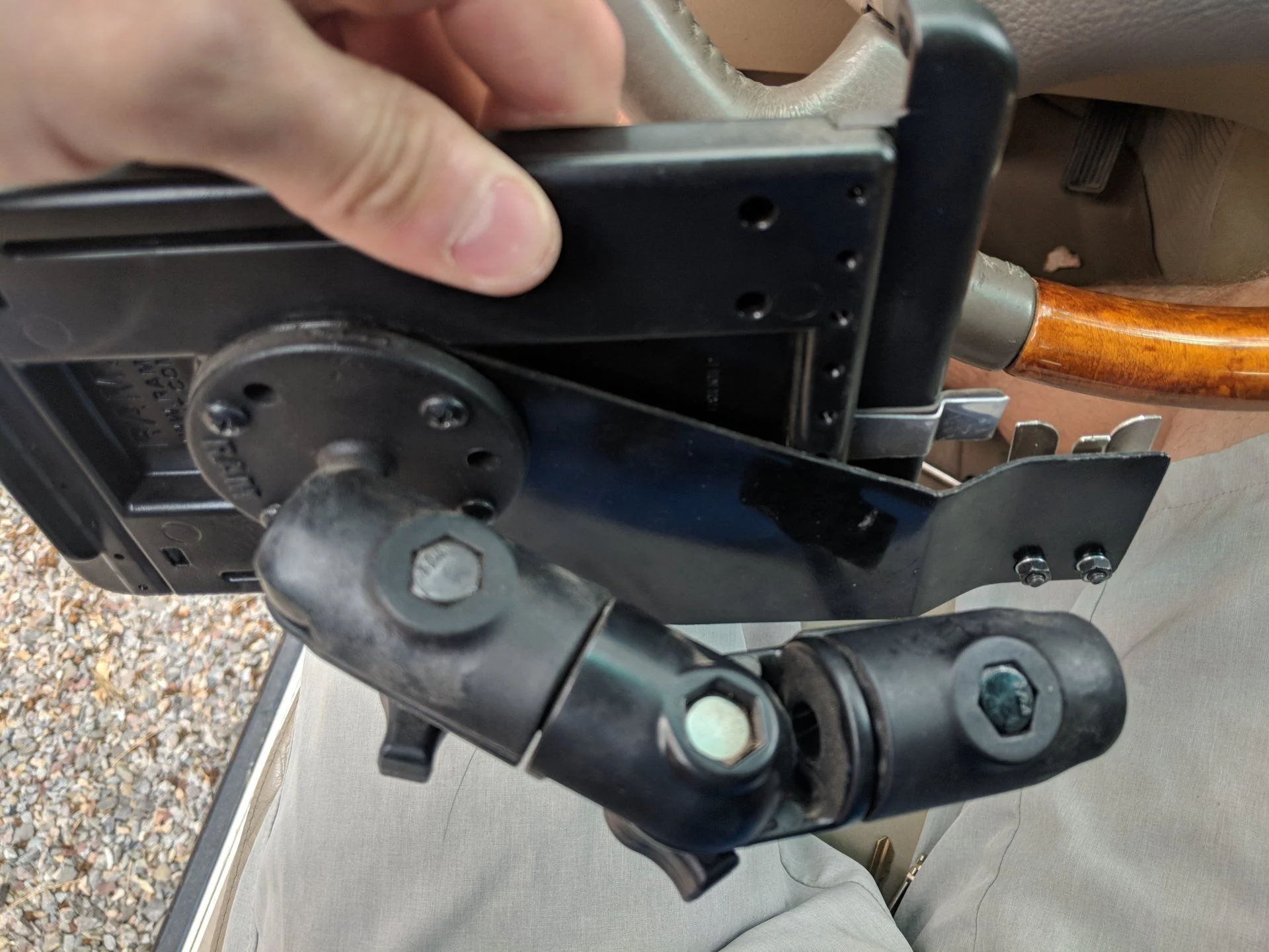

Look great! When you day second released model, do you mean you ordered just this past weekend?
If so, can you post a photo of the ram balls on the mount?
Thanks!
Not the most recent batch but the one previous. I this is the one that wasn’t a full plate but had a cut out and a foam piece was added.
Nice @socalmtbiker Also part # the upper/lower ball. Looking to do the same with ham mount/ipad mount.
I bought the ball that was listed then this
https://www.amazon.com/gp/aw/d/B0059X0YIQ?tag=ihco-20
Just a 1” male and female ball
ahh I see. I forgot about people wanting double balls. I'm not certain that will work with the newest version because the lower side is much closer to the tape deck than it was previously. I may have another RAM ball laying around to try though.

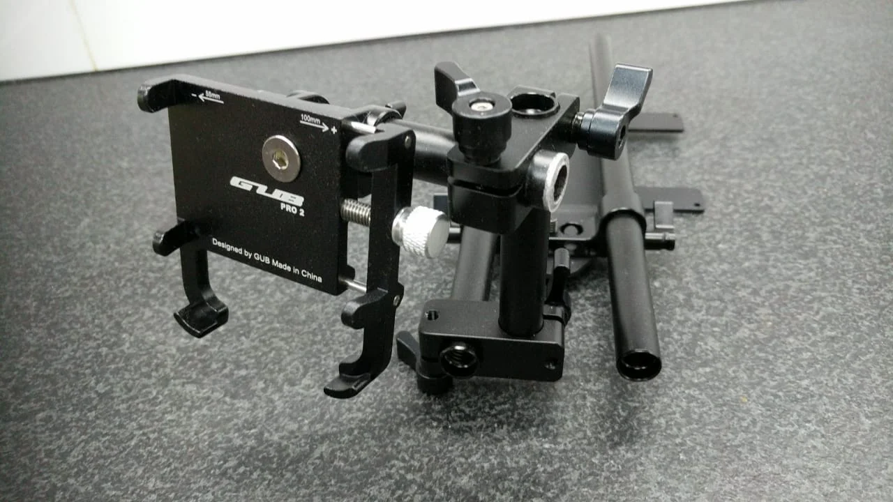

I looked and looked at the RAM mounts and I just didn't care for it. Not sure precisely why. Maybe it is that I am going to use both an 8" tablet and a large phone with my 2001 LX470 with Nav. The RAM system just looked kind of sloppy to me, and expensive too. So, of course, I ended up spending more on the mounting system I settled on, which is based on Smallrig's 15mm camera accessory mounting tubes and joints plus a couple of GUB phone/tablet mounts. Everything is aluminum or stainless and it looks quite nice, I think. And all items are available on Amazon. Here are a few photos:
full
full
full
full

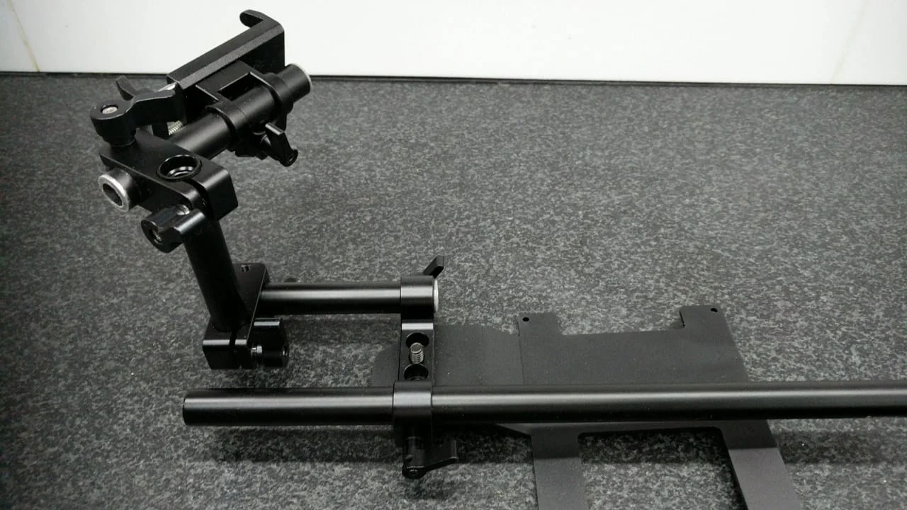

Here are the parts that went into what you see here. I bought four 12" Smallrig 15mm rods and am cutting them up with a pipecutter--the 12" rods are inexpensive.
full

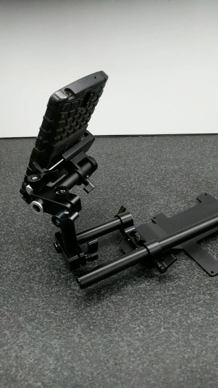

What's neat about this is that you can, by selecting rod lengths and angles, put the phone in just about any position or angle and lock it there.
Unfortunately, my truck is in the shop so I can't figure final sizes or distances, but I'm looking forward to doing that.
Once again, thanks for making the media mount plate!
