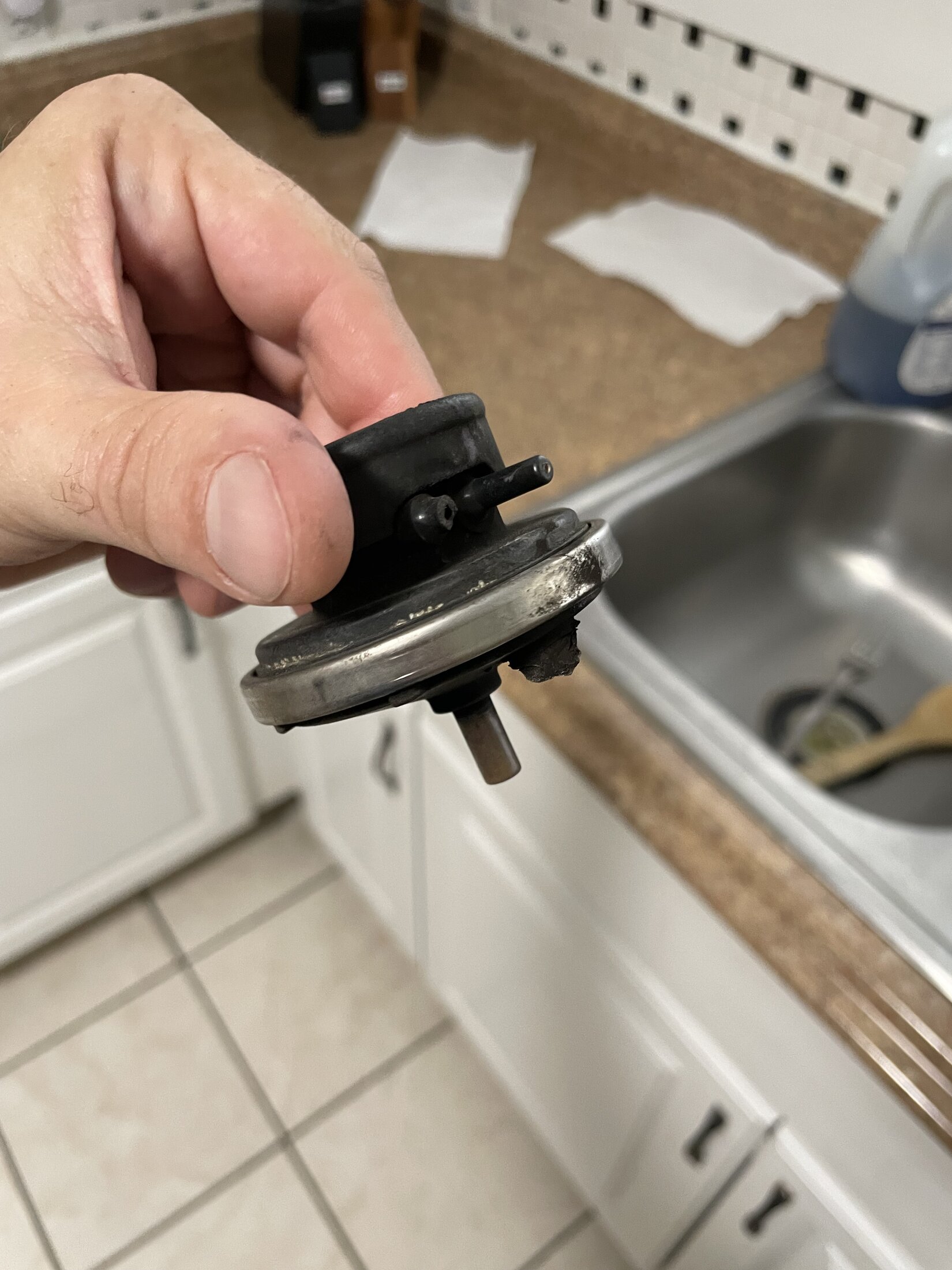

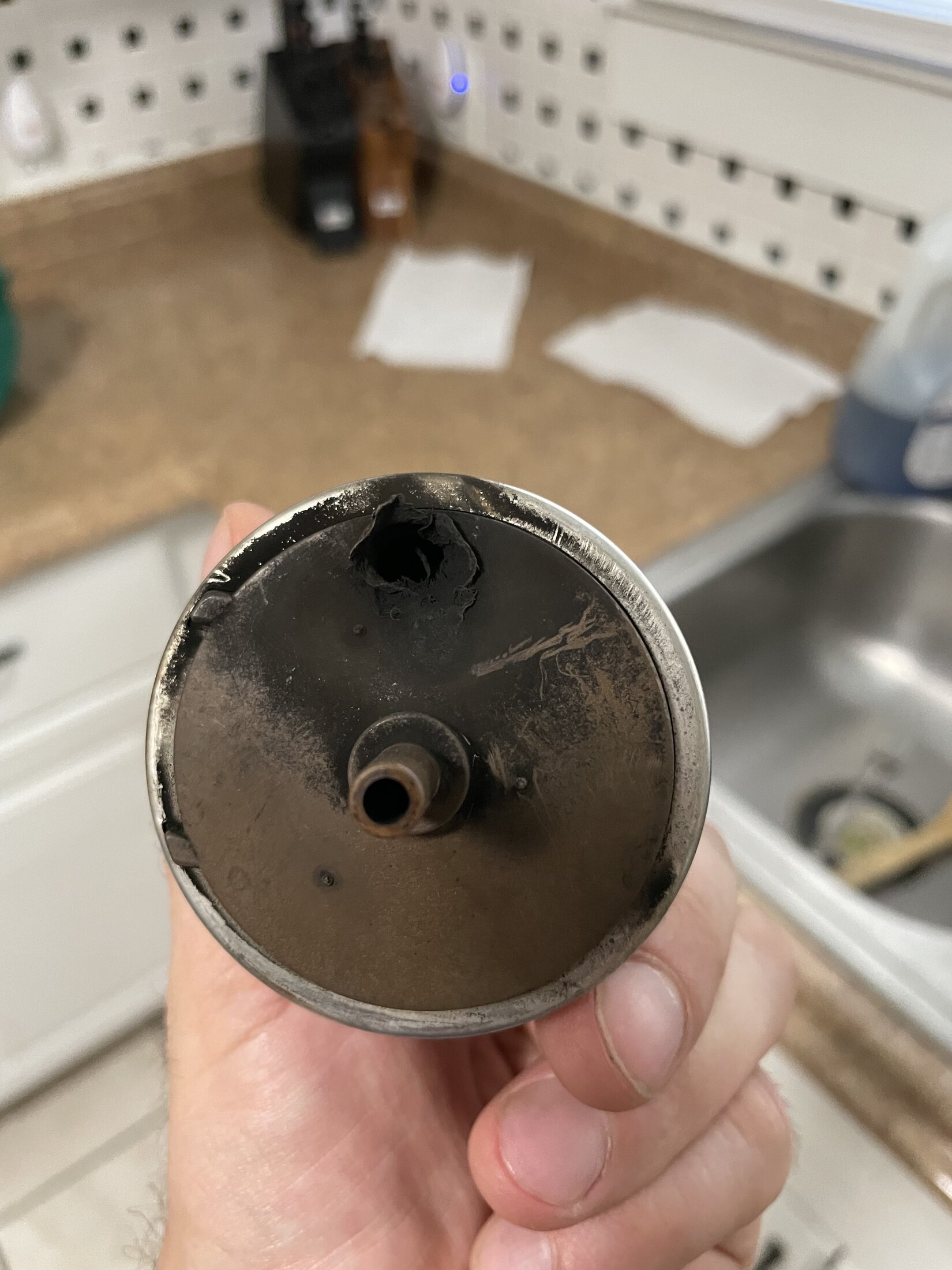

Update - And new OEM fan clutch did not fix the issue. Double whammy 😕. I found this:
Bottom hose was blown off from both ends, hole burned through it and then one of the barbs broke as I disconnected it. Not sure if related to the overheat/power loss issue.
Anyone have the correct part number for this Exhaust Gas Recirculation (EGR) Vacuum Modulator? I seem to be getting different numbers compared to what's on the original unit.
View attachment 3729388View attachment 3729389

The EGR valve may be a symptom of the issue or it maybe unrelated. A part of me suspects that a partially clogged cat might be the root cause; not allowing the engine to exhale the hot exhaust gasses at high RPM could lead to both overheating and what feels like slight powerless.
Sort of a side note, anyone know off hand if the EGR system can simply be deleted on an OBD2 truck same as an OBD1 truck (without a CEL)?

Update: Some closure for those who contributed and those who may read this thread when trying to diagnose a similar issue in the future.
To recap, the cruiser experience a drop in power, would overheat at higher RPM (roughly 3,000+ RPM) and the EGR valve hose blew off completely along with melting the EGR valve modulator. As stated earlier, a new OEM fan clutch did not fix the issue; neither did a new OEM thermostat. After scouring MUD, I came across 3 or 4 cruiser owners who experience a similar melted EGR failure and a drop in power; all of these owners confirmed that the issue turned out to be a clogged/bad/melted cat (catalytic converter - keyword for future searches). At this point, I'll also add that I have an under 10 minute commute to work and the engine eats a bit of oil, so it probably had little opportunity to regularly heat the cat properly for several years.
After addressing the upstream cat (which appeared to have at least 2 to 3 square inches of the honeycomb blocked) and EGR system, power came back to normal and the latest drive, consisting of at least an hour of slow street driving followed by approx 15 minutes of highway speed driving showed 192°f as the highest coolant temp (albeit, its only a cool 84°f - 78% humidity today). Haven't been able to drive much due to the hurricane that just passed but will continue to monitor coolant temp and update this thread if things change. The issue does appear resolved.
