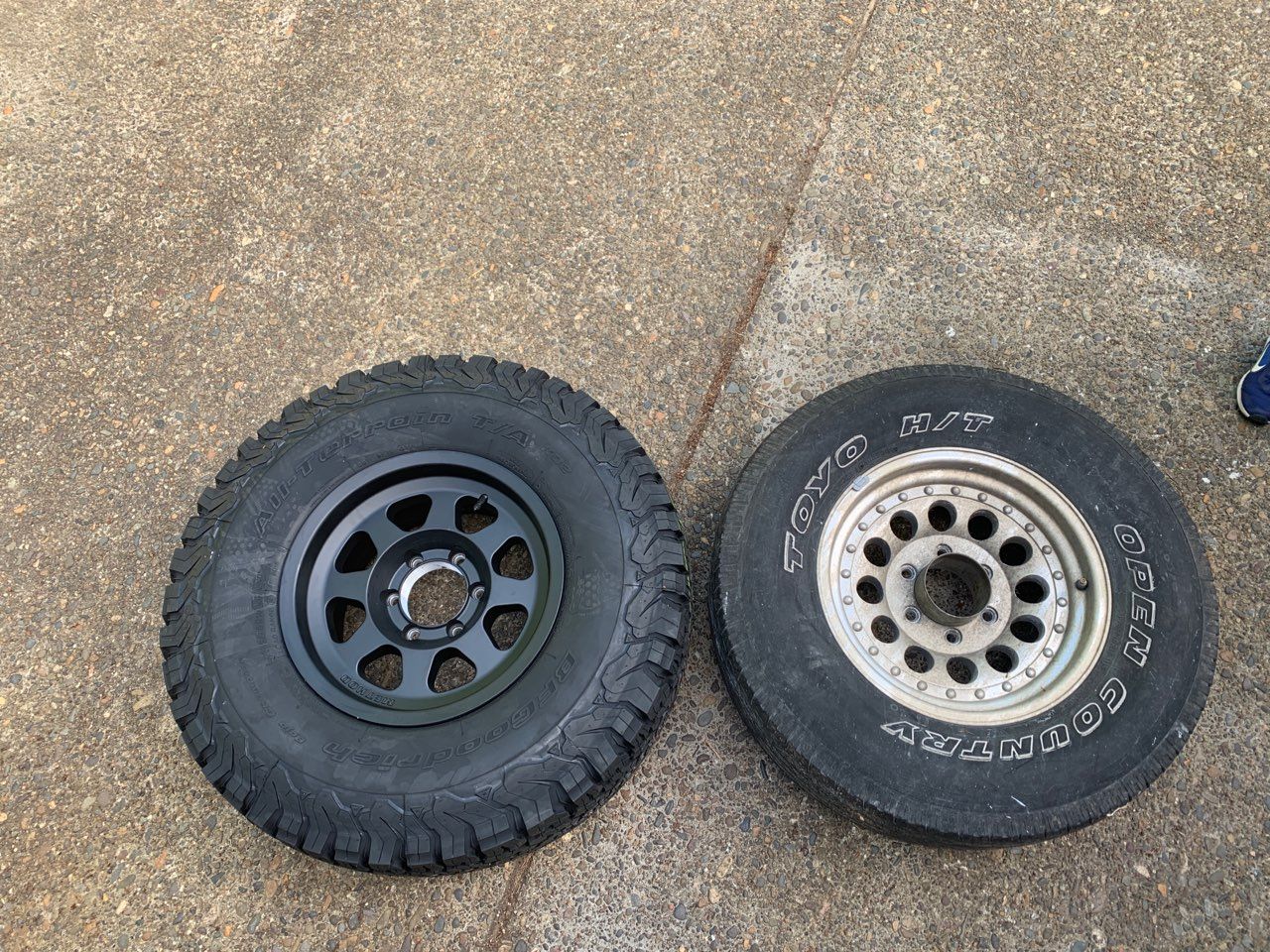

Love the set-up! I am getting ready to fit a set of Method 314's to my FJ60 in the next few weeks. Do you have any images of how you fit the center caps? I have a set that I'd love to use on mine. Also you mentioned opening the bore to 106 did that work? I have read that the hub bore needs to be 106.1? Would love to hear from you since you have done this. Thank youMethod 701s punched out to 106mm.
Thanks! I dont have pics of the center caps off but they arent modified much. If I recall I started bending the spokes/tynes that grip the inside of the rim until it was a tight fit. I thought about having a groove machined inside of the rim when it was center bored but they already do not come off easily. I didnt do the machining myself. I took them to a wheel specialty shop around portland and told them to punch it out to 106. I can only assume thats what they did. The 701 offset doesn't work with the 60 so I am running a 1 1/4" spydertrax adapter/spacer and havent placed the rim directly on the hub. However, they bored the rim and spacer while bolted together and it fits perfectly. I've had no issue with the setup.Love the set-up! I am getting ready to fit a set of Method 314's to my FJ60 in the next few weeks. Do you have any images of how you fit the center caps? I have a set that I'd love to use on mine. Also you mentioned opening the bore to 106 did that work? I have read that the hub bore needs to be 106.1? Would love to hear from you since you have done this. Thank you
